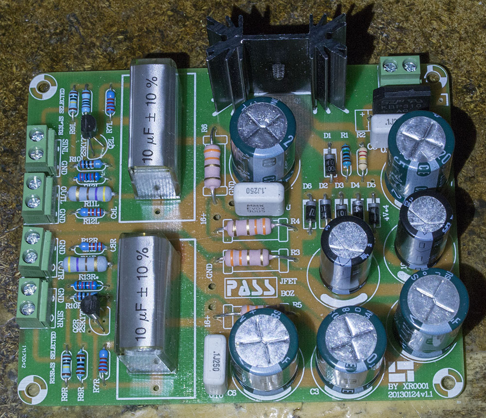

The version of the BOZ I have has a PSU onboard and just needs a single 18v AC rail.
It is labelled 'Pass JFET BOZ' near the centre and at the bottom corner 'by XR0001 2013 01 24 v1.1'

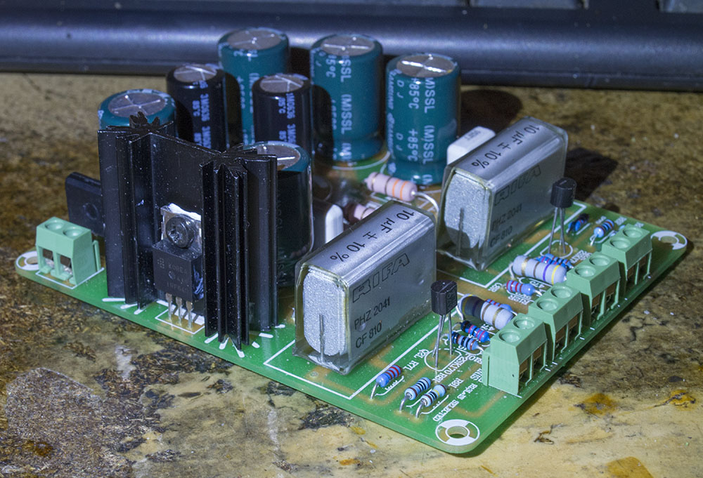

Interesting, I'm not familiar with that version of the BOZ. In that case, it would be possible for the preamp to share a power supply with the power amp. Probably wise to put an RC filter between the two to drop the voltage going to the preamp.

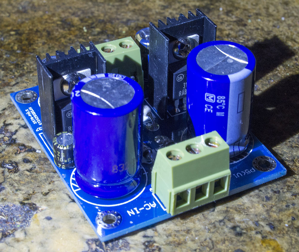

I have two LM317/337 boards to provide the dual rail supplies for the ACAs and two dual rail capacitor arrays I built a while back, so I think I'm covered for the PSUs with the parts I already have to hand.

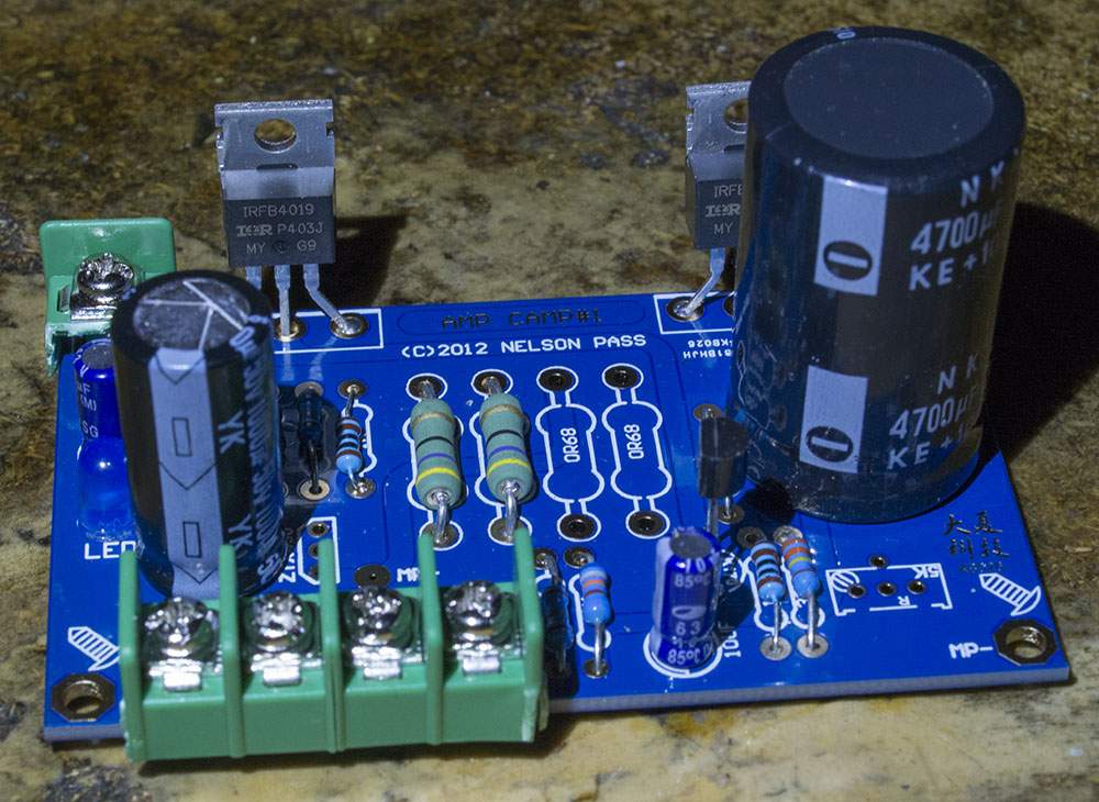

I decided to go ahead and solder the TO-220 IRFB4019 MOSFETs in place, I already have the necessary nylon washers and silicone pads to mount TO-220 parts. The heatsink will be the one that was in the Sharp amp, it's a nice solid extruded aluminium piece that measures 21cm x 8.5cm x 3.5cm and I think will be adequate for the task. I will simply drill 4 holes in it for either self tapping screws or nuts and bolts.

Since you have chosen the IRFB4019 MOSFETs, you will need to be aware that they need approximately 20% higher Vgs to turn on. It may be necessary to adjust some of the resistor values on the ACA board to accommodate this. Being designed for Class D amps, they appear to be pretty easy to drive (low total gate charge, low gate capacitance), and have a high transconductance. They may or may not be optimum for linear operation in a Class A design. Your ears may be the judge of this. They will also be running at a higher percentage of their maximum power rating than we like to use for Class A, so their lifetime might be reduced.

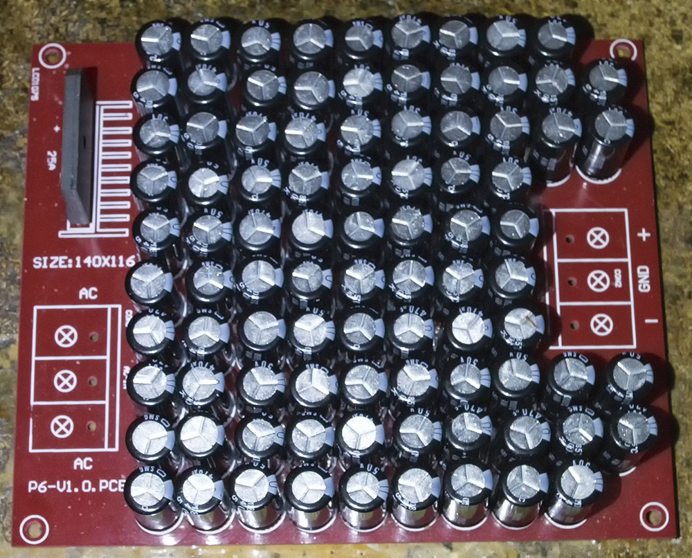

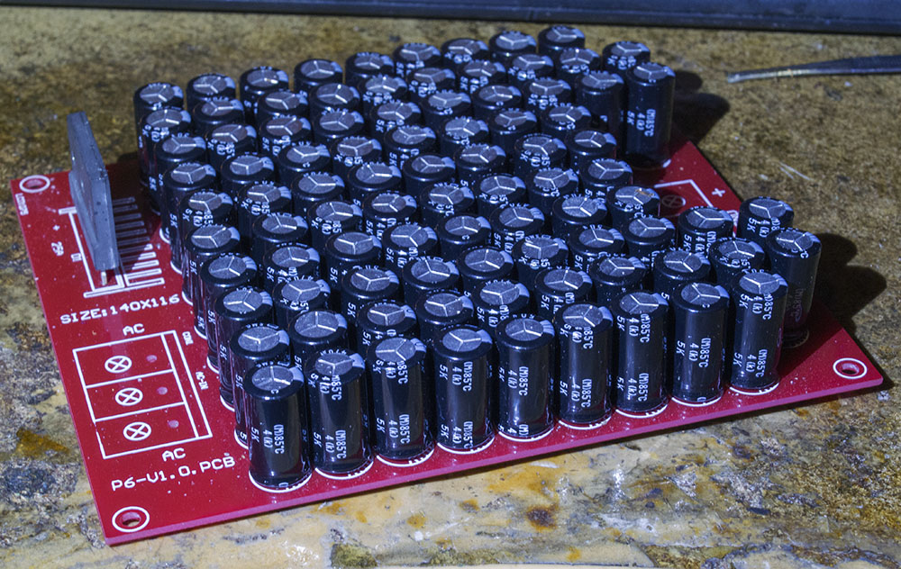

Given I have these two dual rail cap banks that should smooth out the power very nicely with 45x Nippon Chemicon 470uF 50v caps per rail, for a total of 90 per dual board, then the Meanwell SMPS solution might be a good one methinks, the cap banks working well with the Meanwell to produce good, smooth power.

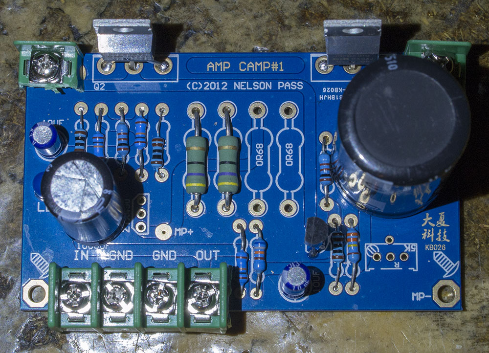

Here's some pics of the parts, I'll take some chassis pics as well shortly.

Ian, the BOZ and ACA boards that you have should be Ok as parts of an integrated amp. I would set aside the others for a different amp that uses dual rails. The BOZ and ACA are both single rail designs (+V / Gnd). Once you finish your integrated amp, take some time to read the build guide guide for the F5. You will notice that a dual-rail power supply for a Class A amp looks very different from the boards you have.

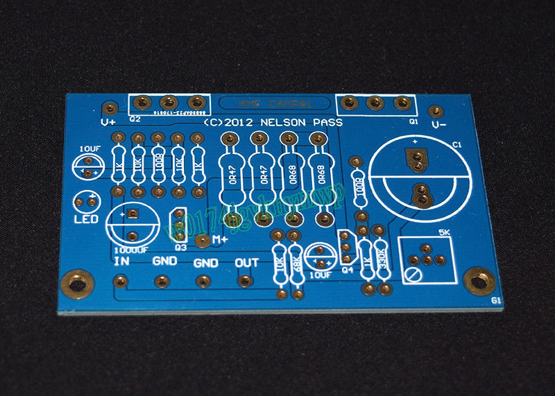

Hmm, I think the ACA boards I have are dual rail, here is a picture of one unpopulated and as you can see, there are V+ and V- connection points either side of the MOSFETs, which I took to mean it was dual rail, but maybe it is single rail and the V- is actually Gnd?
These are Chinese copies of the ACA board, so maybe they made some changes to Nelson's original layout and changed it to dual rail?
If they are single rail, no problemo, I have other parts that can be used to create a suitable single rail supply for each ACA.
