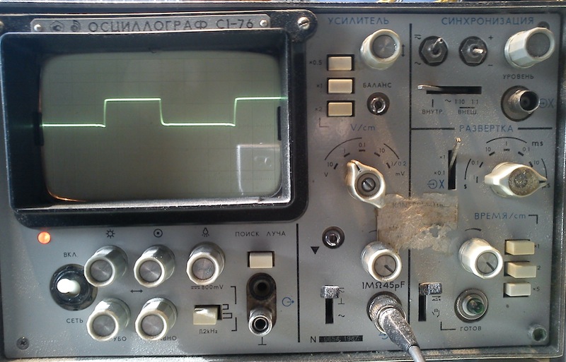

Remove the FETs. For every FET, install a 1k resistor from gate to source. Does the drive signal remain clean and square?
What if you connect the resistor from the gate to the drain?
Do this for one FET at a time.
That would seem to eliminate the drive circuit as the fault if you checked the signal on the gate pad for the FETs.
For the FET that repeatedly blows, double-check the drive signal while pushing on/flexing the circuit board. Does the waveform ever change from a perfect drive signal?

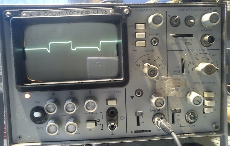

Then i put in new FETs in the problematic side. Two of them blew. Left good ones in, installed 1k resistors from gate to drain in place of blown FETs on one I get clean square, on the not so clean, see first attached photo. Square is clean on the 494 side of the gate resistor.
Also there is a waveform on 22 ohm resistors coming from 494 and going to transformers, I have never checked if there is just +12V or some waveform, anyway, what I saw on those resistors is on second photo.

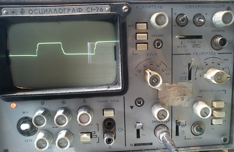

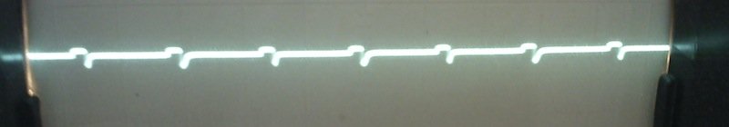

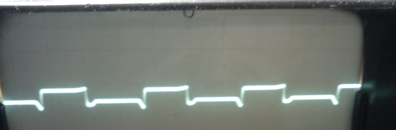

Some new screens of waveforms I found from the amp.
Timebase for all photos: 5us, vertical: 2V
First photo is gate signal on a FET.
Second and third photo are gate signal on gate pad with 1k resistor connected from gate to drain, both are driven by the same driver transistor.

If the scope is set to 2v/div, it appears that the NPN driver transistors don't have sufficient DC voltage on their collectors.
Are you sure that those are the right transistors?
Unless this amp uses a drive circuit that's very different from most amps, that transistor should be a PNP transistor.
Does this amp use an emitter follower pair (NPN and PNP transistors) for the drivers?

Why is your power supply producing only 10.2v DC?
What is the amplitude of the square wave on pins 9 and 10?
How does that compare to the voltage on the gates of the FETs?
