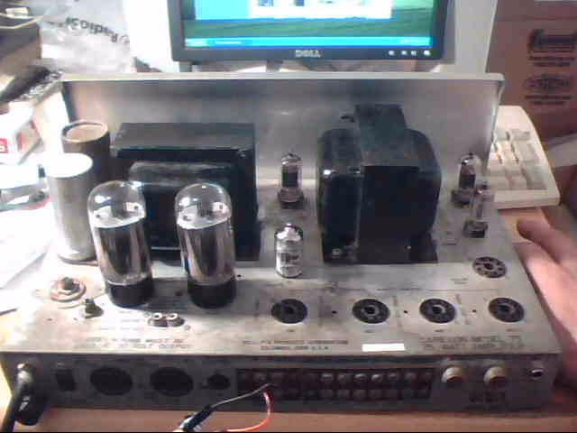

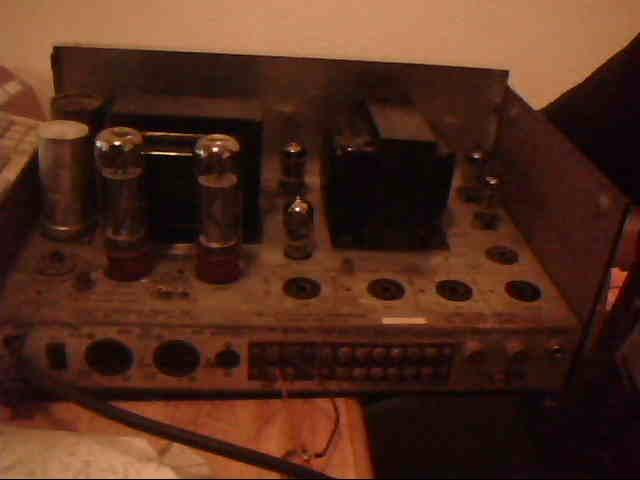

I Changed My Output Tubes from EL 34 6CA7 to 6L6 GC .

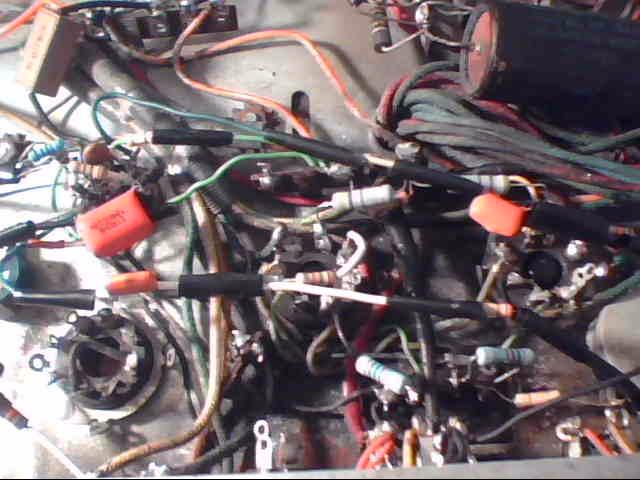

I Got the bias !
I read hundreds of articles that tube amp techs wrote most made little sense to me ! .
You need to control the negative bias current flow with resistors to put the tubes current flow somewhere in the .030 to .040 mA range with a minus 52 volts on the grids ! . Not very hard to do once you understand it - but it's hard to explain it in words ! .
I used Fender specs for my build and they were all totally wrong for my amp basically and I had to basically alter almost all of them .
I got some very bad advise from a few different techs telling me to go and gut the amp and to start over with another guitar amps diagram .
I won't ever make that kind of a mistake again ! .
I was right in the beginning to just modify the input and the pre-amp only ! .
Everyone thinks Fender is some kind of great amplifier god of some kind and I dis-agree with that and with using any of the fender designs ever again .
Fender knows only fender and nothing else is how I see it now ! .
I normally will study many older wiring diagrams and then I will draw my own conclusions from them all and come up with my own designs and they usually work pretty good - if I do it that way ! .
I'm Not sure why I listened to others on this amp project ? I guess I was just in too big of a hurry with it . If Your amp is not a fender amp then don't try to use a fender design , that is my advice ! . Find something closer to Your amps design to use ! .
I'm Happy It is working good once again now ! . I got some 1950's Sylvania black plates coming for it and then I will fine tune it some more and clean the amp up inside and out and then I will update the forum with some before and after pictures once I get er all done !

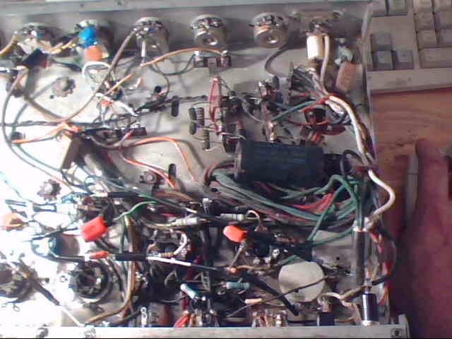

I lost the bias ? So I Took it to a good tech !
I had My Bell amp working good and then after I shut it off and the bias changed again ? Crazy stuff ! .
