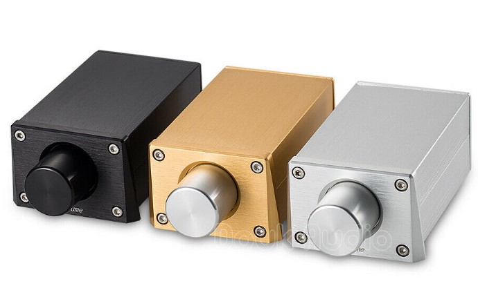

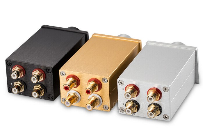

This should work, is well made, and will take up to two sources.

That's no problem 🙂 I'll have a think but I don't see anything cheap and cheerful tbh. The stuff on eBay seems to be around £30 to 40 in UK money while a diy option would be around £1 🙂

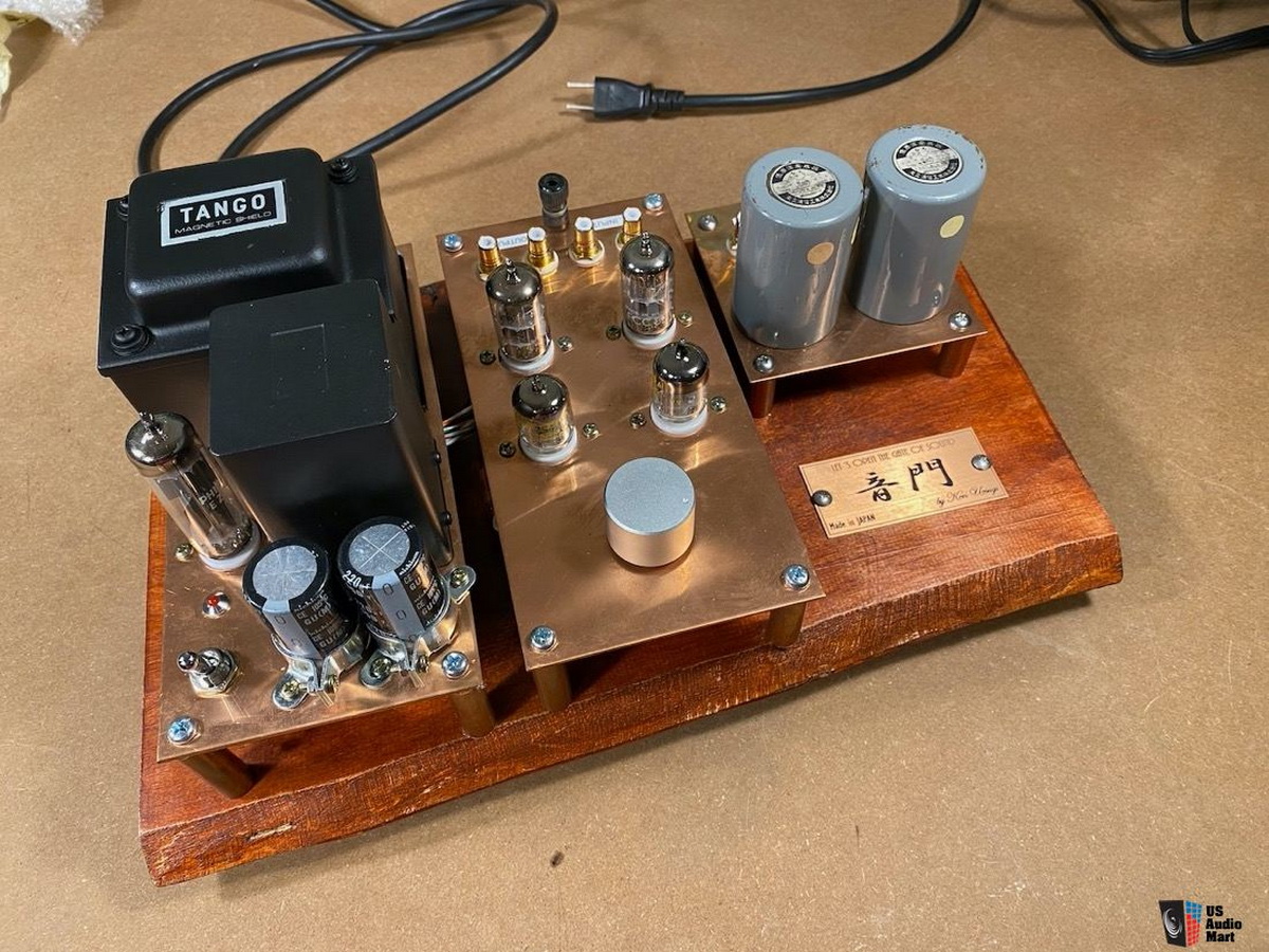

That looks nice , I like the old school chrome on/off switch I have many original ones.
It looks like a work of art and the sound reproduction 355F1 ?
Japan made some very good record decks/ cartridges /amplifiers/loudspeakers etc although China has taken over many factories and transferred business there , what are the specs of it ?
It is a phono preamplifier built by Ken Uesugi of Soundgate/Otomon Lab in Japan. It uses a Tango power transformer and a choke, WE396A, (5670) in phono stage, Output tube is 6DJ8. It has a volume control, and separately a Tamura step up transformer, so it can be used with MC carts. It is for a pure vinyl setup.
High quality parts. This was a special order, the power supply was designed separately to prevent hum and noise.
The MC step up transformer is separated, it can be used with another MC step up trans. It is a rather a handmade looking piece, it is rated at 100VAC, I have a Hammond 1.5 KVAC step-up transformer.
Its the first piece of electronic equipment I am actually jealous of - looks great and "handmade " to me is a BIG plus .
You could enter it to the Manhattan NYC Museum of Modern Art and it would win a prize.
No problem with the 100 AC as I have various step down encased with US sockets transformers.

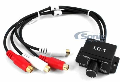

You can get these on eBay for less than $10. I use one ahead of a Henry Matchbox (ballanced / unballanced converter)
for test signals from the computer. Works just fine. I believe mine uses 10K pots though they mismarked the input and
output connectors. With an ohm meter there will be no resistance change on the input side as you turn the knob. The output
side will vary from 0 at full CCW to the pot value at full CW. This would hold you until the final solution.
