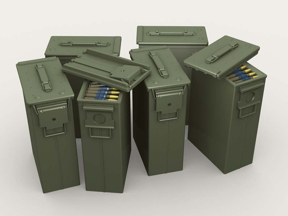

I have a PA70 Ammocan (11x16x5.5 fr 5.6 ft3) and trying to figure which would be best for my drivers. I have in my possession,
Dayton dc160-8ohm 6.5" woofer
or also have the
Dayton DCS165-4ohm subwoofer
Either of those to be paired with
Tang Band 1320sj 8ohm full range bamboo 4" driver
Dayton DC28FS-8ohm silk dome tweet
My concerns are the Dayton sub is is 4ohm and the other drivers are 8 ohm and me being a noob, not knowing how compatible that will be.
I'd likely use a Nobsound 2x50+100 bluetooth amp. The amp is the only piece I do not yet have. I am using an active 3 way crossover.
Which 6.5" driver? Vent the can and use the subwoofer? Or Use Dayton's PR215 8" Passive Radiator on the back of the can with the DC160? Or the DC160 alone?

You may mean 0.56 cubic feet.
Which leads to a 5" (tuned) to 9" (sealed) driver.
