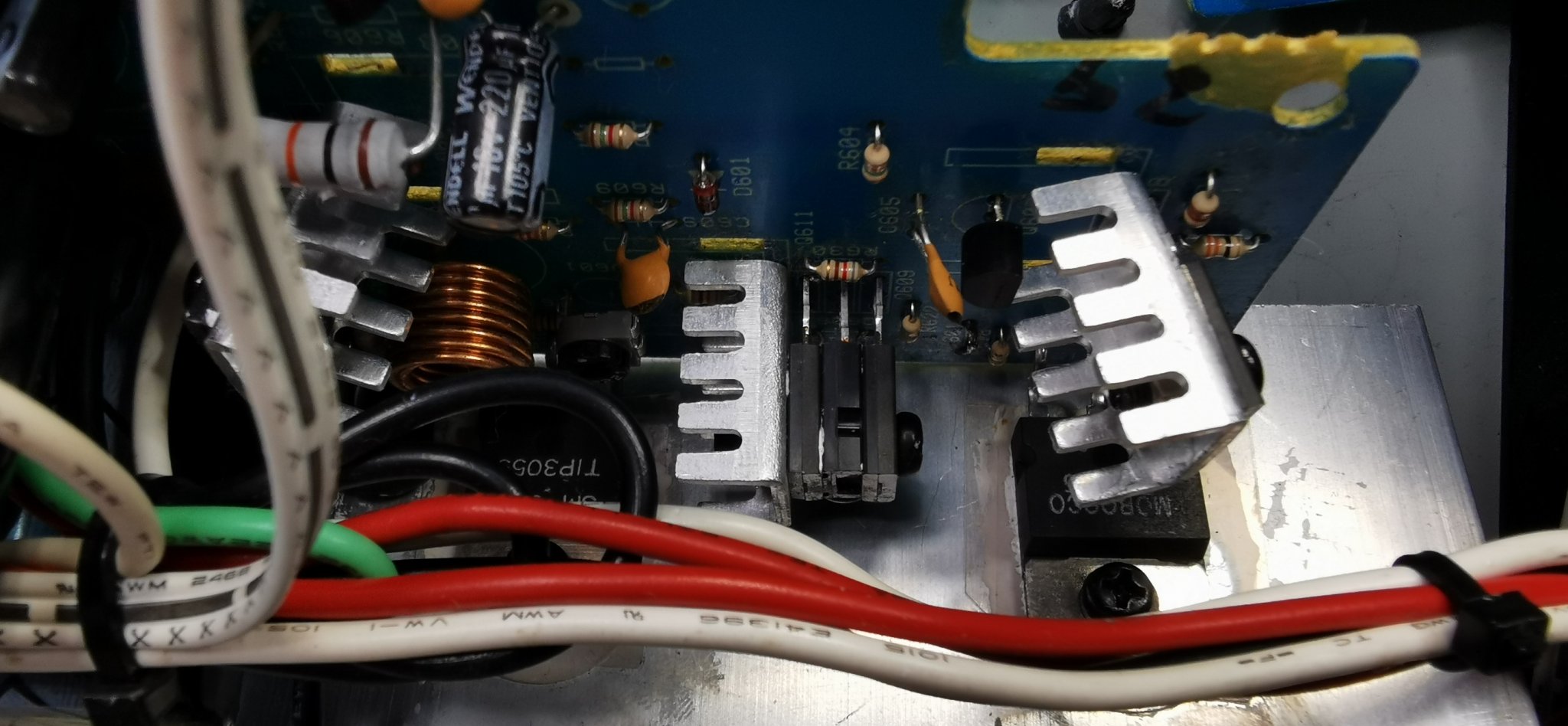

Just out of curiosity realy, picked this up for less than £20, powers on ok, no blown fuses, but no sound, just hum
never seen transistors mounted like this before

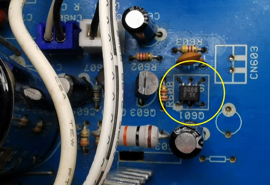

there is a strange transistor ive not seen before,(Q601) and the manual says it should be a 2sc3066, but it def not one of those
cant see this being factory can you

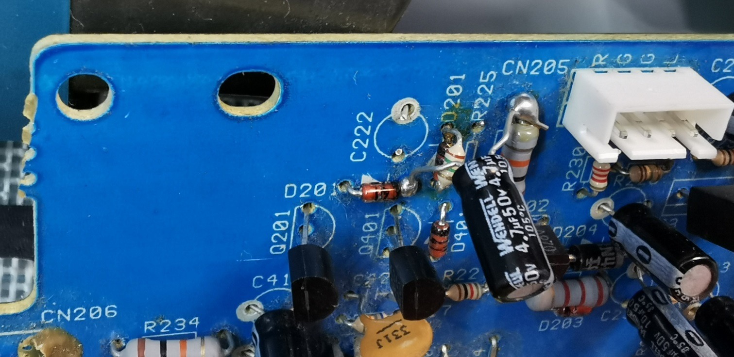

4.7uf cap over that diode only equates to putting it into its proper place on the board
plus a 1.5m ohm over d201?
weird, why would someone have done that, the diode is ok

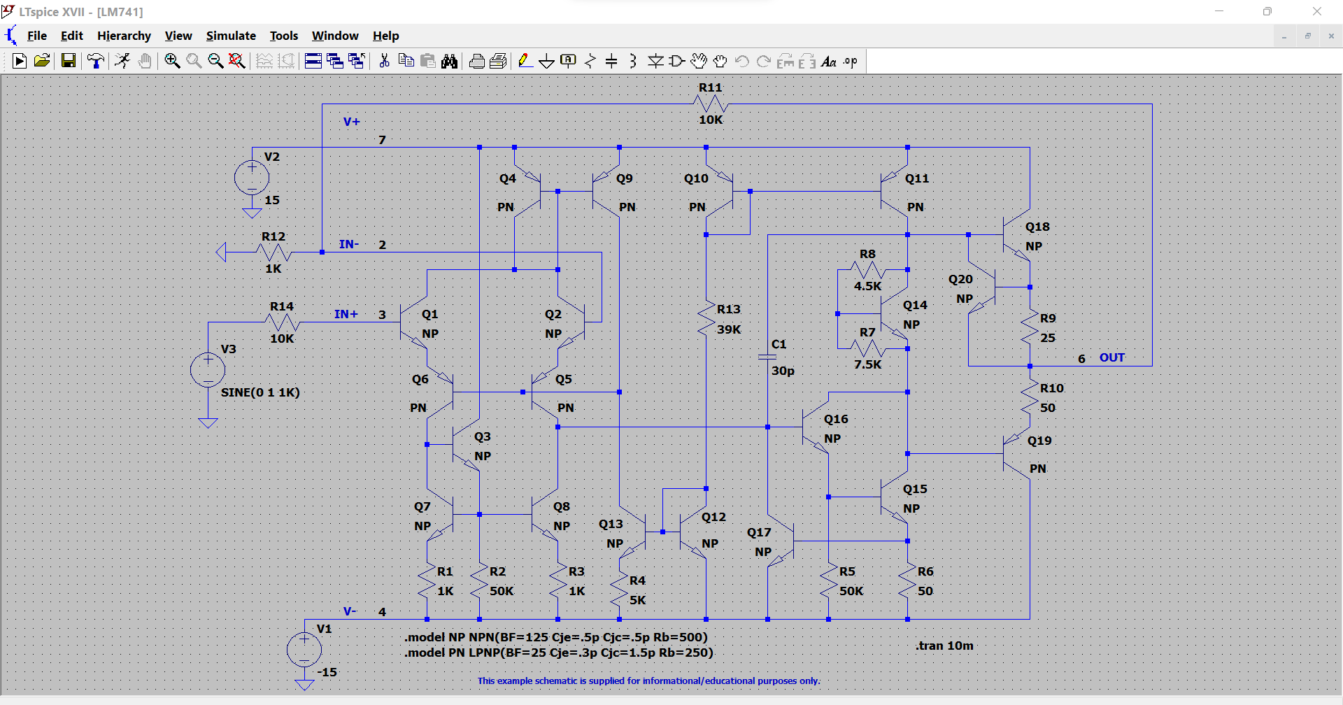

You would have to try it for yourself. Opamps do sound different and that is no surprise really when you look at what is in one because it is really a small complete amplifier in itself.
If you look in your Document folder and look at the LTspice Folder there is a folder in there called 'Examples'. Open the folder and click on 'Educational' and there is a 741 opamp in the list. You'll see it looks very much like a proper amplifier. Run the sim, it all works.
So different opamp sound different. I always liked the TL072 FET series. The LM4562 is a the modern replacement for the NE5532. The 4558 is a jelly bean opamp and the 1458 is a dual 741. So trying a 1458 (to see what the worst sound like) is good to do.

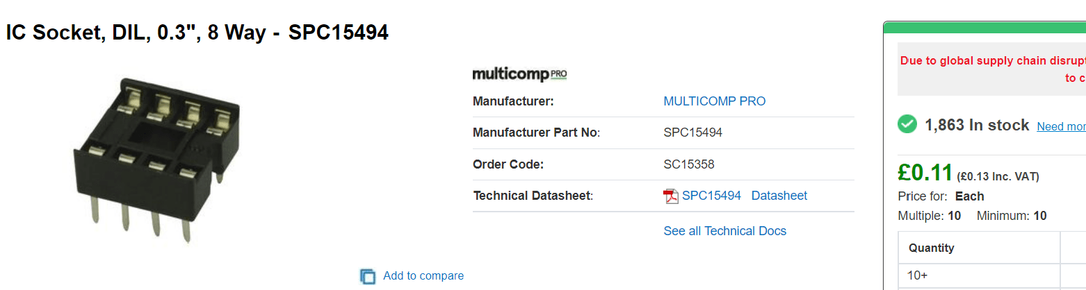

They are a socket you fit and then you can try different ones. The socket can be left as a permanent fixture.
These:
https://cpc.farnell.com/multicomp/spc15494/dip-socket-8pos-2row-2-54mm-th/dp/SC15358?st=ic socket
When you remove an IC from a socket you do it by levering it up a little at a time from each end with a small screwdriver. It you try and remove it without easing it out a little at a time from each end then it will suddenly pop out and bend all the pins in the process while most liking stabbing you in the finger with half the pins at the same time.
