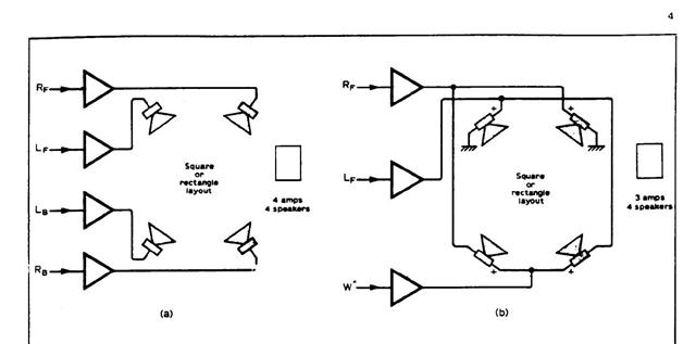

This is an example of how your could wire speakers up with the ambisonics method. Seems very unlikely that you can get the same accurate results in imaging. Also the woofer signal has no reference to it's own ground, what comes out of the woofer is really dependent on what contents the other amplifiers have. It just seems to me that it uses lots of out-of-phase signals to create a synthetic sense of space, having to relevance to where the performers actually are.

Those speaker layouts look like the ones from the old Integrex Ambisonics kit iinstructions. Probably a good idea at the time for saving on amps. Did not like the look of it myself.
My plan would be to have four or six speakers for 2-d surround or eight for 3-d. The decoder would be built (configured) to handle the different layouts. Note the square or cubic arrangements can be stretched front to back or sideways to fit the room and the decoder adjusted accordingly.
Each speaker could be cheap Tangband with it's own chip amp. Not so expensive and no need for confusing speaker connections.

Yes heater, those are from the ntegrex kit instructions. If I sound stage is to be correctly reproduced, there must be a standard was of allocating the speakers in order to preserve the time relation between the recorded direct performance and the delayed reflections and reverberation. I have not seen any information that explains how the speakers are correctly setup.

That integrex kit is mind bending. Seems to support a lot of different input codings that don't or never did exist and does not support the common UHJ as used by Nimbus I believe.
