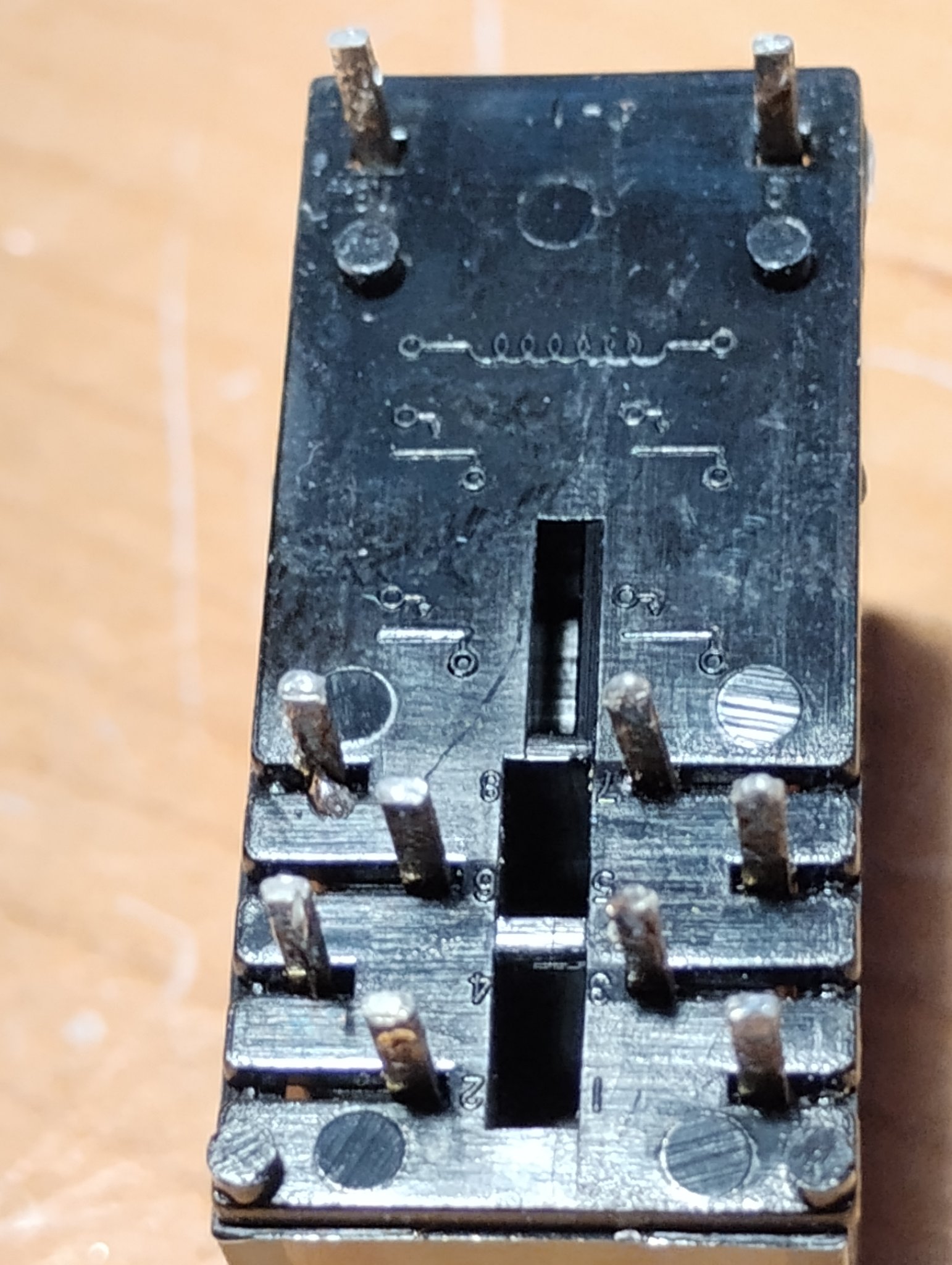

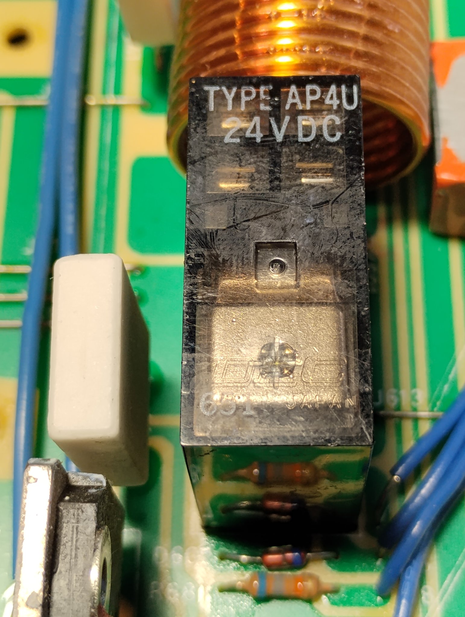

Greetings again Guys would anyone know what a good substitute might be Relay for the IDEC AP4U 24 V attached are some pics
If there is a substitute, would I have to modify or cut any leads of the Substitute Relay is Resistance I measured is about 681 Ohms

Turns out this relay has four SPDT switches. The board connects all of the four in parallel for one higher current switch.
So all you need is a 10A or more relay with a 24VDC coil, with one or two SPDT switches, a standard configuration.
However you'll have to work out a way to connect it to the board, since the old footprint won't work any more.
Perhaps a local tech could do this for you.

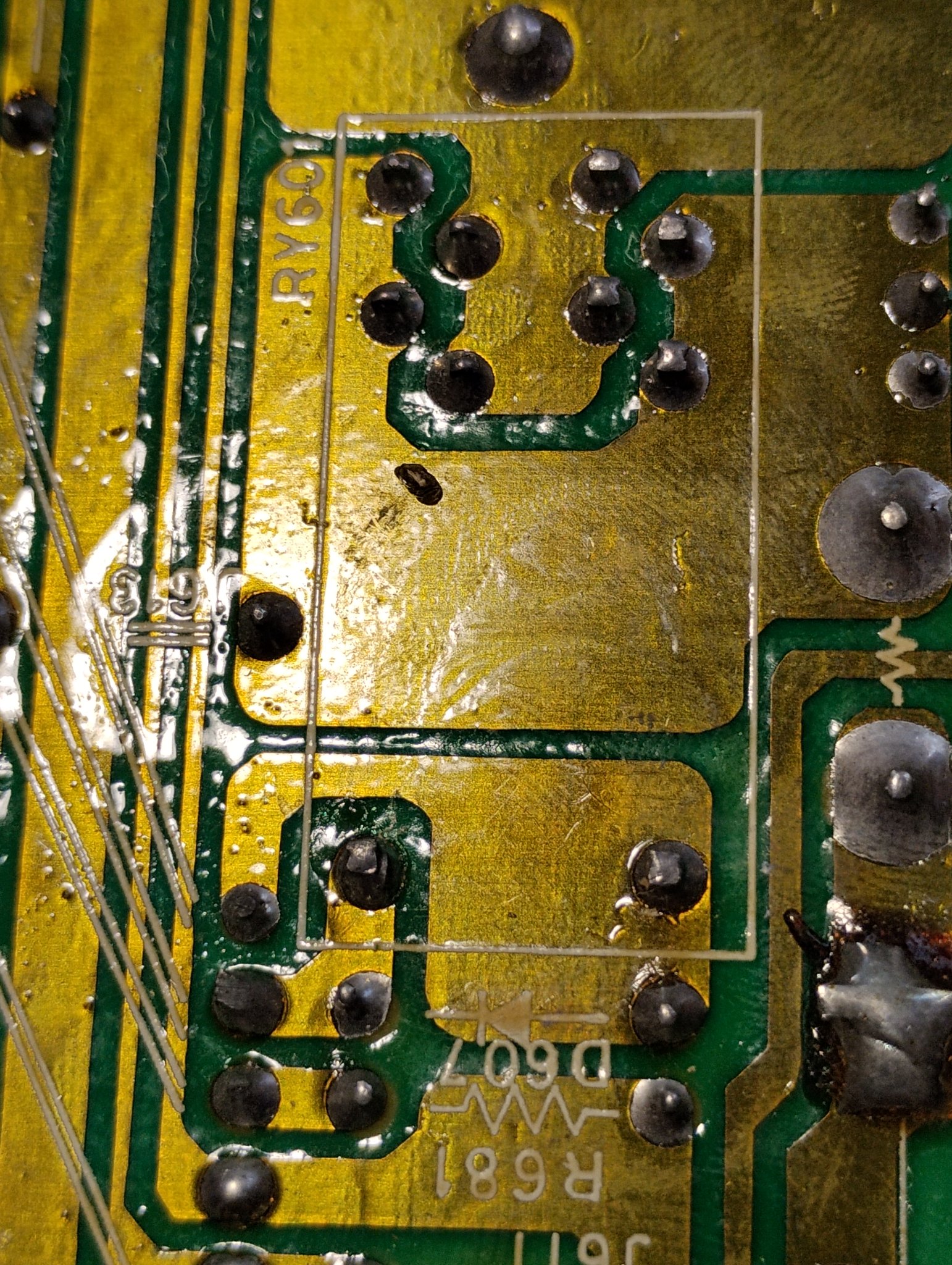

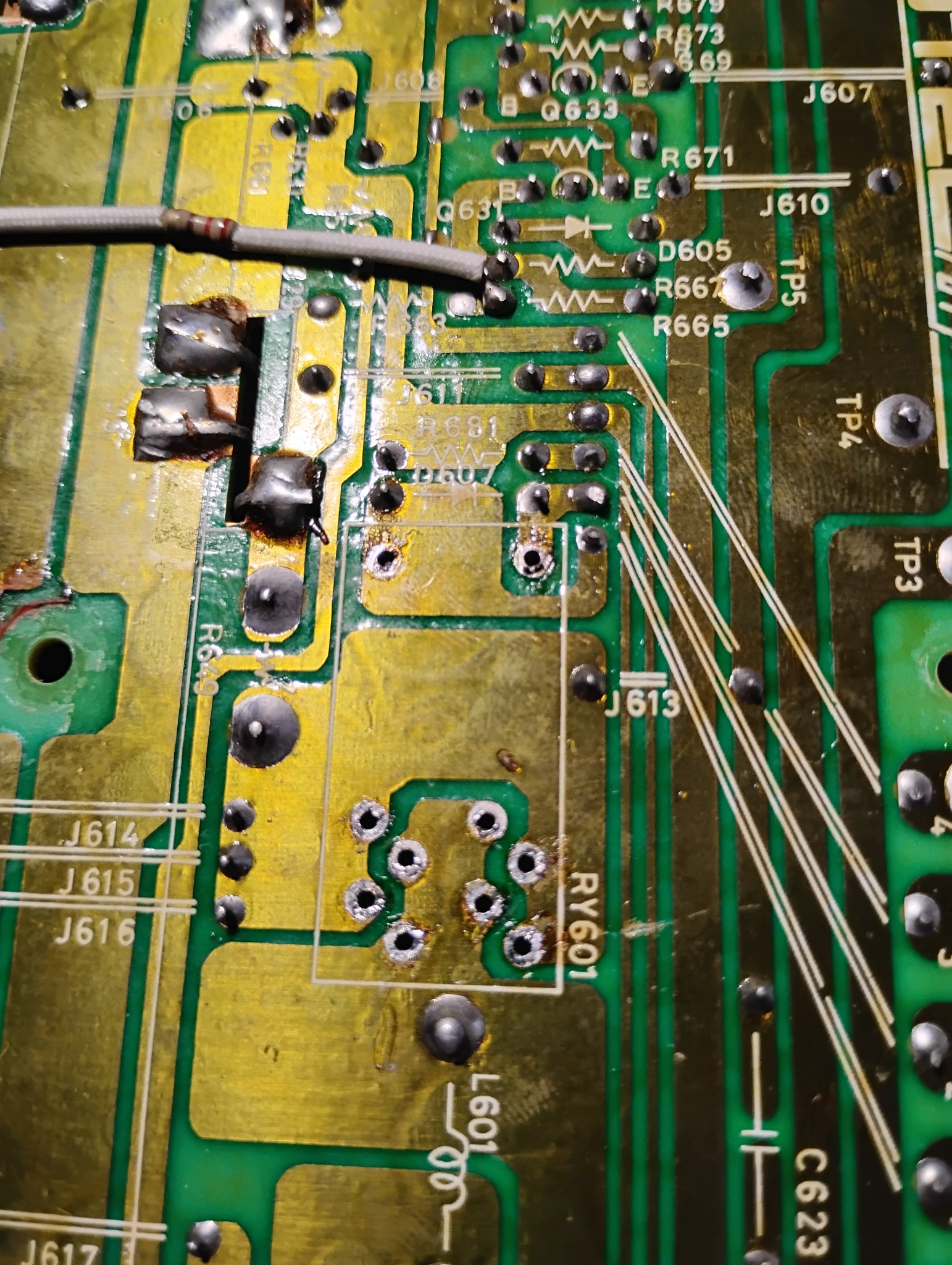

I can't thank everyone who has been helping me Attached is the back of the PC Board any Insite as to how I could go about wiring a standard 24 Volt 10 Amp Relay in place of the old relay would be greatly appreciated

ok it's much clearer now, they chose this quadruple relay to pass more current but it's a double circuit, so a two-way relay that passes enough current can be put in place with almost no modification, just a bit of drilling and adaptation.

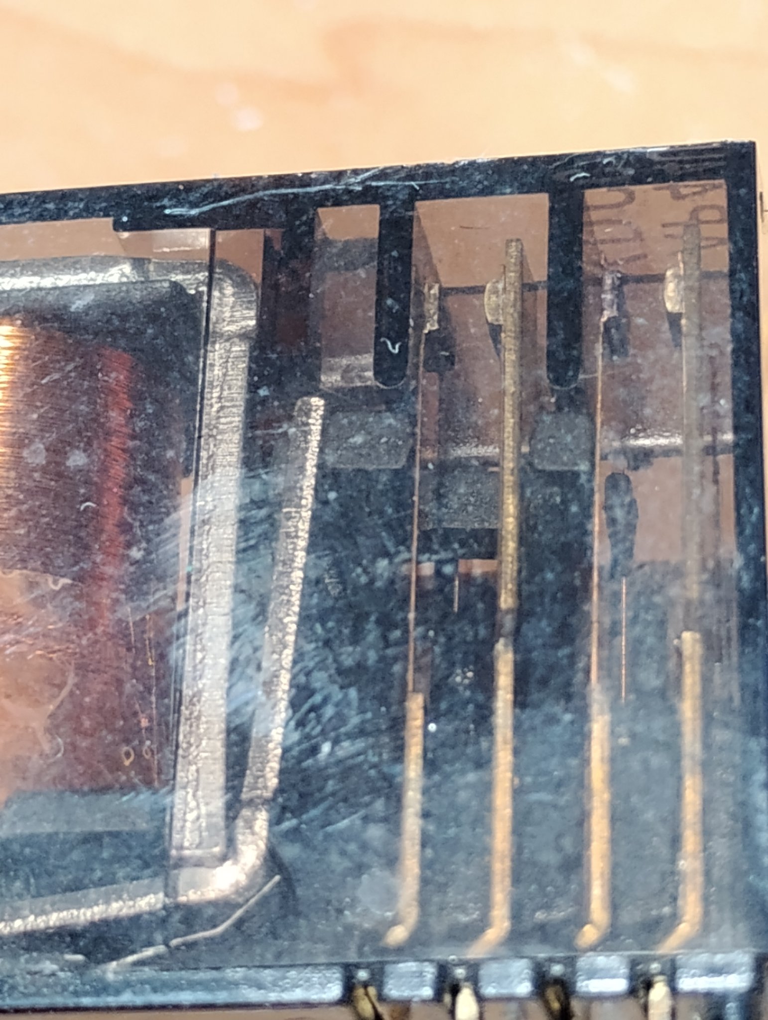

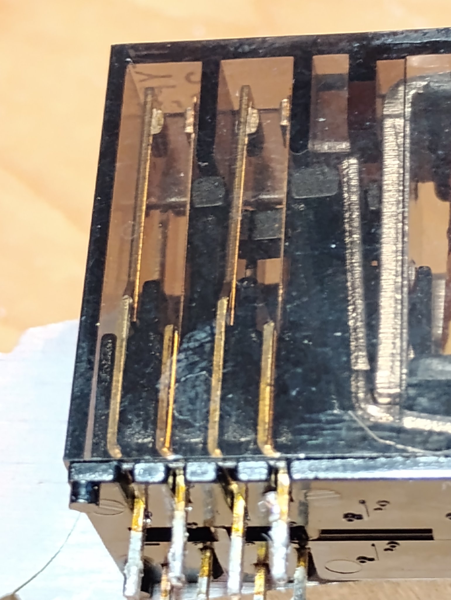

Maybe you don't want to read this, but if it is a 4-contact relay, I expect it to be perfectly fine.
The trick of multi contact relais at this position is not the 4 times as high allowed current. Inside such a relay the contacts never hit at the same time, some are always slower. You expect the fast ones to sacrifice contact condition to switching loads, while the others keep their as new condition and will conduct with lowest resistance for ages. So some contact will burn and build up corrosion, while the others don't.
Take a very good look at the contacts, you should see different signs of wear. Maybe just reinstall it. If you can open it, maybe use some contact cleaner, but never scrape or file the contacts.

Who made the suggestion of using a 10 Amp Relay I believe a Dubble Pole Two Throw Relay and mentioned I might have to drill some holes in the PC Board
To accommodate the new Relay, I just don't know where to drill the holes in the PC Board.
