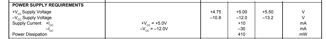

Recently bought a Sony CDP-970 entirely to play with :smash:
It does indeed have 2 x PCM59P's but they are weirdly graded -1 NOT J or K
are the -s and -1 grades a Sony thing but equivalent? Any info appreciated here
Further (and more curiously) the -Vcc rail is at -8 volts not -12 as its supposed to be, after datasheet mining it seems *only* Sony did that and then only once. Any idea why? They've gone to some lengths to do it to with an op-amp regulated supply too rather than a fixed reg. Again any info is appreciated.

DAC V+ = 5V
DAC V- = -8V (would've been -5V, but a higher negative voltage is required, to obtain decent linearity out of that current-out DAC)
The +5 and -5 volts OP amp rails are probably there because the analog output stage was lifted from one of Sony's portable players; no need to use the higher voltage to start with, also no need for separate voltage regulators for + and - 12V DC, for example..... (cost savings in parts/design).... but I might be wrong.

According to the datasheet the PCM58p requires +5/-12v. -8v is out of spec.😕
I hadn't spotted that the OP amps are only +/-5v either but I take your point it eliminates the need for an entire power section to service two op-amps. That said, the Headphone amp is +/-9v
