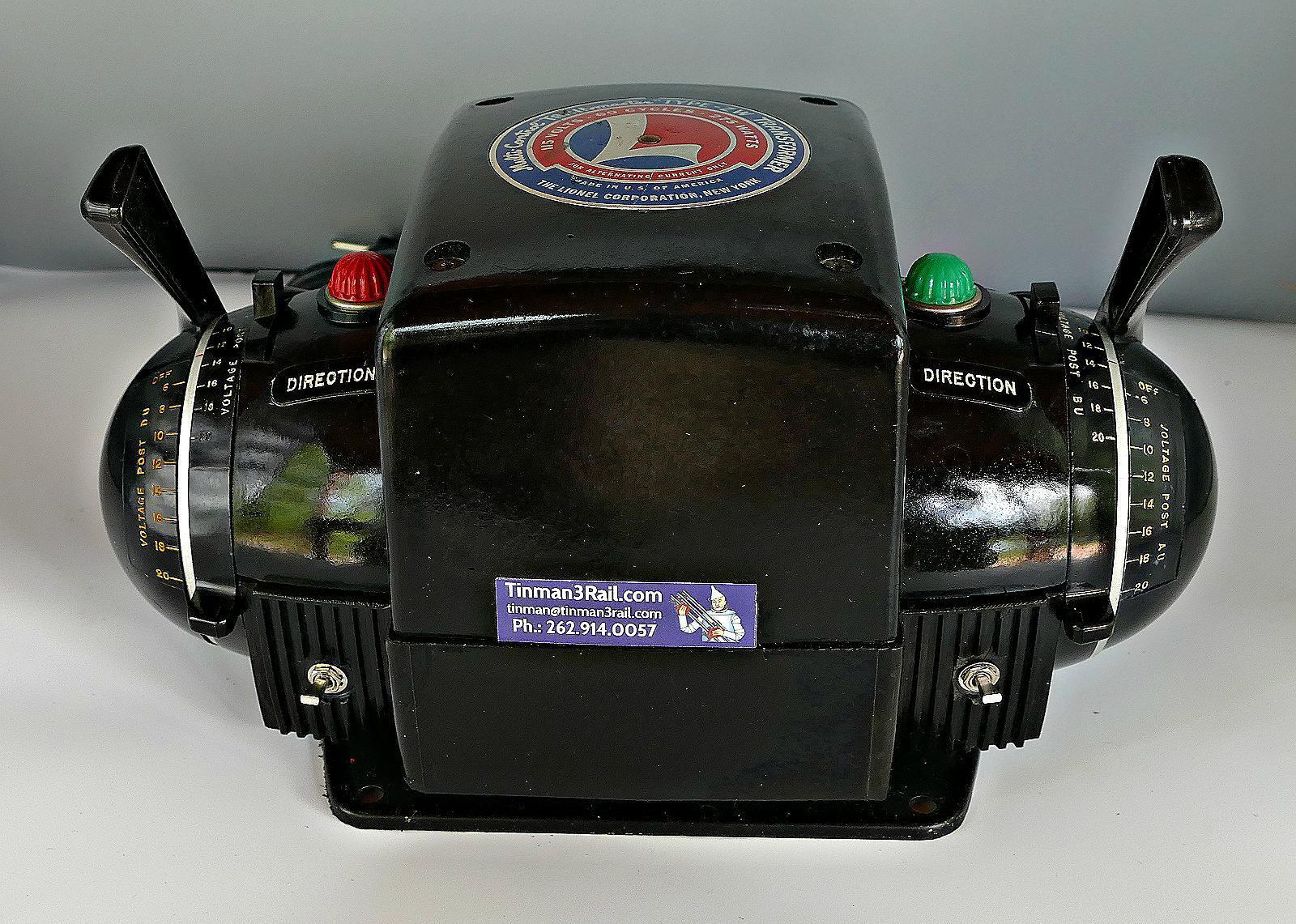

I’m not sure about your design but thought you’d like this. I turned this tranny into a preamp. Volume on the right and input selector on the left.
I had one of those transformers as a kid in the early 60's. It fed a big selenium bridge rectifier and a bunch of caps for my (rare) solid state projects or fed the 12 volt heater windings on a transformer pulled from a discarded vacuum tube console organ to generate adjustable high voltage. Variacs were unobtainable to a kid who got his parts from the trash dump or the auto junkyard. Grandpa's old train transformer allowed me to "turn it up till it glows" at a young age.

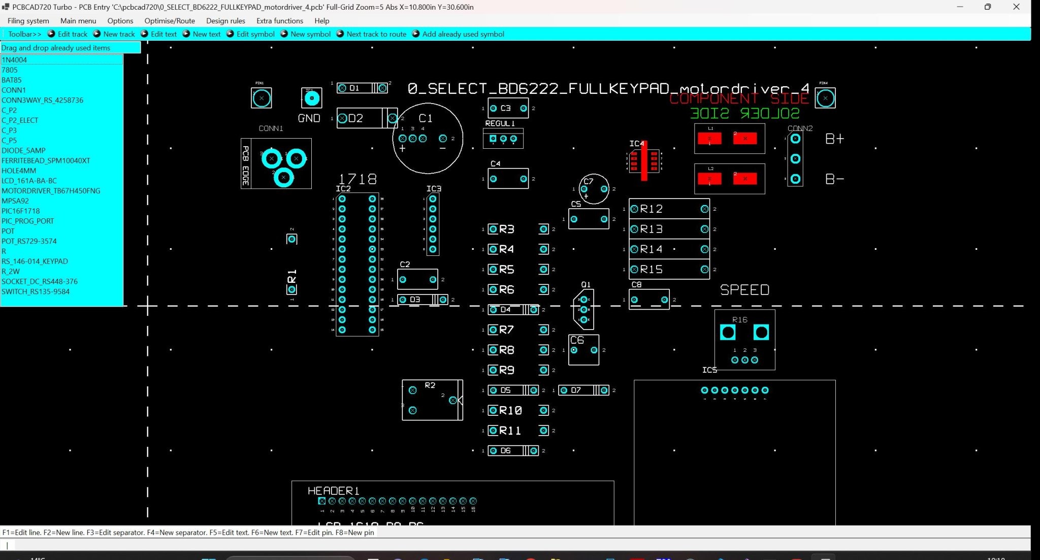

Just out of curiosity, what software do you use?
I use PCBCAD720 which I wrote myself.
One feature I like which I use a lot is the "swap auto placer", it goes through the components and if swapping 2 components decreases net size it keeps the new order and optimises the net.
Once I have finished the pcb I use a re-annotator to renumber components along and down the pcb.
