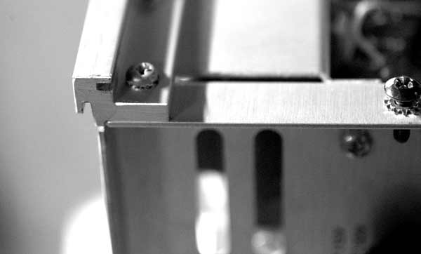

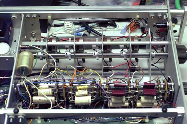

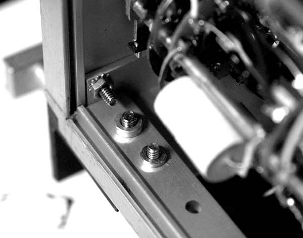

Hello,
It could seems a dummy question, but well ... i'm on ebay since the last week end ...and I can't find aluminium profils like thoses of Thomas (VinylSavor) use ....
They seems pretty cool to use. Can you help me please ?
Thank you !
Thoses one, L shapped or straight

Look into Grid Beam.
Same concept. There’s many metal suppliers out there providing products under many different names for different purposes.... OpenBeam, MakerBeam, 80/20, etc. There’s also 3D printed options.
If you want ultimate value, get the grid beam book and build your own jig and you can make any size you need.
How to Build with Grid Beam: A Fast, Easy and Affordable System for Constructing Almost Anything: Phil Jergenson, Richard Jergenson, Wilma Keppel: 9780865716131: Amazon.com: Books
This construction philosophy can be applied to almost anything- homes, furniture, robotics, and so on. You can scale it obviously to your needs.
Edit: some links
A.C. Gilbert Erector Sets and Other Metal Construction Toys - Girders & Gears
Metal & Hardware Kit - VEX Robotics
OpenBeam - 15x15mm aluminum profile - MakerBeam
OpenBeam in Europe - MakerBeam
PS as an aside: maybe a more appropriate title would be
Modular Framing and Construction Options Similar to VinylSavior
Aluminum isn’t the only material, and I don’t think it’s the material VinylSavior uses anyhow.

There is also OpenBuilds Part Store:
http://openbuildspartstore.com/
They have some great prices on profiles.
Brüklin sells it (made by Fischer Elektronik):
Fischer Elektronik Aluminum rack profile, WP 12 G, perforated, 1.0 m WP12X12X2 1016AL-SL M.LO | Burklin Elektronik
Sorry, Bürklin. 🙂
This is the mounting block of anti-vibration device (M3 threaded).
Standard Mounting block | Burklin Elektronik
Usable -for example- for this type vibration damper.
DVA.1-8-8-M3-6-40 ELESA+GANTER - Vibration damper | TME - Electronic components
