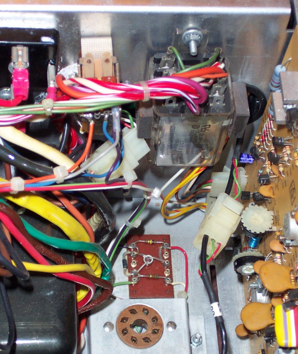

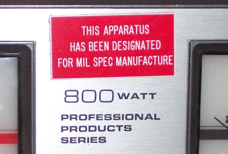

Thanks to tomtt for the link. Unfortunately, my 9440A is several years newer than those documents (13th week of 1982) and also has a label saying the following:

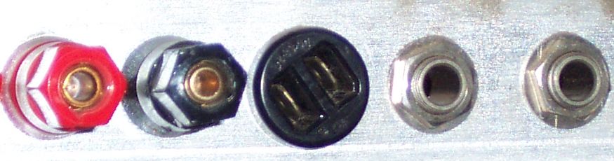

There's an additional relay not in the 1975-1977 documentation as well as a two-pin connector (with a pair of 1/4" male quick connects) located between the input jacks and the output binding posts. The relay and that connector, along with a small terminal board containing a transistor and a couple of resistors, are wired into the circuit with the thermal switch between the E18 terminals on the output boards. At first I couldn't get the output relay to pull in. I had tried leaving the pins of the extra two-pin connector open as well as shorting them together after power was already on. (There was about a quarter of a volt between the pins when open and one pin goes only to one end of a 510-ohm resistor, so I figured it was safe to try shorting them.) I later discovered that leaving the pins shorted when power was applied would allow the output relay to energize. The additional relay seems to form a latch requiring a power removal for reset if the short is removed from the connector.
Does anyone here know anything about those changes? I have no idea if they're custom for MIL SPEC or if they were standard in later production units.
THIS APPARATUS
HAS BEEN DESIGNATED
FOR MIL SPEC MANUFACTURE

Here are pictures of the extra connector, both relays, and the label on the front panel:
If you scroll to the bottom of the picture of the relays, you can see the terminal board with a transistor, two resistors, and a diode.
Six wires (orange, blue, grey, white, red, and green) go back to the heatsink assembly and a seventh (violet) goes from the relay's normally-closed contact to the transistor on the terminal board.
I looked at one that was built at the very last of the production run and it has no added circuitry or relay. Based on your pictures it looks like something that someone has added. If it were me I would remove the added parts so it reverts back to the circuit as shown on the schematics.

I was going to do that before I figured out that leaving the two pins of the extra connector jumpered together makes everything operate normally. The workmanship of the mods leads me to believe it was done by Altec, perhaps in their prototype lab. It really looks like it was done during manufacture rather than later.

I went thru all of my Altec service information that lists the different modicications and fixes that were necessary over the years and there is no mention of what you have there. To me it still looks like something someone added but not something that ever came out of the R&D lab. Altec documented everything and being an Altec dealer until they went belly up we have had numerous occasions to meet with different engineers over the years.
