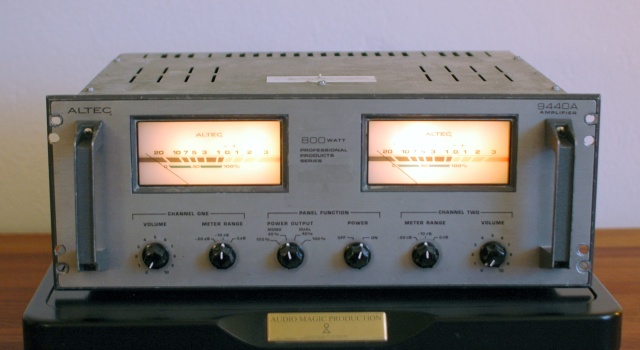

Is it possible to clone Altec 9440A using modern transistors ? Some say that this Altec is best solid state amplifier ever made. Unfortunately I have no chance to listen it. Maybe someone have pics or fotos of pcb's ? Schematic i for free available on internet, so it is no problem.

The 9440 is a good commercial/industrial use amplifier. They sound good and at one time I had 5 of them in my home theater rack running bridge mono. Certainly not the best sounding amplifier in my opinion and probably not worth the time to update the semiconductors. I have seen it done in the past and to do it correctly it requires some machine work to the heat sinks. Sonically, replacing the transistors will NOT make this amplifier sound better and I noticed no difference between a stock amplifier and one with up to date parts. If DJK sees this thread maybe he will chime in with some part numbers and advice.

I had one, bought for 10$ at a tag sale. Worked good after I refurbished it some. New caps, cleaned switches/pots, reflowed connections, etc... Sold it for over 400$.

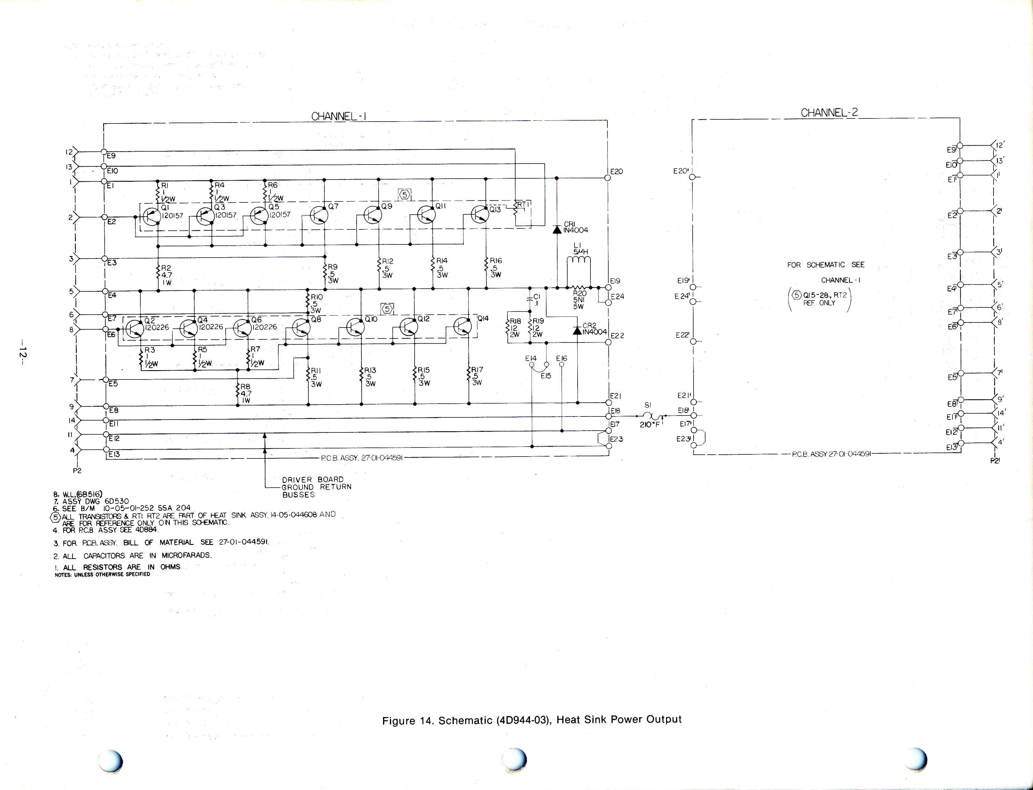

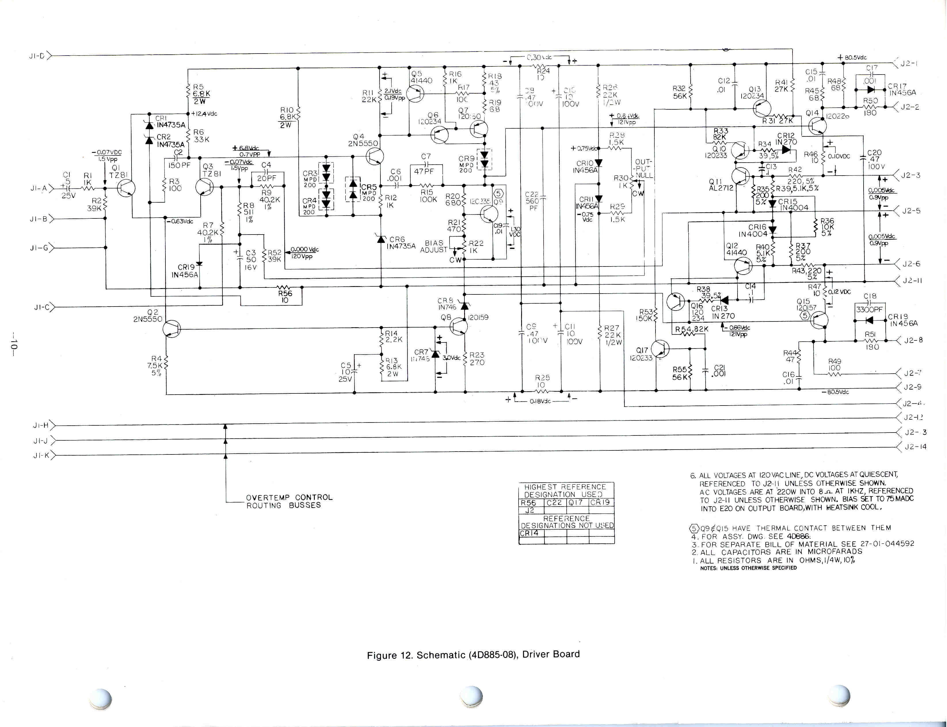

It would be quite a formidable undertaking, with lots of output transisitors on a huge heatsink and a huge power supply to keep it all going. I'm not sure that it would be worth the effort to build a clone of a high-power quasi-complementary circuit.
Here are some extracts from the service manual. If you want to duplicate those meters and switches on the front panel, it gets even more complicated.
It would be much easier to get an old one and modify it.
BTW, I got the diagrams here:
http://alteclansingunofficial.nlenet.net/proelectronics/proamplifiers/index.html
Wow, three parallel driver transistors to drive only 4 output transistors. What an effort of design overpowering feeble early parts.

"Wow, three parallel driver transistors to drive only 4 output transistors. What an effort of design overpowering feeble early parts. "
OK, since you're so smart, what would you use?
Remember, you need good SOA at 100V, 30Mhz, 6A, and a 200°C rating.

I considered having the heatsink machined and something like MJW3281/1302 drivers, but decided that the original 2N3584/6421 were a better way to go.
MJ21196 for outputs, not quite as much SOA as the original 2N6259, but they should be OK.
The real question in my mind are the MPSU10/60, not sure about what to use here (NOS parts are $$$).
