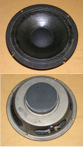

This is the "hi-fi" version out of the Atlantic. Same magnet and basket structure as the 409. I don't know why, but these have a ferrite type rear pole plate.
Not the best 8-incher made. Better if you cross to a bigger woofer at 100 Hz or so. These have had a bit of cone treatment to fix the top end.
