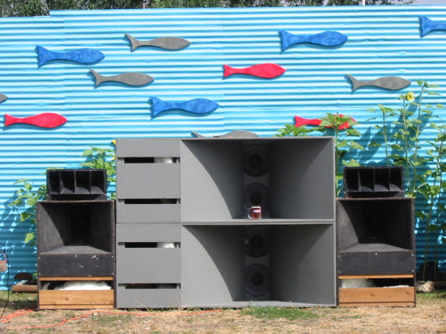

If you like the 210 you should check out the split 210. This is were a guy took 1 210 and split it in two. You could just build two of them as singles. I think the mouth is large enough for a 350hz horn right in the center. Either way, you'll need subs if you listen to anything other than classical, accoustic, and jazz.

Has anyone measured the spilt 210? It would be interesting to hear them with a horn in hung in the middle of the opening. Would that effect the low end much???
AND, the split 210 being that narrow, would there be an off axis issue if it was slight and the mid/hi horn was a CD???
