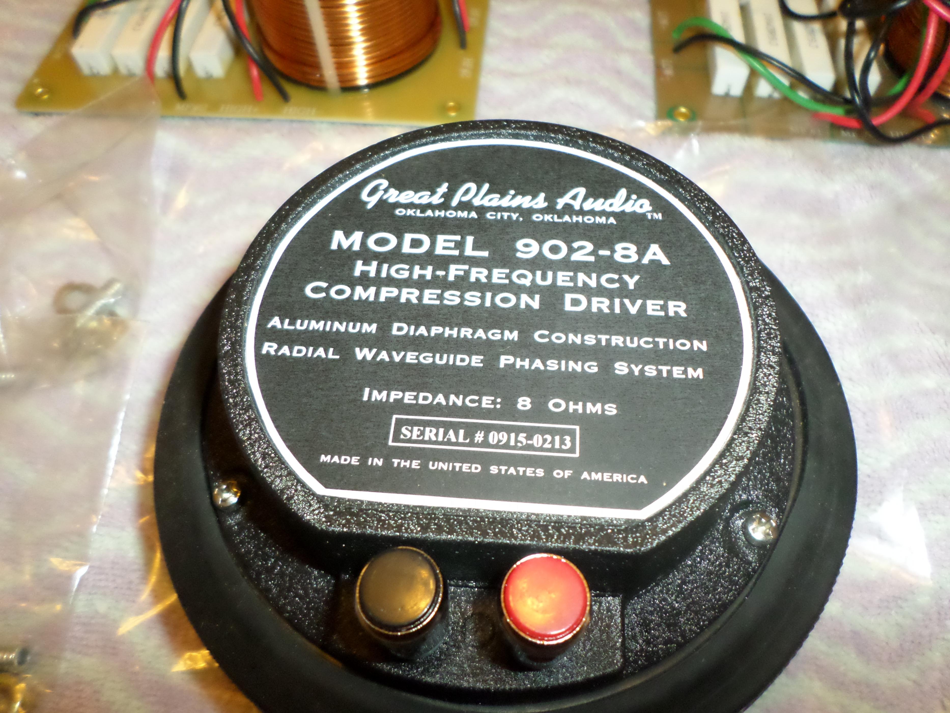

I found Great Plains Audio.. They repair vintage Altec speaker drivers... I did not know they also make new replacement drivers for the old speakers..
So... I emailed Great Plains audio and Bill From Great Plains returned my email...I asked Bill if there was replacement parts available to build a set of new Altec 19s..... Bill said everything was available except the 811B horns.. They are no longer made...

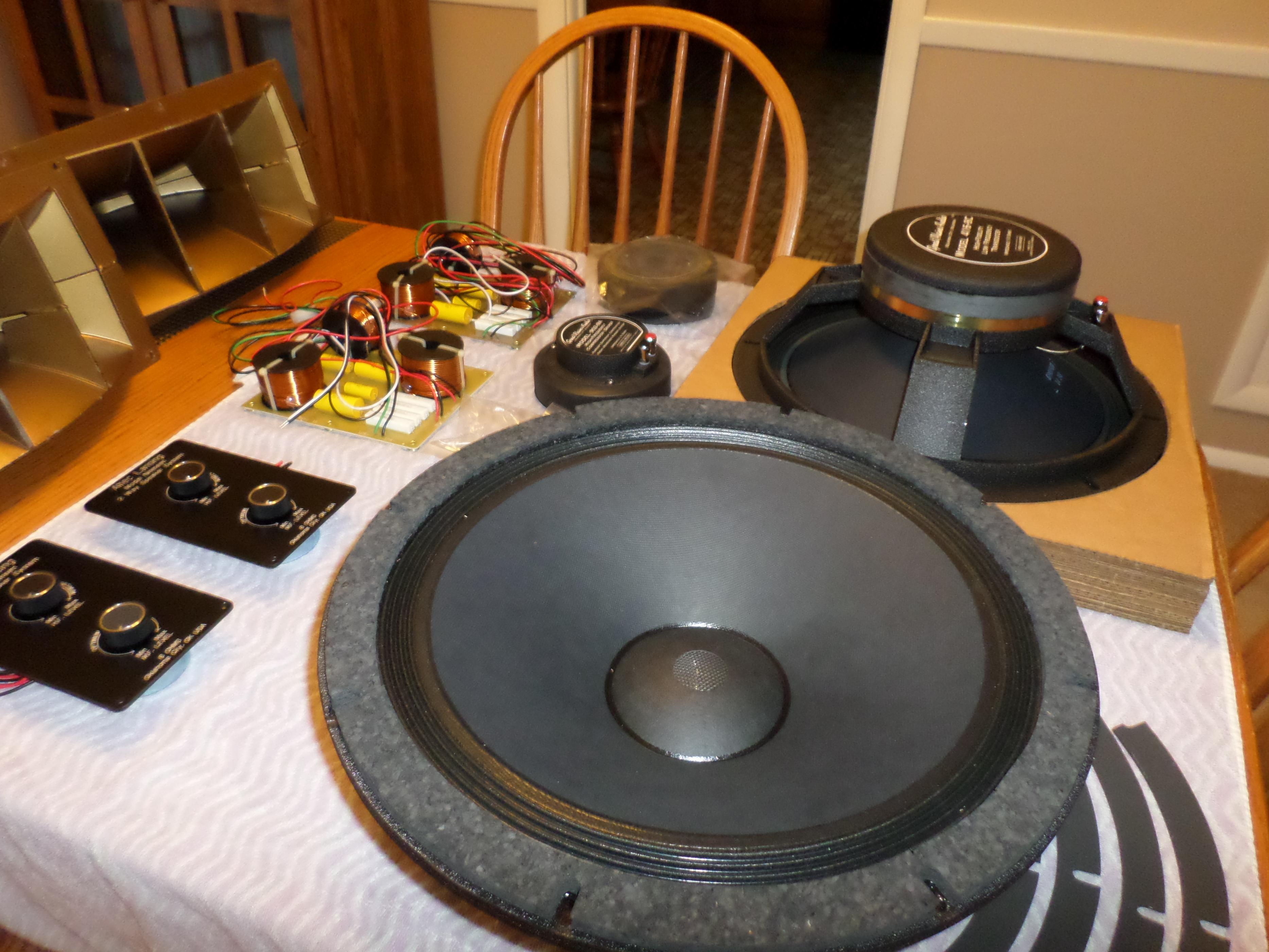

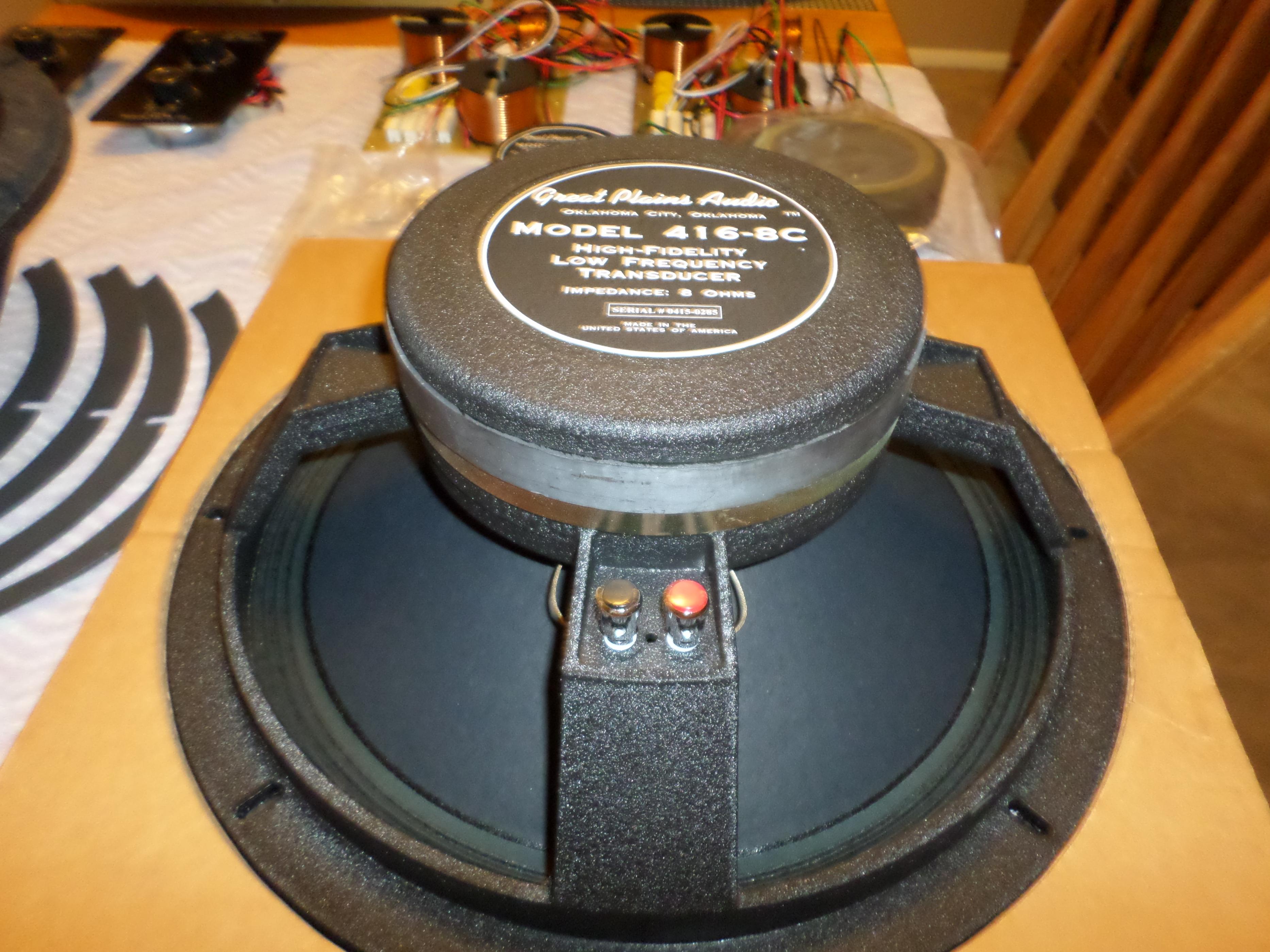

So I found a set of 811B horns on craigs list.. Then I ordered the new Altec 19 drivers and crossovers...
Great Plains Audio sent everything fast !! I opend up the boxes and this was better than Christmas !! The 416-8C and the 902-8A and the N1200-8A was all first class parts... !! and the packing was 100% to keep everything safe..
I did not have the cabinets yet.. but I could not wait..
I had some large speaker boxes i was going to throw away so i just put everything in them till the cabinets are done..(they are ugly)
I hooked them up... I have a old Nad 40 w power amp and a Carver CT27v preamp..
The source is just hooked to the Samsung tv.
Its the same sound as I remembered...The horn driver is amazing... I think it also has to do with the crossover... I cant seem to turn it off at night !!

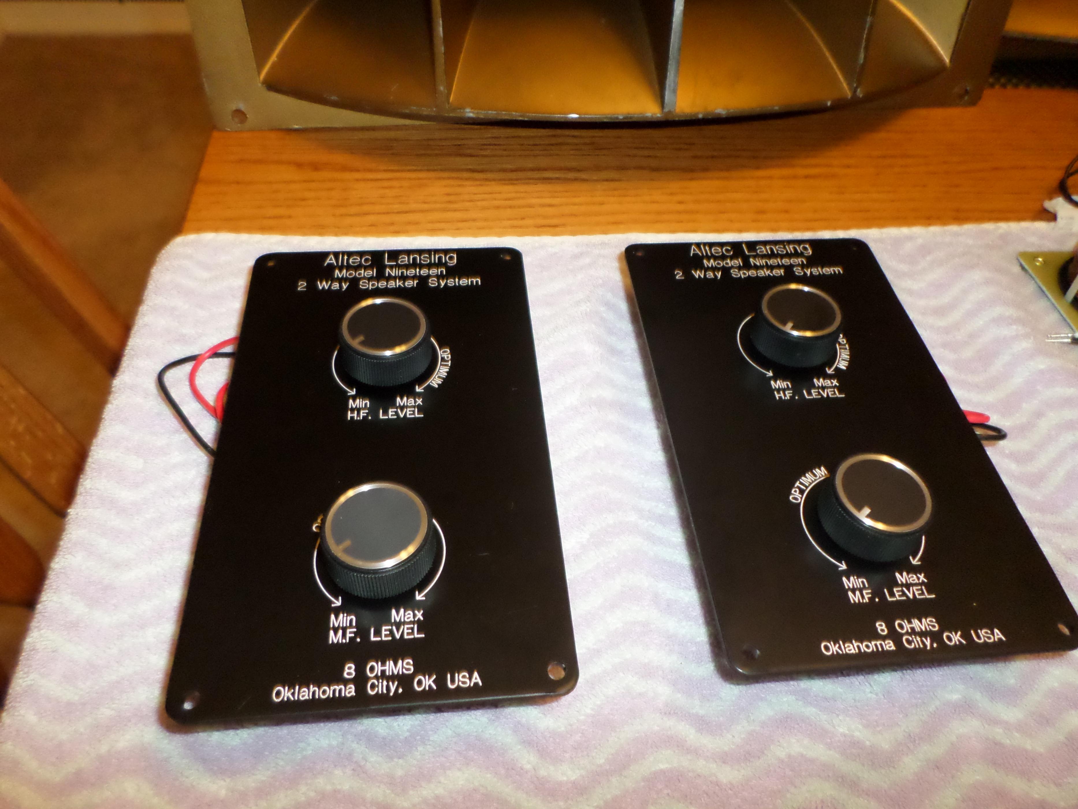

I cant wait till they have a new home... I ordered Altec 19 style custom cabinets from the Amish,, made with Elm wood to match some other peices I had built..
I Think I made the right choice.. The horn sounds really smooth and the high end is great...bass is awesome.. clean...

I will post pictures for everyone when they are in the new cabinets... but they are not going to be finished for 90 days... So hang in there..I will post many photos....!! Thats how long it normally takes when I have the amish build something.
They will be 100% just like the original 19s except for where the speaker connections are.. And most of the cabs will be 3/8 plywood and 3/8 hardwood elm... so they will be solid !! I would have had used all hardwood elm but... I think the marine grade plywood will make it more solid...

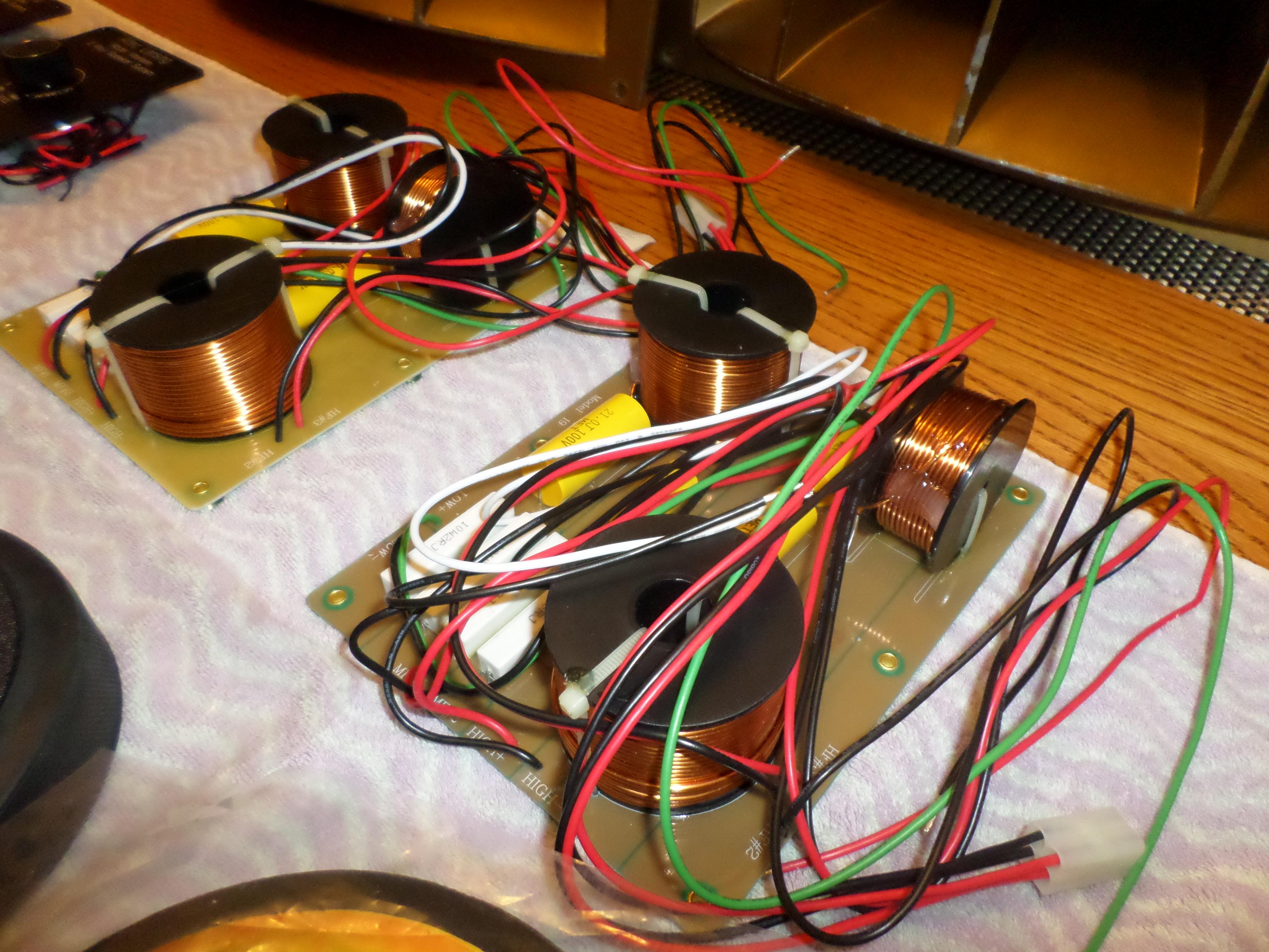

The parts at Great Plains Audio is the best.. when I opened the crossovers they are impressive looking !! I know its just 2 horn drivers 2 crossovers and 2 woofers.. but the quality .. ohhh I have a photo... I will upload now.

The crossover...i am an electronic tech...and to put a electronic crossover on these and get better sound,??? adjusting for low volumes,, midrange,,crossover frequencys,,gain in 2 different amps at different levels which change with freq... and there is phazing at the crossover point...which amps do I use... ?? which electronic crossovers will work best...??
The whole reason for the altec drivers and the same new altec 19 crossovers is so 99% of the thinking is done... (i'm smart but not that smart)when you change to much then its not a altec 19...
