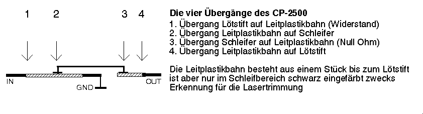

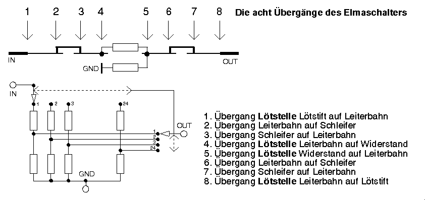

A stepped stereo pot can be bought for around 150 USD here in Sweden and or Germany or Denmark. Assembled. SMD or ordinary resistors.
What I do not like about stepped pots is all the connections that a stepped pot has.
See this drawing:
To compare this with a normal pot:
Sigurd
See this drawing:
Sigurd
