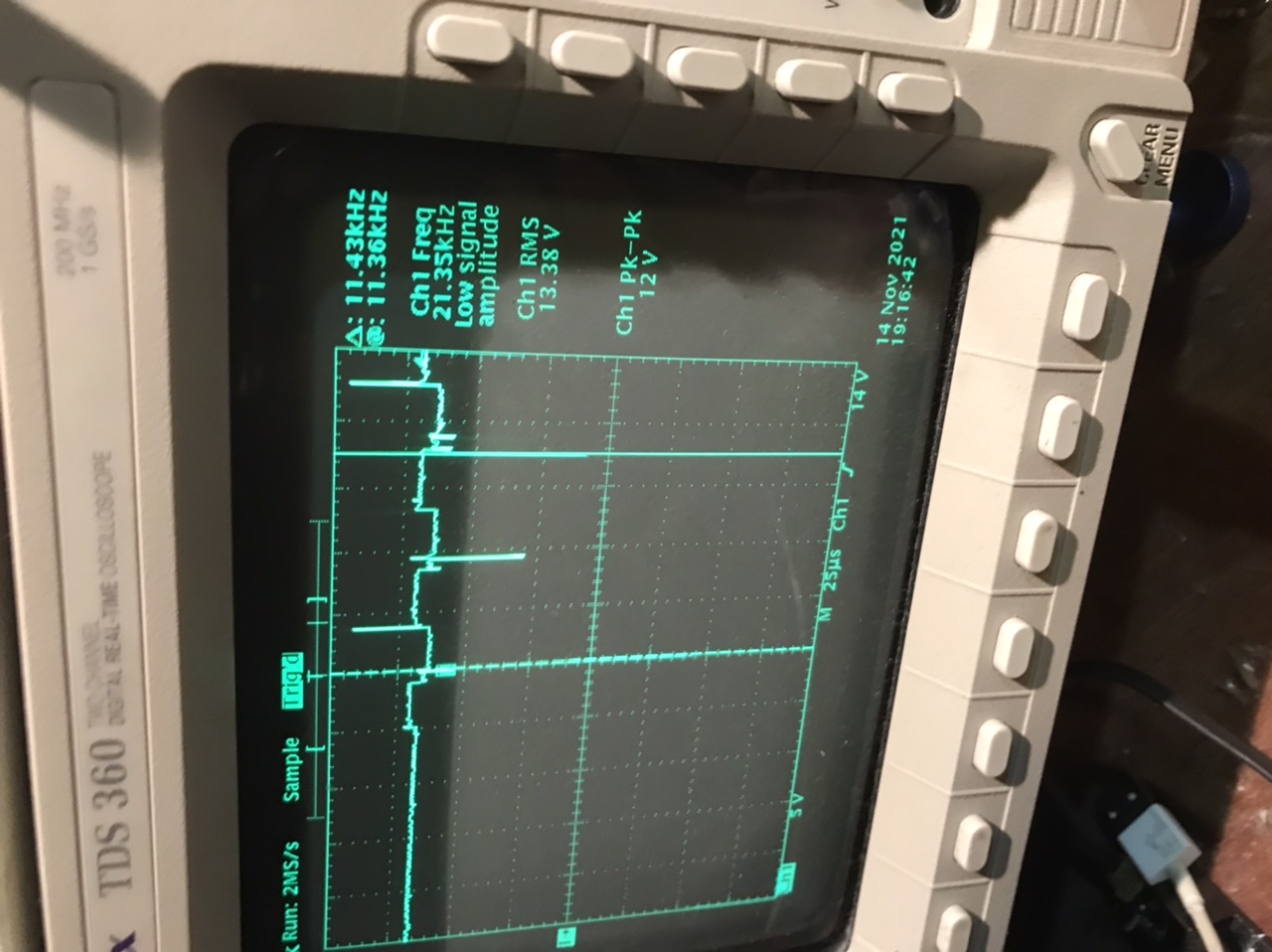

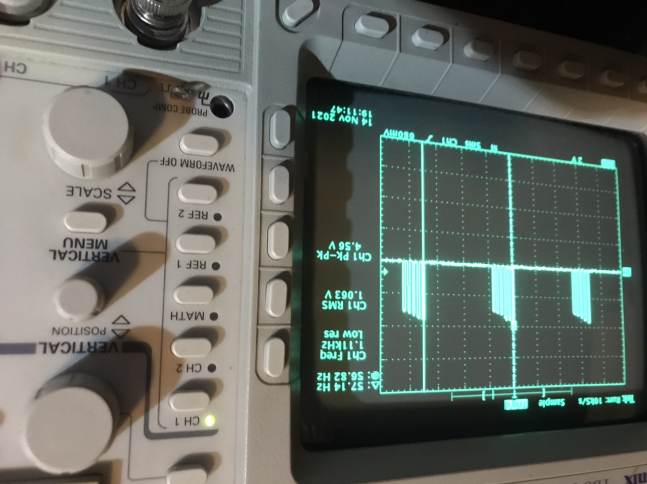

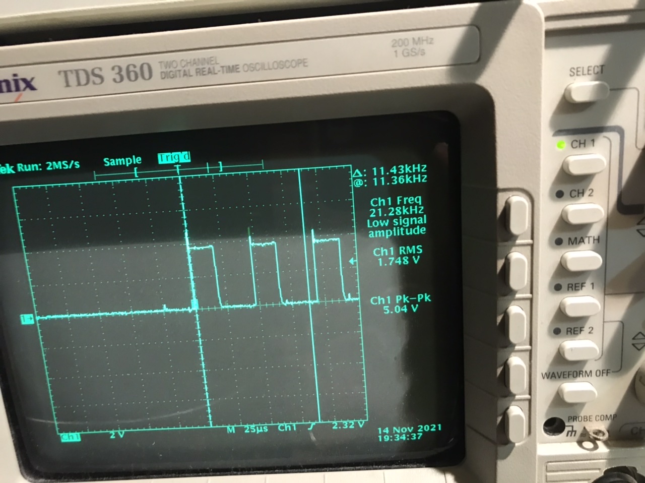

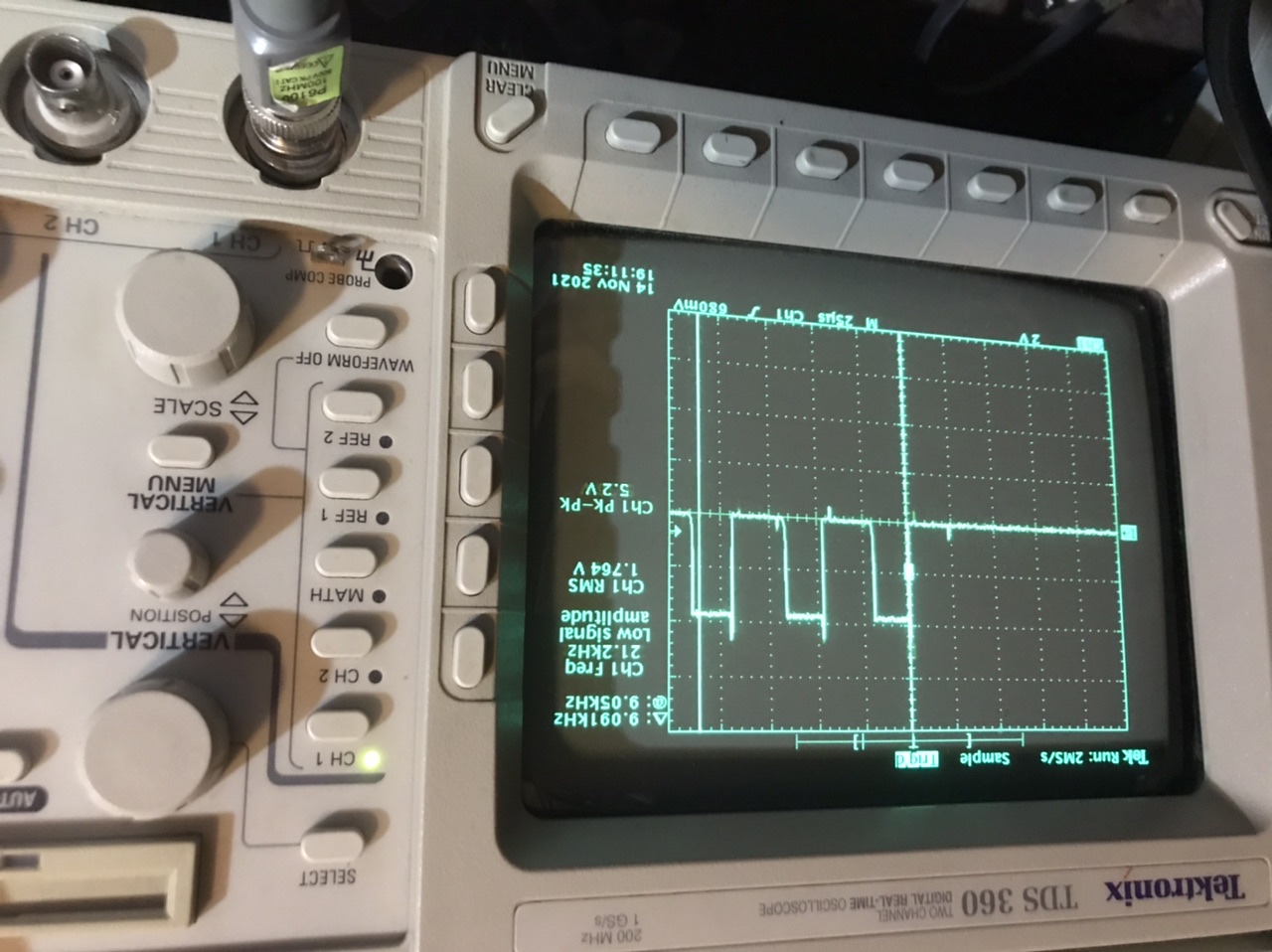

I’ve finally gotten around to replacing the dead outputs and leaked primary side capacitors in my old T707 and it won’t start up.
The power light comes on, a get a sawtooth wave from the tl494 but the output square wave won’t stay constant. It powers up in little burst and then dies down again.
Im pretty sure the output section is fine, any pointers on why this could be?
Would appreciate a service manual if anyone has one.
The rail voltage is +-0.6v or one diode drop. I pulled and tested the ps mosfets out of circuit but that seems to imply that there is a fault in the power supply still?
I have the burst of square wave on the mosfet gates, 12v on the drains but nothing beyond some small high frequency spikes on the source.
The rail voltage is likely regulated. Reduce the 12v supply voltage. Does that increase the pulse width of the square wave?
No change until about 9 volts, where it drops out completely.
The duty cycle looks to be pretty close to 50% and the burst repeat at around 45hz.
