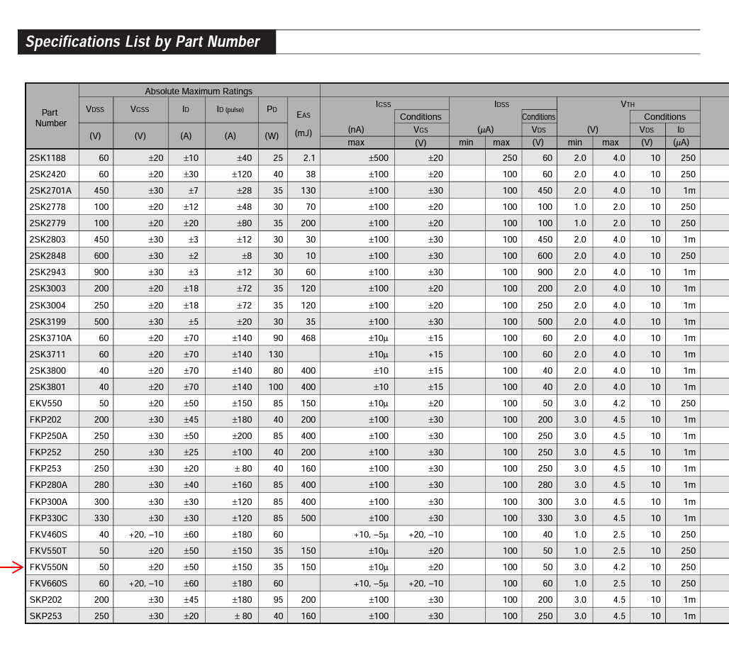

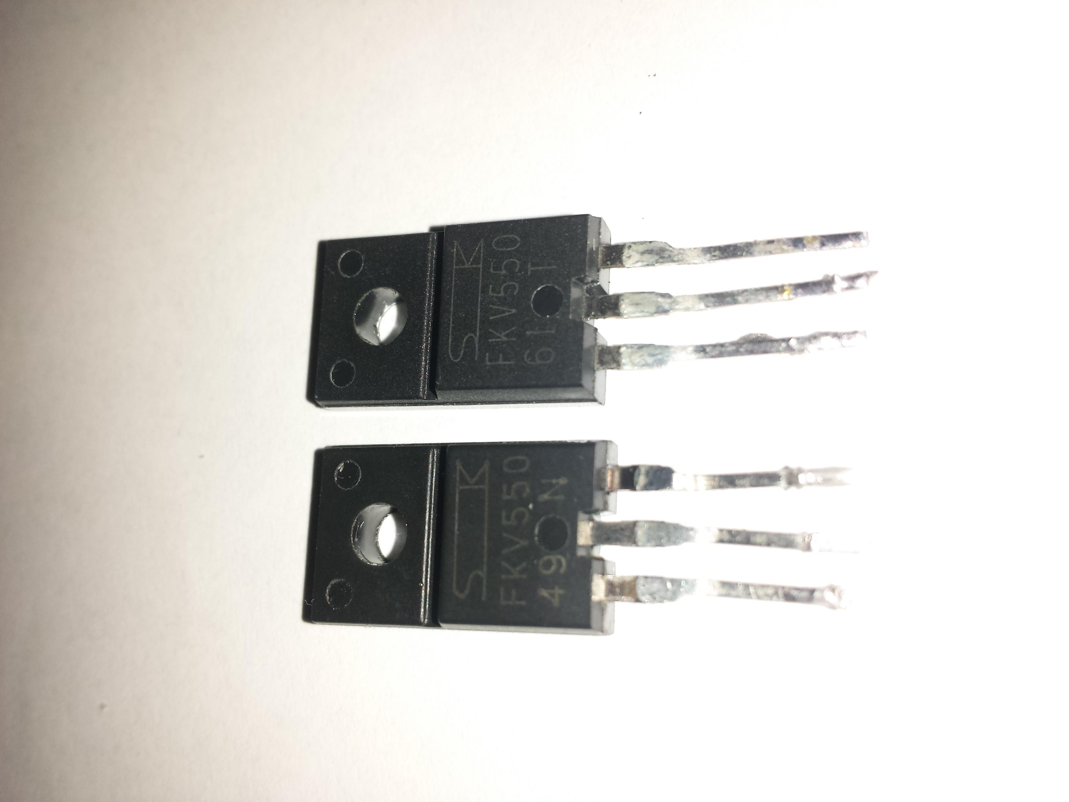

ok well this is what I thought, production code, but I've got a data sheet on the fkv-550 t and fkv-550 n and the difference is something in the gate voltage, I'm wondering if the t and the n are actually different part numbers and therefore I'm getting some overlap somehow in the power supply, its strange because the t is rated lower gate voltage. and the reason I say all of this is yes the amp has dual power supplys , it has 4 fkv,s per supply, but I still have 4 good fkv550n,s and if I power the amp up with just those 4 it powers up one power supply fine, +37 -37v but then I can take those 4 out put 4 of the fkv550t,s in and as soon as they start switching they start burning up and the voltage starts drooping, the gate voltage is fine at 5.20v at 26hz I think, and I know the fkv550t,s are good because I just put them back into the kenwood amp they came from and it works, next in going to measure the gate voltage in the kenwood, maybe they are pro codes but they came from the factory with slightly different carachteristics so they had to make a different data sheet? I'm not sure on this one all I know is I have a fkv550t and fkv550n datasheet and they different, and I never would have thought the t or n down where its printed would be anything to do with the data, ill post the outputs too because there is numbers on the bottom of them and the funny bit is the ones with the other numbers run the lower power ch 1,2 on the amp, which has 4 output transistors compared to the 3,4 channel which has 8
Have to admit that that does point to a difference... if if it works OK with one variant and not the other.
You need to look at the actual gate drive voltage available from whatever drives these FET's and compare with the data sheet. Look to see at what Vgs the device is guaranteed to be fully conducting and see how that compares to the data sheets. If the gate drive is insufficient to fully turn on the FET's then will be operating partly in a linear mode and that would explain the heat generation.

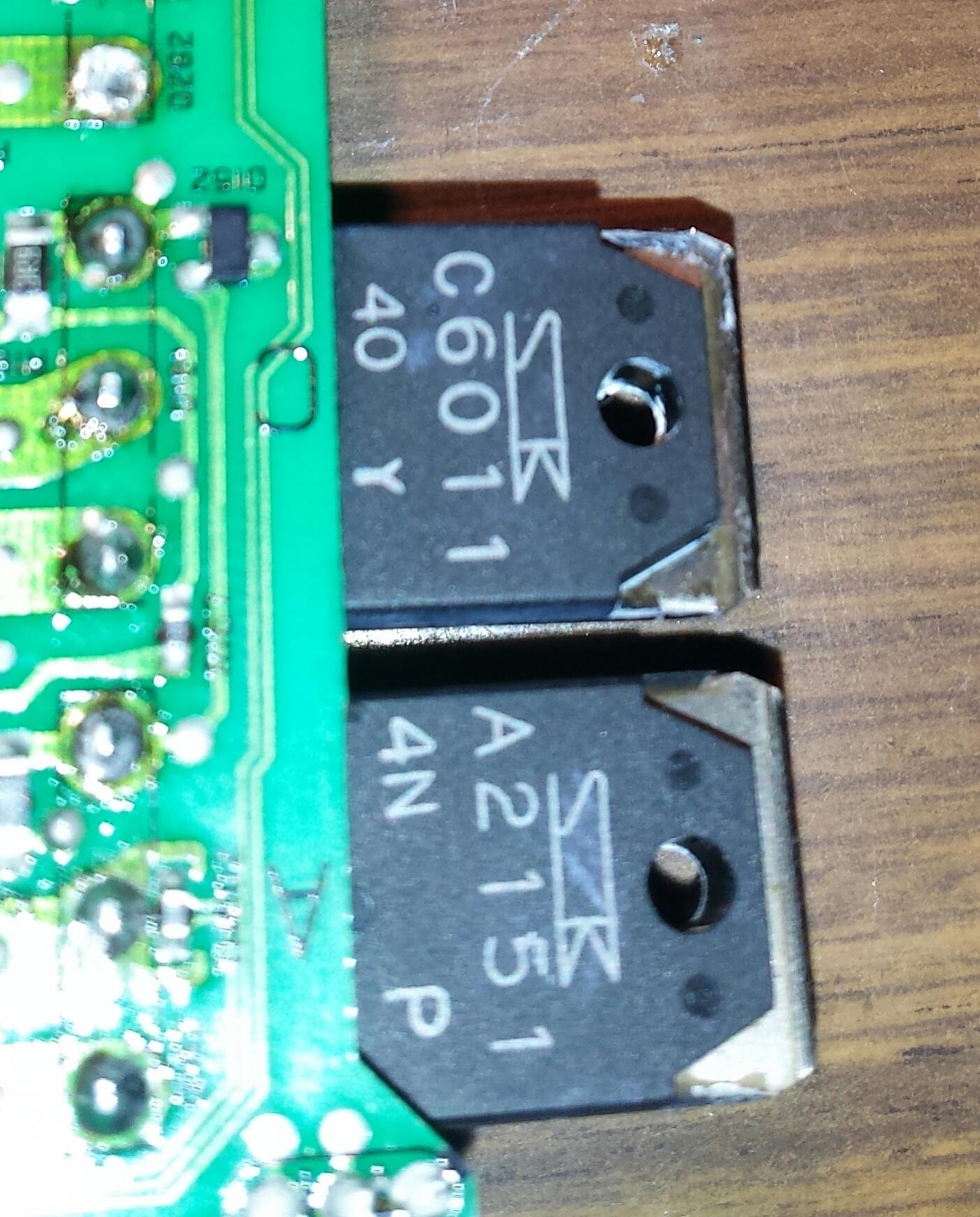

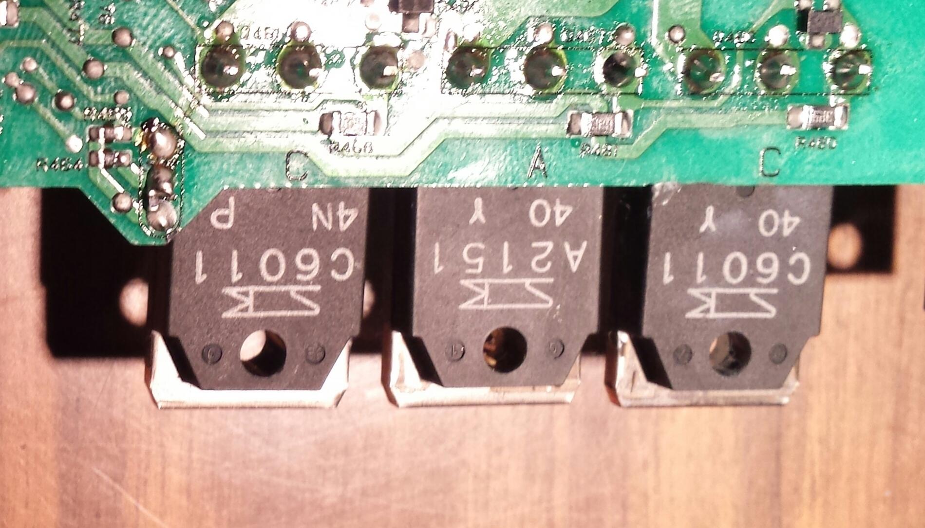

here are the outputs, notice the 4n p and 40 y on the bottom, there is 2 a,s and 2 c,s with one number for the small channels and 4 and 4 of the other for the other larger 2 channels, these ones might be nothing but I just want make sure before I replace the one blown one
They might refer to gain groups (hfe range) but whether its of importance I wouldn't like to say. For devices that are in parallel matching helps ensure current sharing etween devices.
I'm thinking probably the same with the outputs, even though both are full range outputs, one is bridgable and more than likely is going to be used as a sub channel, I'm still learning some basics so excuse me if I ask or say something noobish,

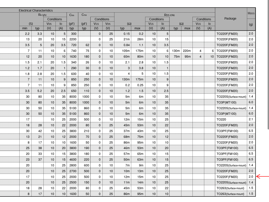

That shows the T version will operate in saturated mode with a much lower gate drive voltage than the N version. Looks as though that is the reason for the overheating. I'm guessing the drive voltage is from 5 volt logic for that to happen.

Matching of transistors comes into its own when they are operated in parallel. Fo all the devices to share equally so that none hog the current and overheat and fail its important to match them, more so between the same device types rather than NPN vs PNP

Hmmm... little difference there other than the turn on voltage we mentioned before. The T version has slightly higher transconductance (the FET equivalence... well sort of... of gain) and slightly lower guaranteed on resistance, 10 to 13mΩ vs 12 to 15mΩ.
It seems like its going to be the turn on volts thats the critical parameter here.

I'm not too sure exactly how to read it with my dmm but by memory it read 5.20volts dc at the gates, I flicked it to hz reading and it said 26hz I think, so yeah my quess was the t,s were overlapping or whatever the term is, makes sense cause the voltage dropped from 12 to like 7 real quick as the power supply started, ill do a test on the kenwood amp the t,s came out of and see what thats saying I might be able to change the gate resistors maybe, I noticed the kenwood is also running the same TL-594 pwm chip
A DVM isn't really suited to measuring things like this, you need a scope. Switching supplies run at many kHz (anywhere from 30kHz to several hundred kHz). Overlap or cross conduction occurs when there is insufficient "dead time" (a period when neither FET conducts). Again, a scope is needed to see whats going on.
