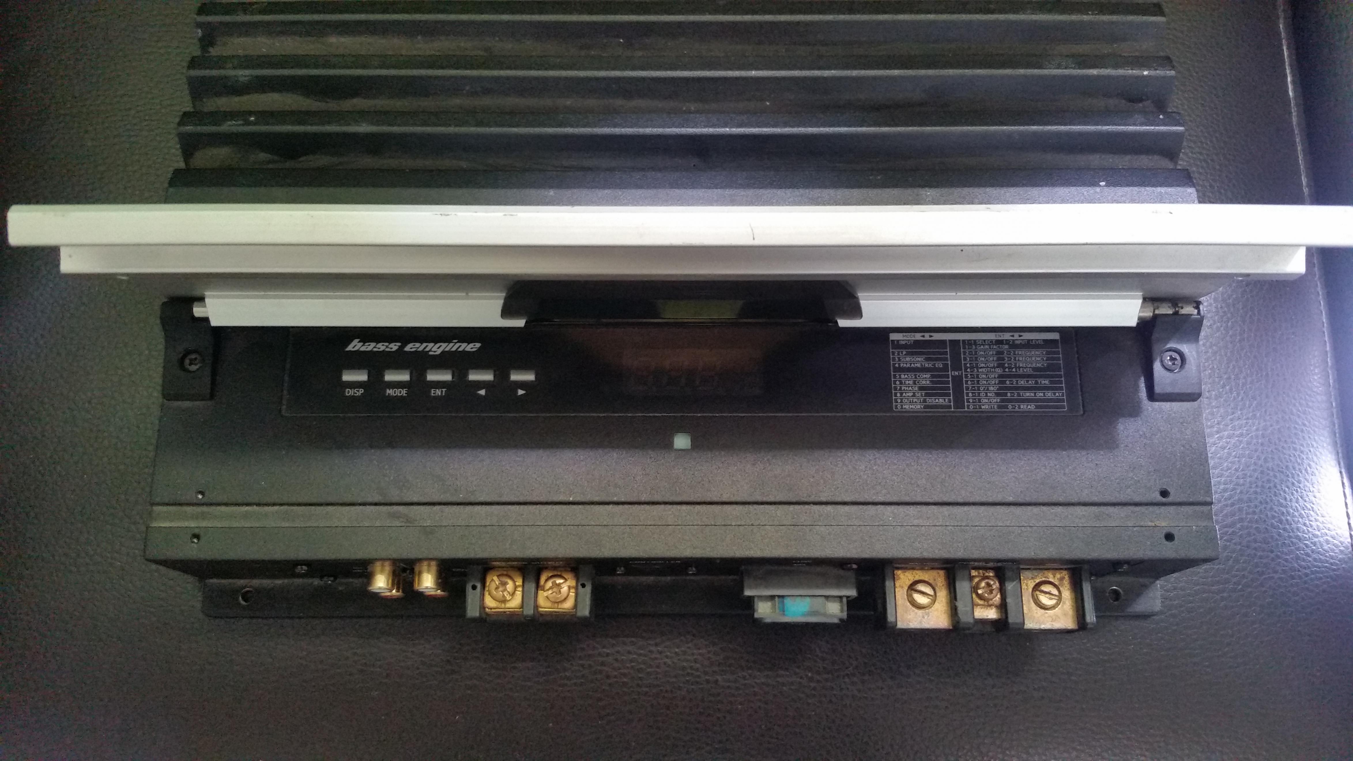

hello friends again turning to you, this time I got an amplifier of the Alpine brand in the model mdr-m500 the problem here is that the blue LED lights up the screen ... so everything is normal but there is no sound in the Departures. already check the exit section and all the fets are ok any suggestions greetings

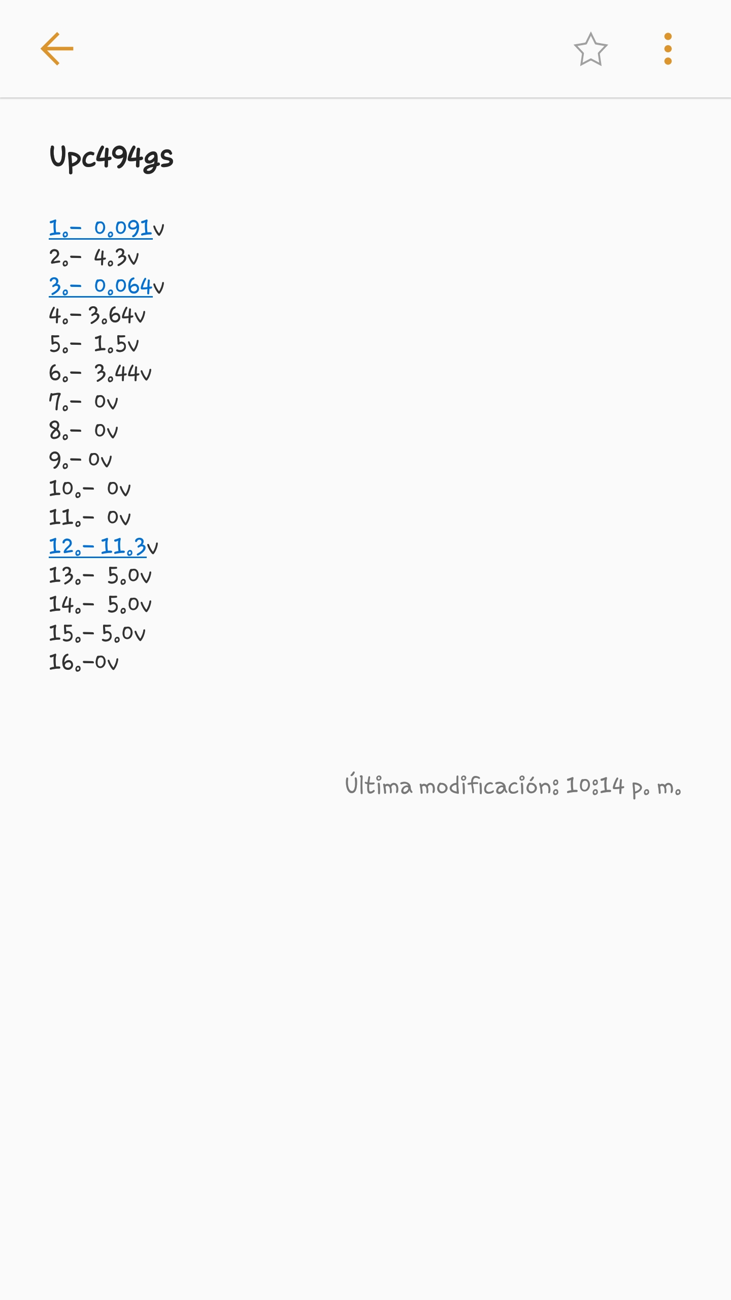

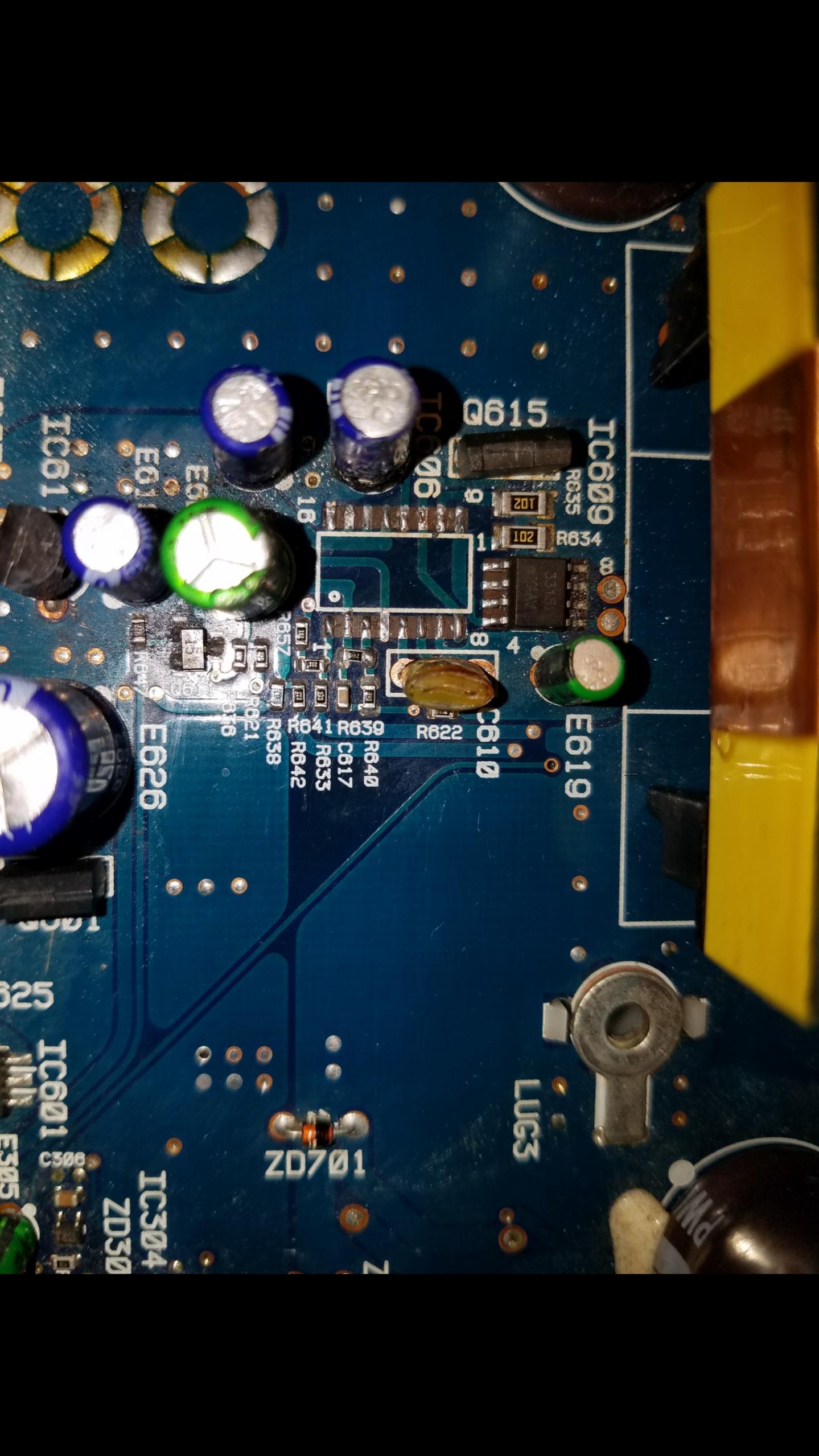

Hello friend Perry you ask thousand apologies for not follow the subject I frustrates with this amplifier, today I decided to return the matter. Good you commented I find myself with the upc494gs does not work or not generates oscillation to connect the remote pins 8 and 11 the 494 up to 12v but a second after falls and simply not ranges so I don't have already or pulse I hope I can help awakening this Alpine
of course I had them, but I stop working and now the upc494gs does not turn on, if it reaches 12v to pin 12
I'm having trouble understanding what you're trying to say. The language barrier may be too great.
I think you would have to post the DC voltage on all terminals of the 494 when it fails to produce rail voltage.
With the black probe on the main ground, what is the DC voltage on the B+ and remote terminals?
Can you increase the supply voltage to about 13.5v?
