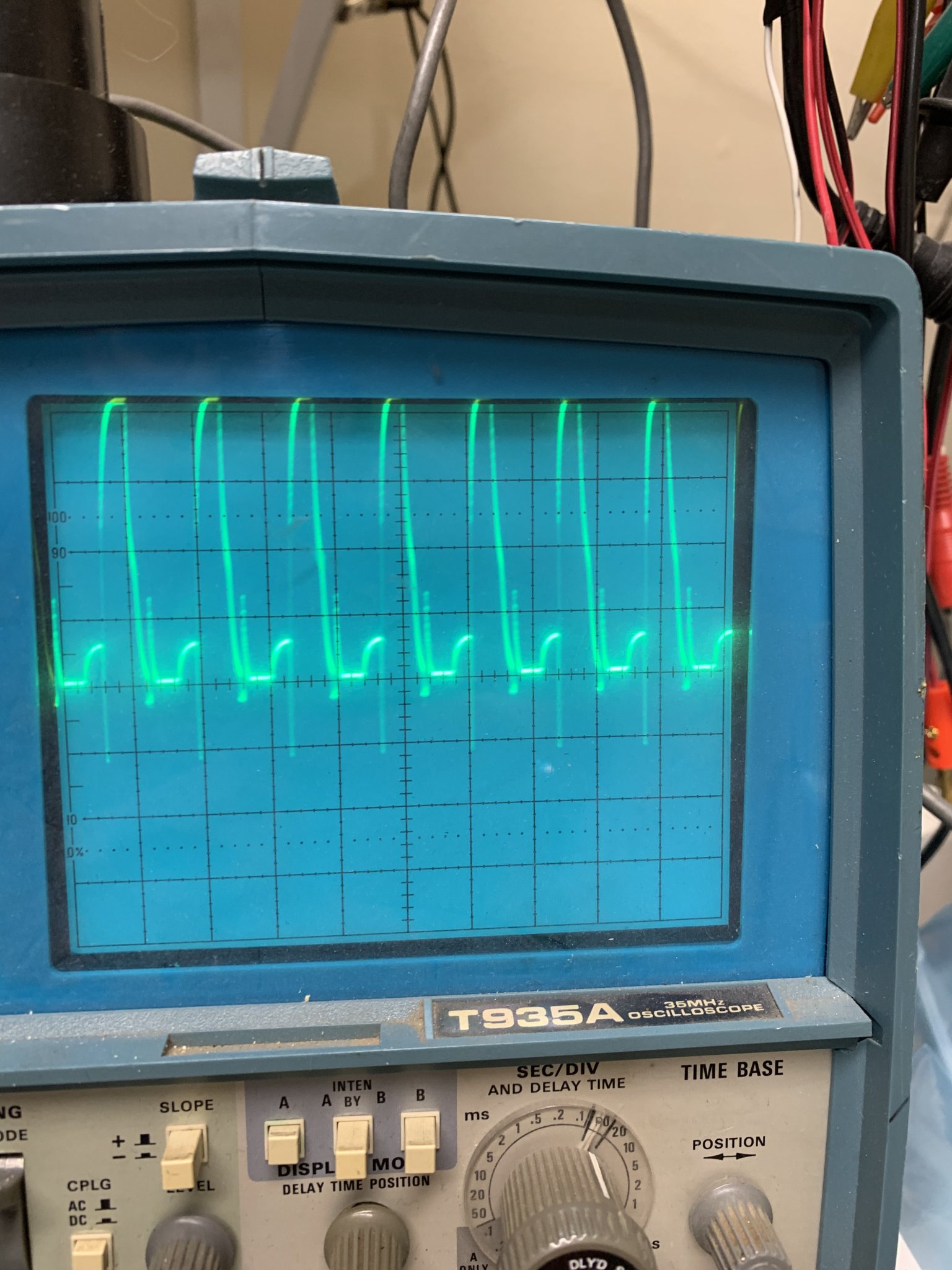

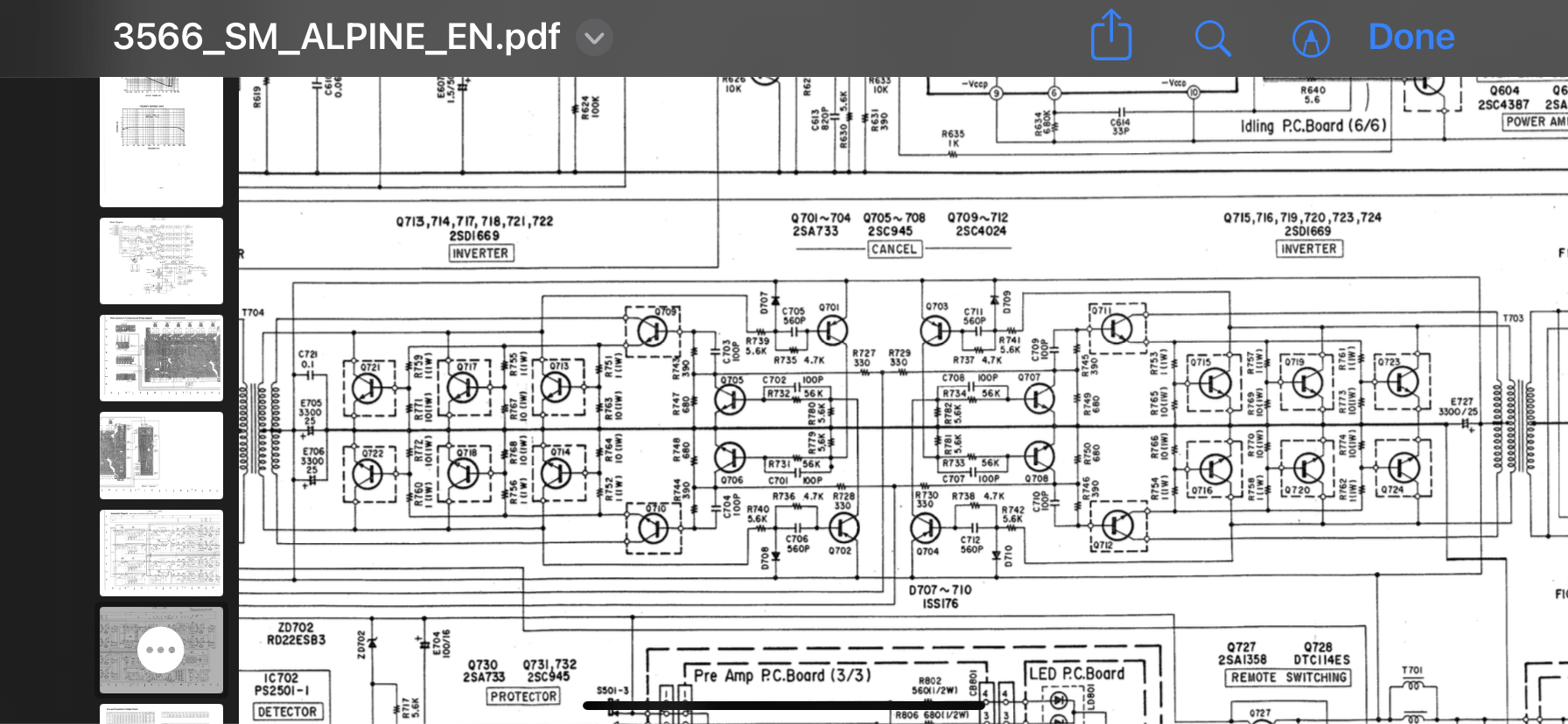

I completely replaced all electrolytic caps in the amp. The amp now powers up but goes into protection mode for about four minutes, then the protection led goes green and the amp provides audio. The four 2SC4024 transistors in the "cancel" circuit of the inverter get quite warm after a few minutes , I then pull power away to eliminate any further damage. I probed the uPC4094C chip . Pin 5 has a sawtooth pattern, both pins 9 and 10 have the square wave but the wave looks distorted to me. pins 13 and 14 have 5 volts. I have since taken out the rectifiers to disconnect the power supply from the output section. The protection led immediately goes green and the power section stays on. The four 2SC4024 transistors only get warm now but the square wave still concerns me. Any ideas on what to check? Thank you.
What does the square wave look like on the gate legs of the PS FETs?
Align the trace to the reference line on the scope before posting any more waveforms.

I centered the scope. Wave form shown at the base of 2SC4024

When rectifiers are installed the protect circuit goes on and off for about 2 minutes then goes green and stays on. Q709-712 get very warm. Audio on all channels sounds clear. Not how I believe the amp should operate.
