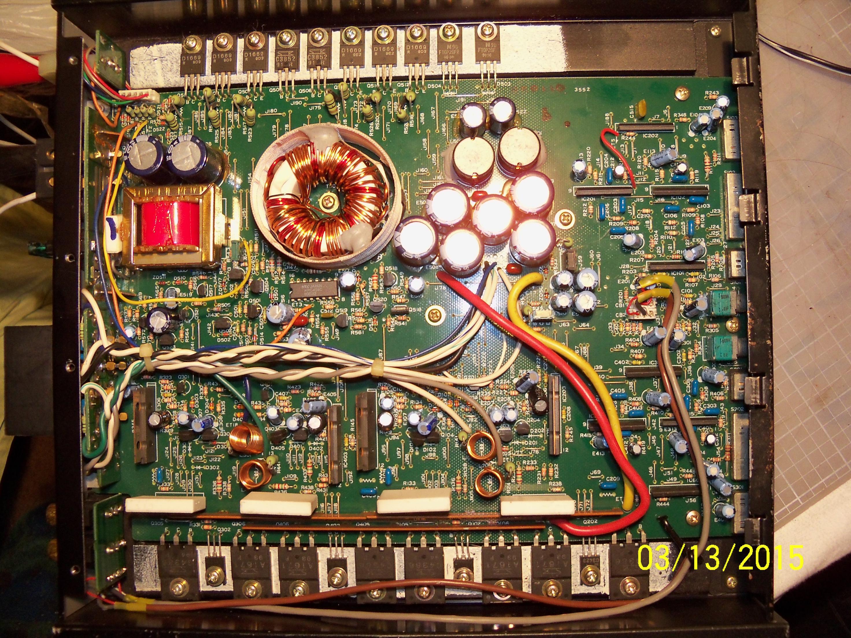

Hi,,thanks for the info...here are the photos of the inside..It has plates that are above the rest of the top of the amp..if that is what you mean by risers then yes is has them..
I am more of a laptop computer repair person..but know alot about electronics..

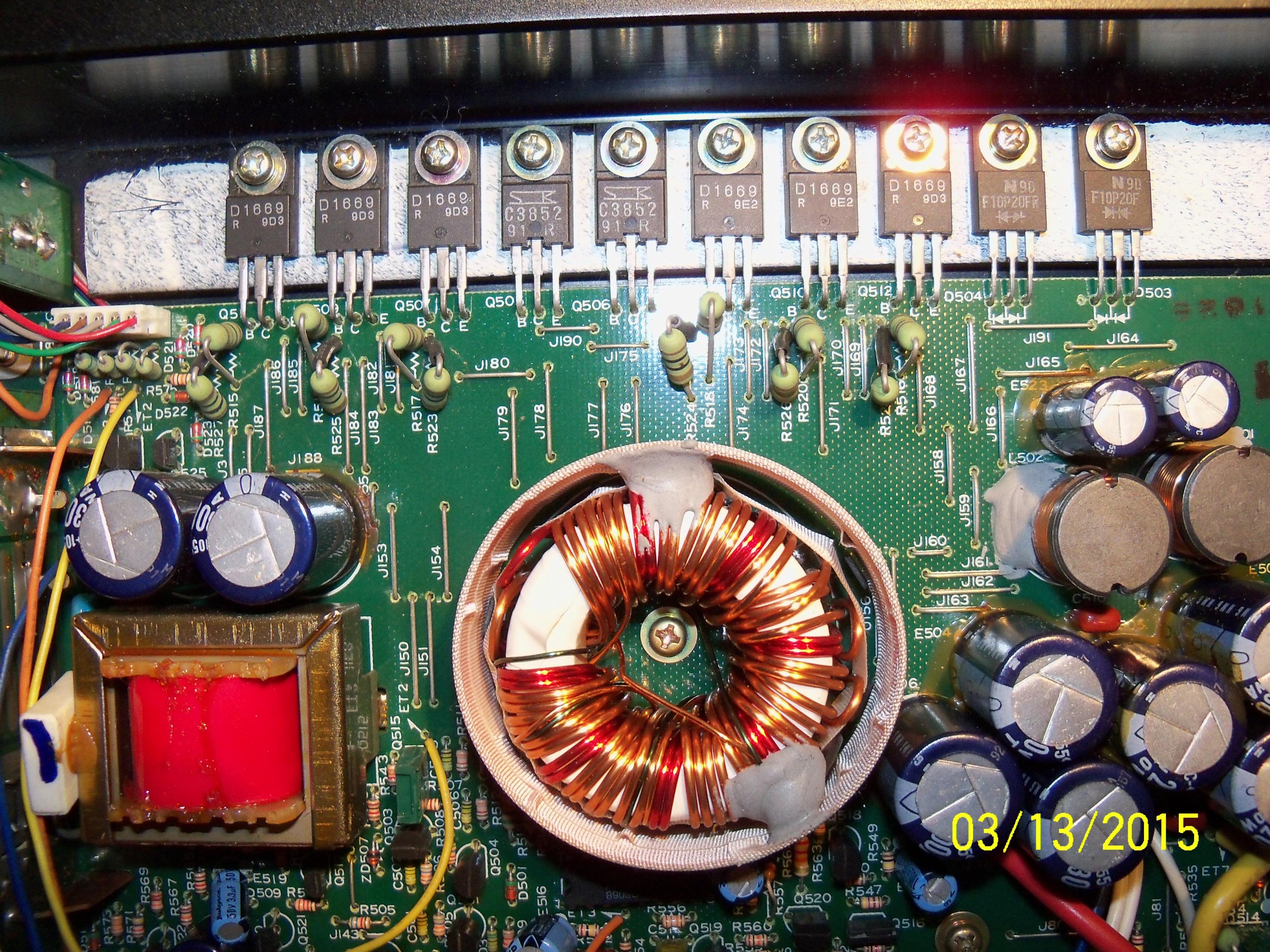

Thanks for the info...there are two (fets I guess) that have numbers of C3852 and I have checked Google and it says they are "pillows" I have no idea what that is..

There are few far east sellers who are selling legitimate parts. The ones that are long discontinued are almost always counterfeit.
None of the transistors you listed are FETs. They're bipolar junction transistors (BJTs or simply 'transistors'. 'Pillow' sounds like a bad translation.
Cutting those transistors out removed the part of the circuit that generates the pulses to drive the transformer. It's about the same as pulling the fuses.

I have also learned that the smaller transistors in between the output transistors are for temperature monitoring..to keep the output transistors from overheating..and to balance the output..current I think..
I tested the power sides controller IC the PS494C from NEC, I believe..and got all the right voltages out of the pins. I checked it the same way you would check the TL594 chip in the article you showed me..

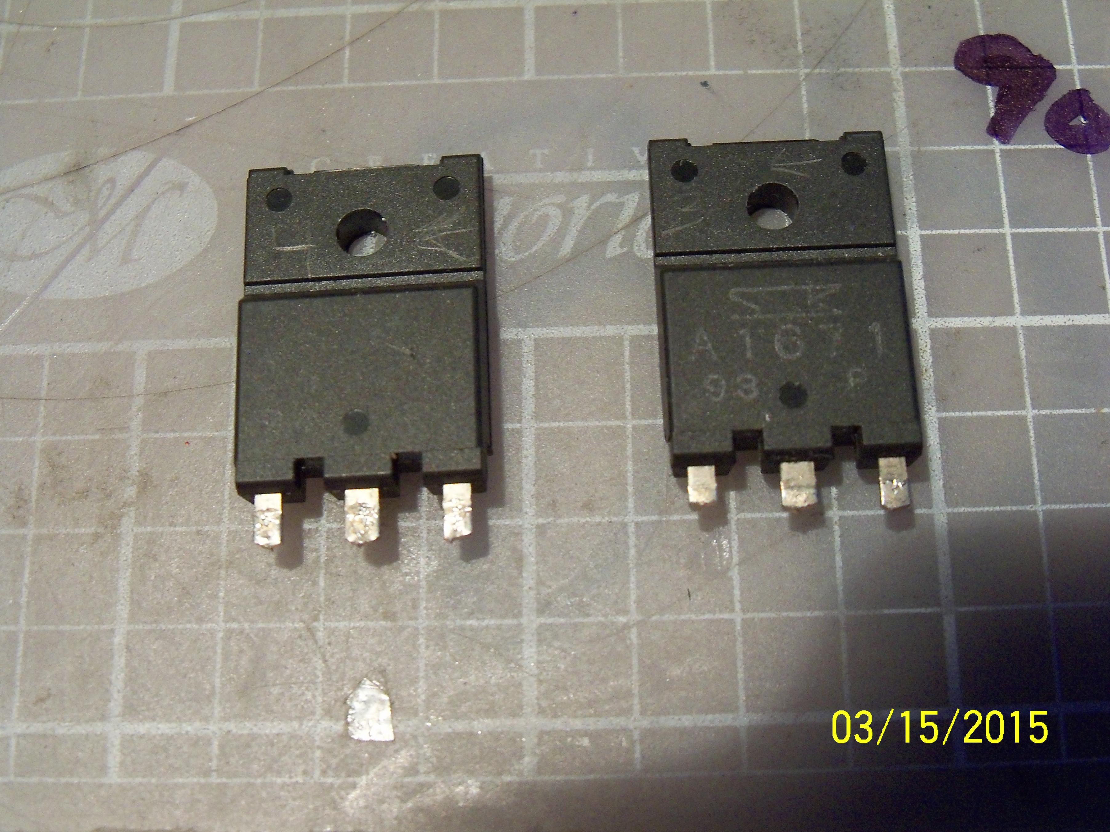

Here are the bad parts..
Can you mix part numbers for these...I know you probley shouldn't...maybe on each channel use the same part number..but can mix different numbers on different channels..does this make since???
Got it all back together except these two parts..ran it for an hour...it draws around 3-4 amps..idle, with no input...just the gains almost all the way up..

Here is what it looked like before I started..
The bottom transistors, the 3rd and 4th from the bottom left...are the one's that are bad..
