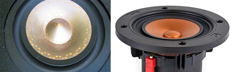

1st let me say that i wish Mark Audio would start calling these Copper rather than using the Gold left over on boxes from the 1st generation.
Gold A6 1st gen vrs copper A7.3.
The A7.3 is my favortite Mark Audio driver (allthou we always EnABL ours), and ignoring the A7 MOAP). The current generation metal A10 almost rises to the same level of mid/top and DDR (downward dyanamic range, think detail) of the A7.3. For most users the extra bass of the A10 makes more difference… one needs a front end also with good DDR to realize the benefits of the A7.3.

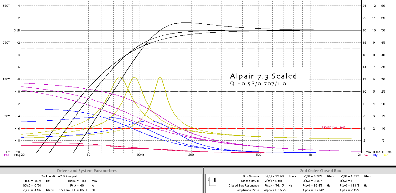

Just curious about your comment on 9-10 liters being optimum for 7.3. Optimum for your aperiodic marken enclosures or sealed or what? I'm curious what makes that size optimum. I'm thinking of an aperiodic using one of those scan speak vents and still scratching my head about best volume enclosure. I'm going to hand over the bass duties to another driver at around 60-70Hz.
I am talking about optimum for my miniOnken alignment where i am looking for a very specific curve that i approximate the added LF attenuation of the resistive vents. The shape i look for has a bit of a bump before rolloff and has a 1st derivative of the FR that only crosses zero once.
You are on your own as far as variovents go. When i have done boxes that emulate the use of a variovent i made a too small sealed box and then tune the vent. Looks like you could usea 2 litre box with this approach. At that side i’d worry about early sidewall reflections back thru the cone.
dave
dave
Thanks Dave that's helpful information, definitely want to avoid any reflections back through the cone. Looking at your chart what I'm thinking now is just make a size I can live with sealed (that 6.385 liter looks good) and try the vent and if i don't like it just seal it up again.
That size gives a max-flat butterworth roll-off and F10 in the high 50s. We have sone successful 4.7 litre vented boxes a vent could be added — noteworthy that this box did not sound quite as open as the larger boxes, likely due to the early reflections off the sidewalls. Keep in mind that stuffing will increase the aparent size of your box.
