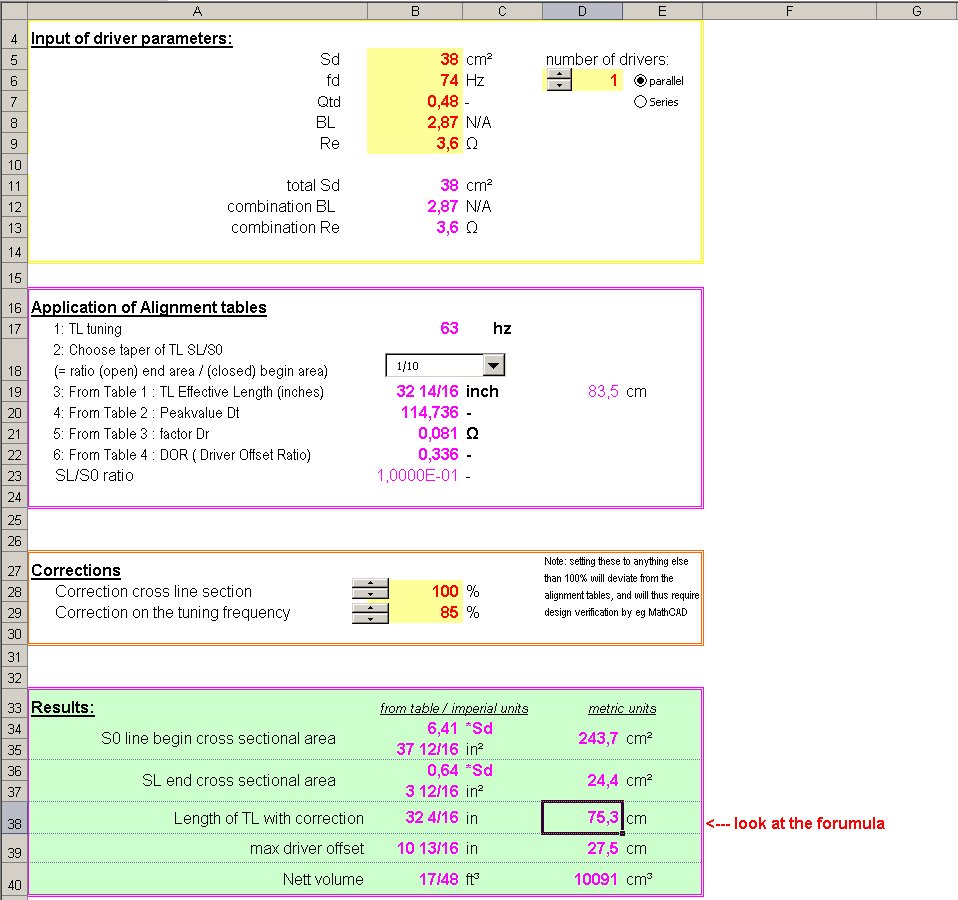

PS: I tried to enter the T/S-Parameters of the Alpair5 into the excel sheet provided here: http://www.diyaudio.com/forums/full-range/162362-help-new-guy-tl-enclosure.html
But the results for S0,SL and length greatly differs from those I measured from the Alp5-TL construction plan. But I couldn't find out what the TL's tuning frequency is (maybe around 70Hz). I guess it's far below the drivers fres (125Hz). If this is the case, shouldn't be that big difference a problem concerning the whole TL principles?

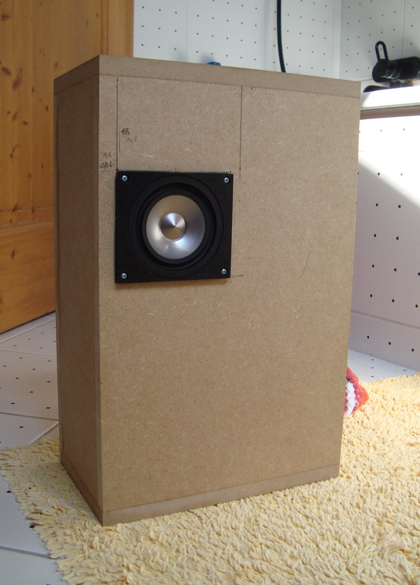

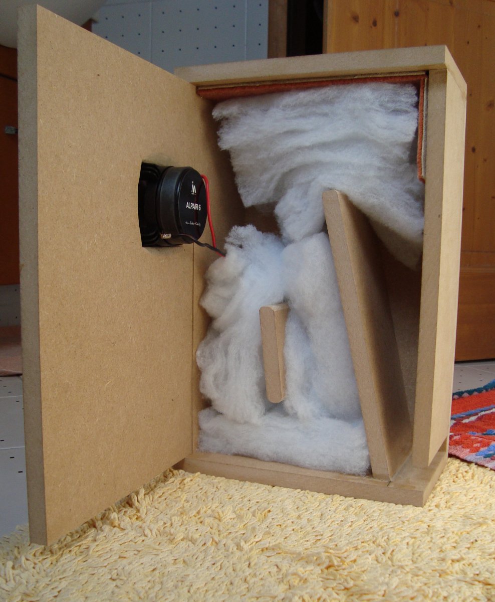

In the meantime I tried my luck with my own design and already finished the prototype speaker box.
I'll post all relevant stuff tommorow, so maybe we compare it than.
(I didn't have the "King Sheets" btw, just the excel, so it's gettin interesting 😉 )
I'm quite happy with the result - after changing the sonofil stuffing a few times. My prototype still isn't going as deep as the needle, but having a peak at ~55Hz. After 55Hz the pressure level is going down and hits the same level at ~90Hz. This behaviour is a little annoying... missing many of the fundamental tones, the needle on the other hand sounds a little fatter.

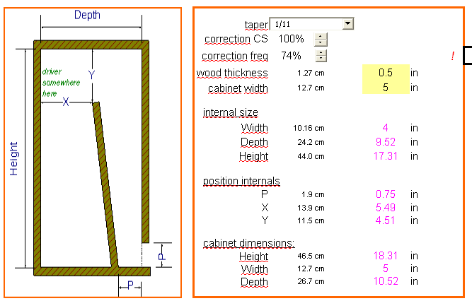

Here are two photos and the excel tables.
The design is quite like the alpair5 desktop tl. I point to the driver position. I guess it's not a big problem if you shift the mounting of the driver from one side to another, as long as the position on the line length is garranteed.
To the excel table - I brought in a limiting factor to the "line length" because of the dampening material. I hope this wasn't a mistake.
But I guessed that at this point the dampening isn't taken into account by the excel sheet.
@planet10:
The el70 design I considered too big for my desk.
It has to be quite flat (16cm max) and max. 43 cm high. The front aspect wasn't of much interest but the excel sheet tended to the golden ratio...

PS.: I had a small error in my excel sheet. The description for the fields "Correction cross line section" and "Correction of the tuning frequency" were switched. I don't know if this had been fixed at this point.
