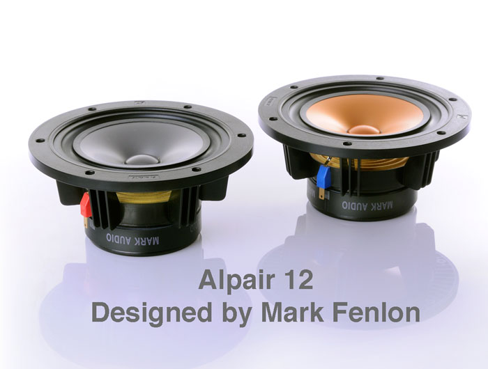

And for those who've asked me about the new big driver, here's the Alpair 12 pre-production information.
Will do a proper post in Vendors later next month.

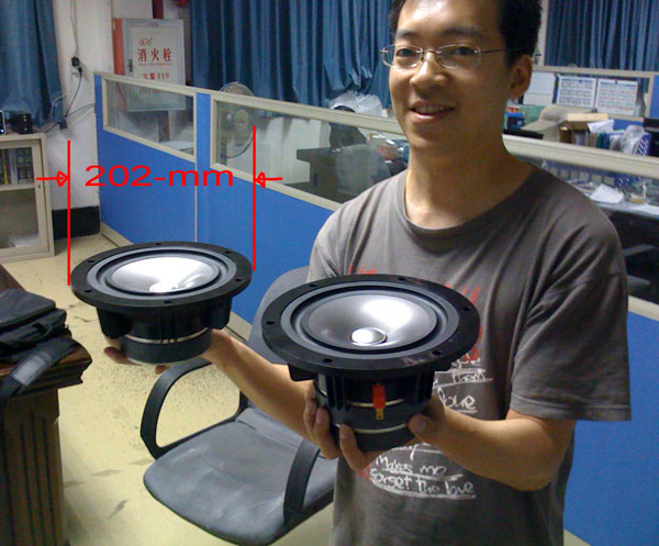

Full big Full range driver, single cone/cap design
New Custom frame - 202-mm diameter
New machine made (not spun) 126-mm cone
New U cap - same bonding process as 7
New connectors - same design as 7
Alpair 12 - 1 mag. LMS-00401/06/09

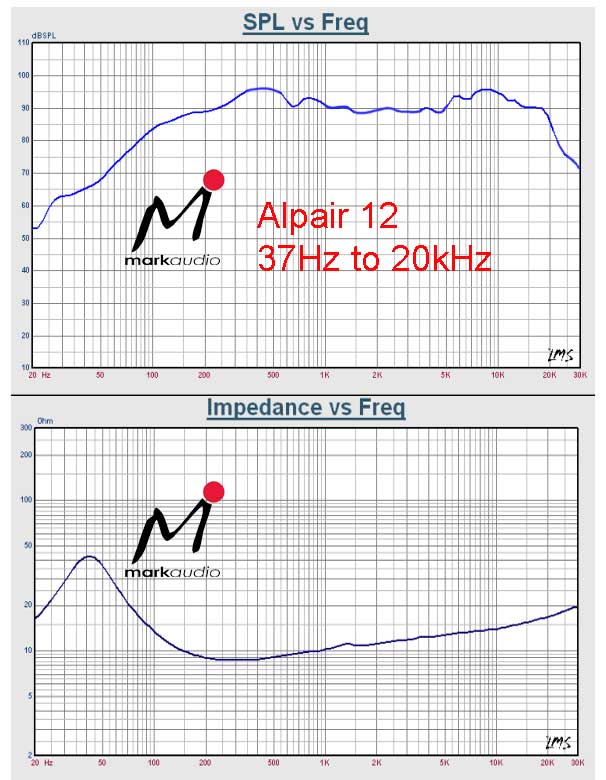

Revc= 7.000 Ohm
Fo= 37.566 Hz
Sd= 14.314K mm
Vas= 28.852 Ltr
Cms= 991.665u M/N
Mmd= 15.332 g
Mms= 16.317 g
BL= 9.227 T.M
Qms= 1.311
Qes= 0.333
Qts= 0.266
Levc= 49.569u H
No= 0.518 %
SPLo= 89.163 dB
Xmax = 12mm 1 way
Rated at 50 watt cont.

is the right side have double magnets?
changes of dustcap
looks very nice
maybe ALPAIR 12 BASS? 20-25HZ 88DB, 12MM XMAX
changes of dustcap
looks very nice
Now this is a drivers that I'm very interested in. Built in BSC, high sensitivity, great power handling, and very valve-friendly impedance.

Thanks for your comments on my speakers. Yep, Dennis can keep his arms fit, the Alp12's weigh in at 2.3Kg each
