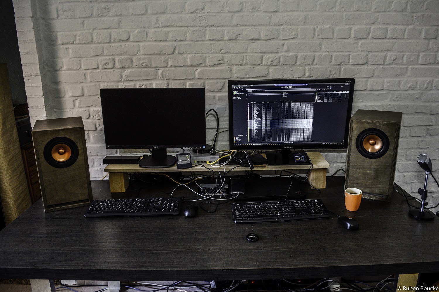

I use the 10.3M in a 17.9L reflex tuned to 45Hz in my office with a little LCR filter and i'm very happy with those. I did not compare to the 11MS or the Pluvia11 altough.
20200721-dsc_0115e-jpg.1003950
The CHN110 can go lower, but need a much bigger case (about double the volume) to do that. I use them in an standmount MLTL and there they are tuned to 33Hz. In a reflex 40Hz is doable (at least in sims).

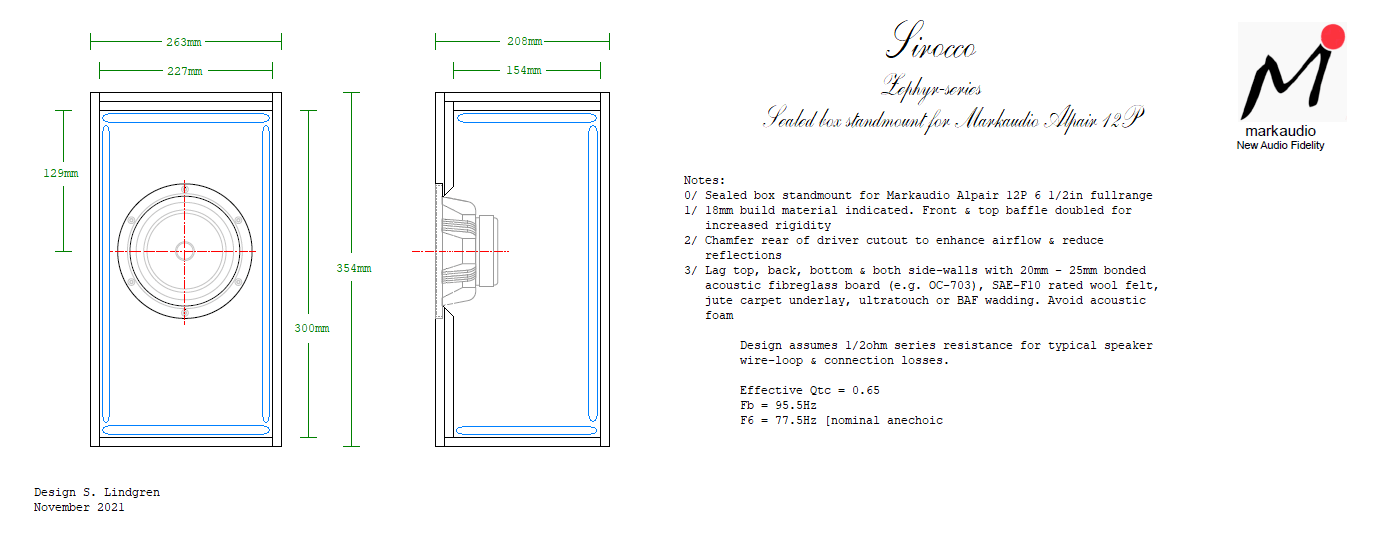

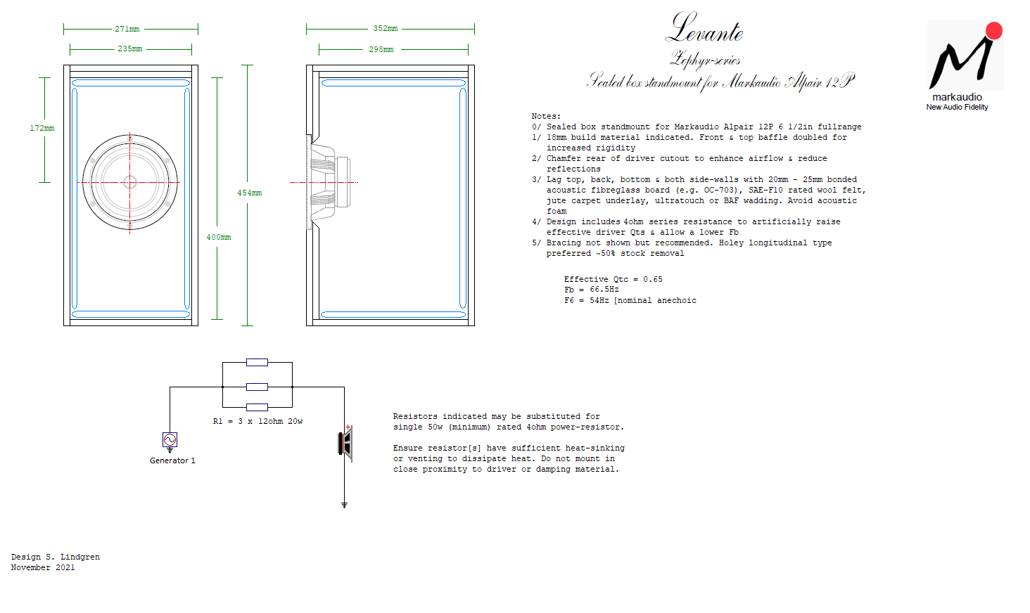

I was looking at your Nostromo plans, and I am guessing I would have to use the biggest box version. I don't have a SET amp, I'll probably be using 3E audio TPA3255 amp, or a class AB amp of some kind.
Do you mind giving a really quick explanation on why the sizes vary and how this will affect the overall sound and how it interacts with the amp?
Assuming the output impedance of your amplifier is low, then the smaller cabinets would be preferable. You can look at it a couple of ways; probably the easiest is to view it from the perspective of electrical damping. The higher the amplifier's output impedance, the lower the amount of electrical damping it provides -in effect, it's like artificially raising the driver's Qes, and thereby the effective Qts (Qts'). Since Vas and Fs remain unchanged (Q, Vas and Fs dominating in terms of LF alignment), as the effective Qt rises, so does the required box volume.
This might help a little: I posted them on a different thread a few weeks back. Three boxes for the Alpair 12P. They all have the same (more or less) Qtc alignment, if fed with a voltage source / low output impedance amplifier, such as a typical solid state class AB, class D etc.
Starting with the smallest (they're not in order), that's 'as is', with the driver alone, assuming a minor adjustment for typical wire-loop & connection resistance. Moving up, you'll see I've added some series resistance to artificially raise the driver Qts, allowing a larger box and a lower Fb while still achieving the same system Qtc. The greater the amount of series R, the higher the driver's effective Qts becomes, so the larger the box needs to be, and the lower its tuning for a given Qtc alignment. The downside is reduced sensitivity and power-handling, plus the resistors get rather hot; no free lunches in physics. 😉 My preferred implementation of resistors in this case would actually be to use them externally, with a grid of about 15 - 20 small metal films, probably 2w rated or similar. Better heat-dissipation, theoretically easier to trim out, and the multiples ensure you're never near their power-handling limits. Probably a bit OTT for many though...

I see, thanks for that detailed write up.
I honestly didn't realise that the AB and class D amps are in the low output impedance category. I take it I would need the smallest nostromo then?
