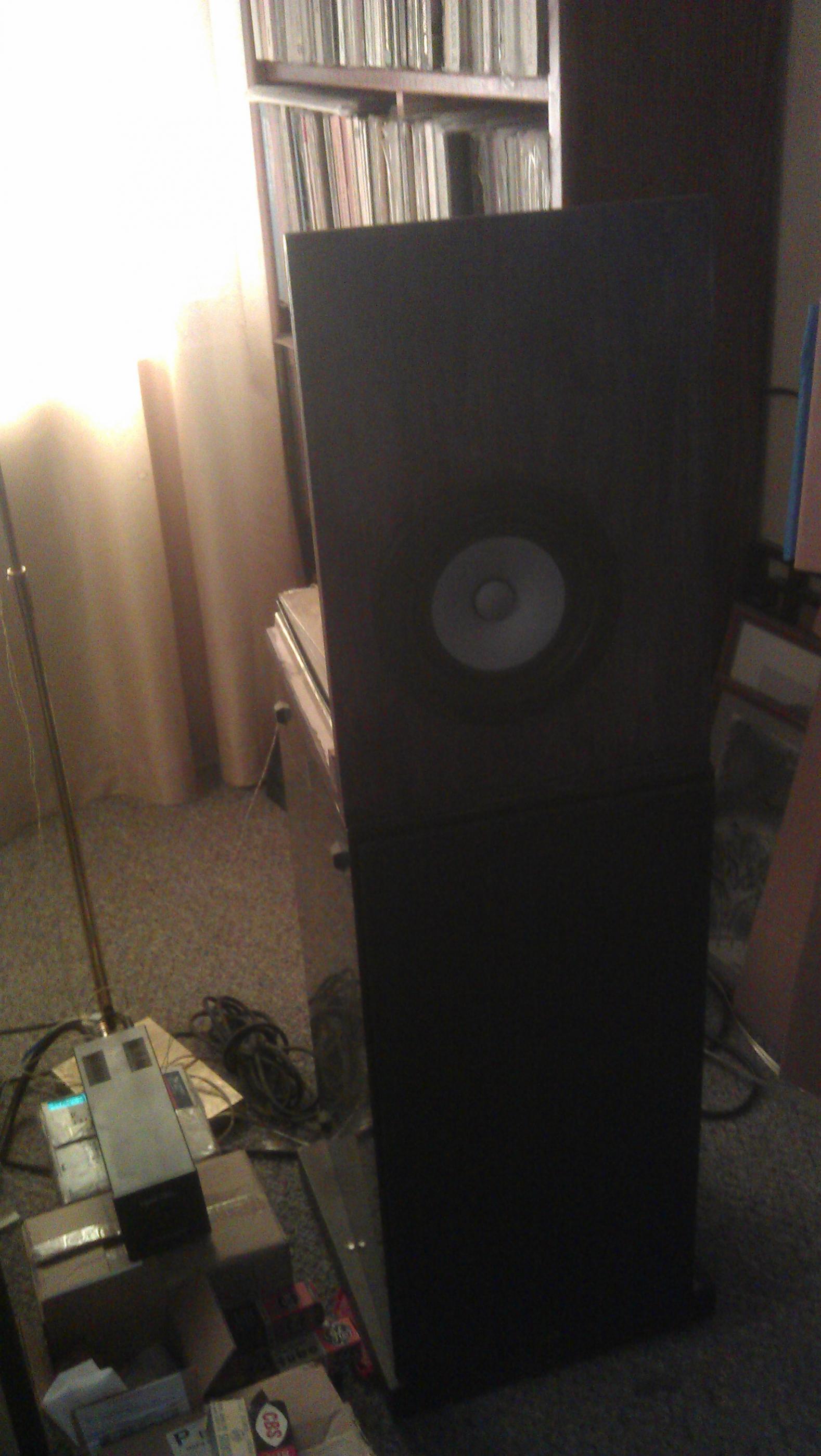

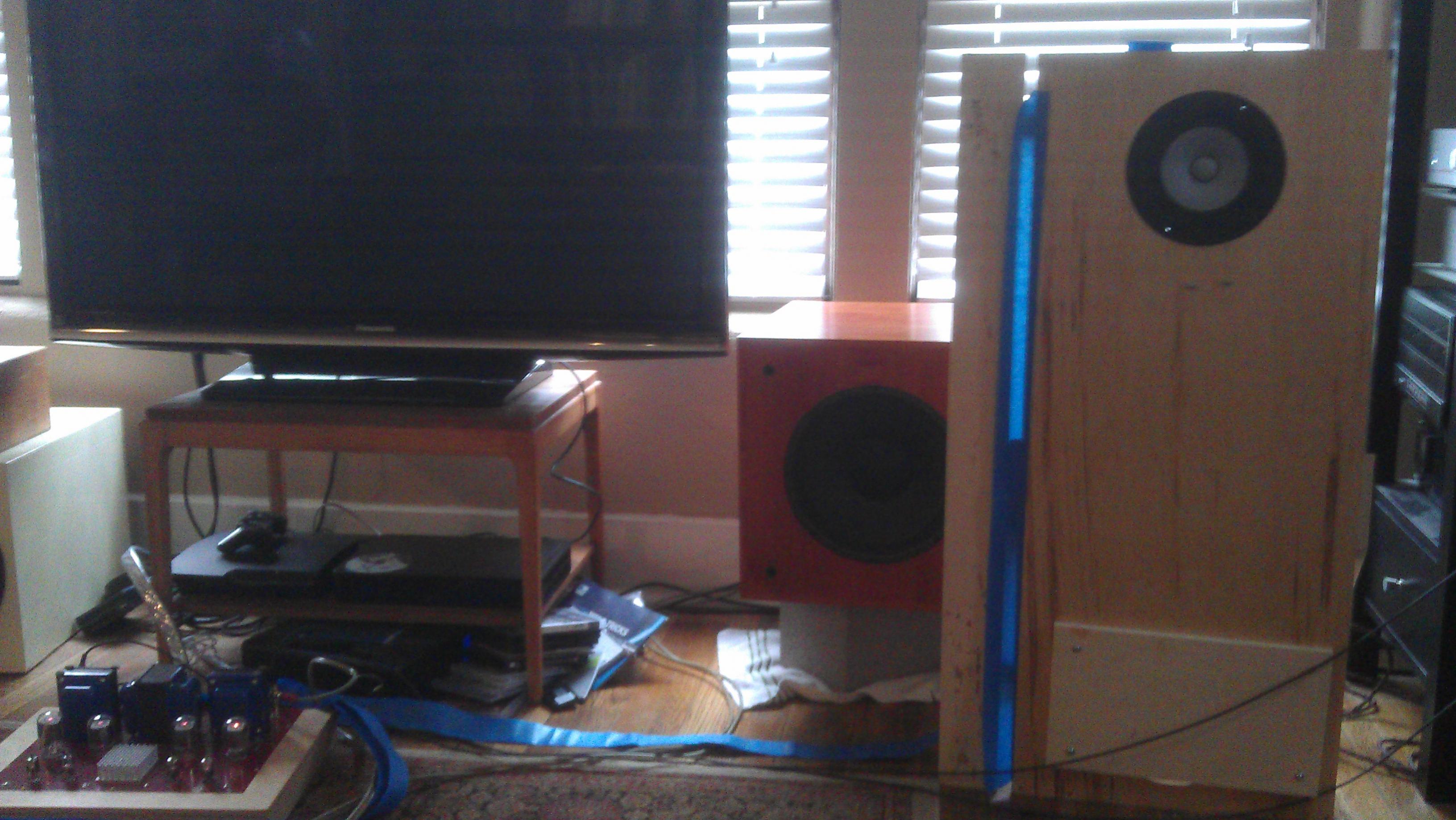

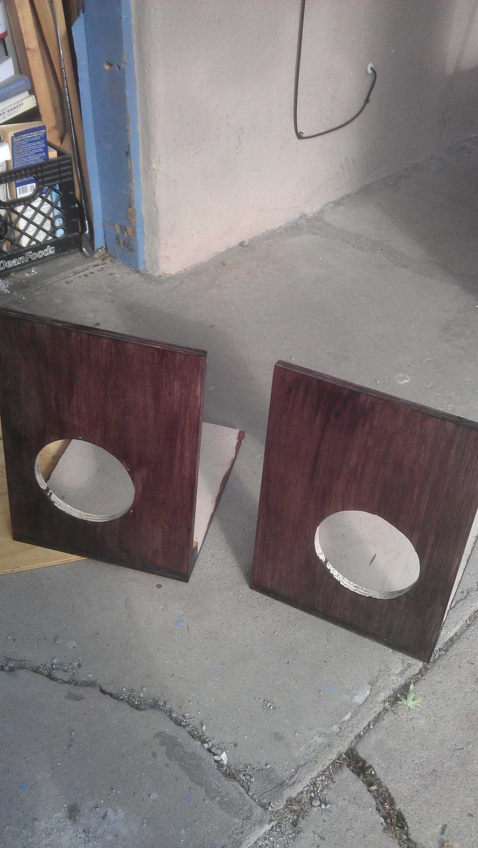

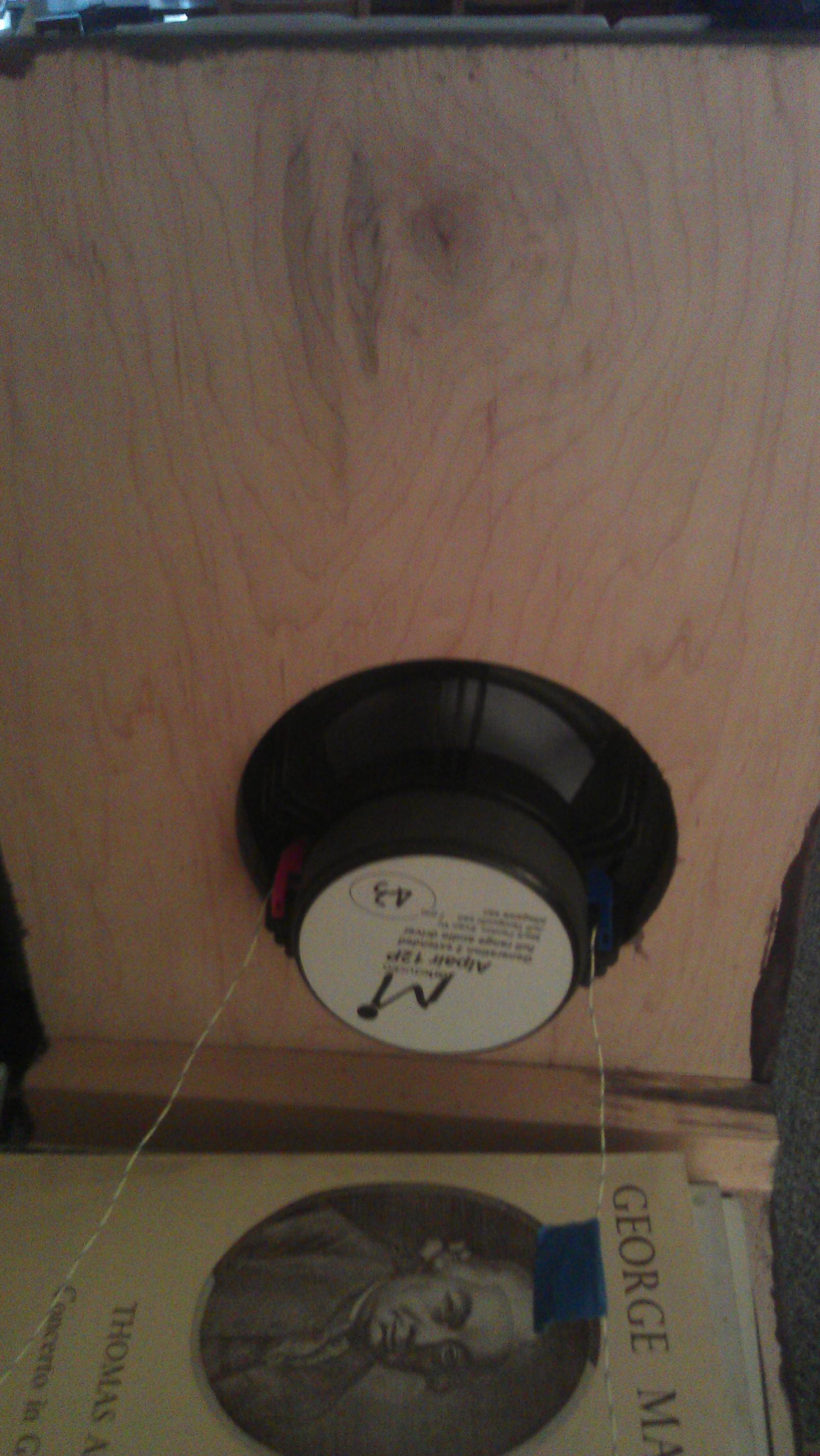

Now down too business, OB's are excellent😎no argument from me there, in fact my preference. Me and some friends have experimented with OB's for years and most recently with the Alpair 12P driver. My past experience has been with the Alpair 7.2 which did an outstanding job in an OB configuration in my system for over a year. In all honesty though, the new 12P takes things to a whole other level of performance. Frankly, the highs and extension are every bit as good if not better IMHO than the 7, and the mids, mid-lows and upper low make the bandwidth synergy of the driver exceptional , especially considering price category. I have not heard the 10, so my vote is with the 12P, you will not be sorry as this is one of the finest drivers at any price!
Here are some photos of OB's thrown together quickly too get break in etc until finer woodworking happens. I use crossover @135-170 on subwoofer plate amps, nothing on 12P. No:no:crossover is the best crossover, less parts for purest possible sound if you can manage.
Ramon
Ramon
