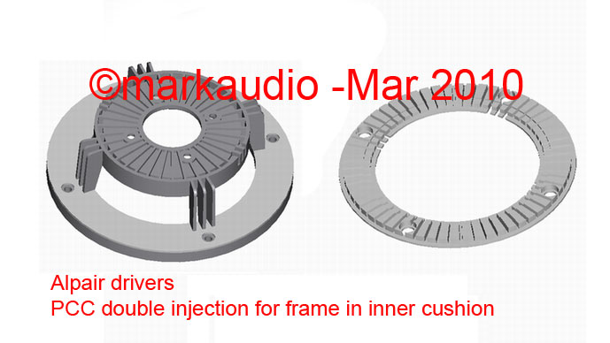

I'm in the final preparations for making the next batch of Alpair 7's. And as you may guess, it could be said the next batch of Alp7's are sort of Gen.2 model since they'll be 2 modifications. These are a bonded rubber cushion injected into the inner rim of the frame (see drawing) . This makes life much simpler when fitting the drivers into cabinets as the rubber is an in-built seal.

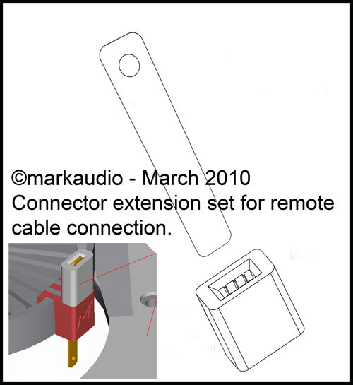

The second is a connector extension set making cable fitting much easier (see drawing). Solder your cable onto the extension copper connector, slide the block over the driver's connector and push-fit the newly soldered connector into said block. Should be so much easier and gives greater choice on cable diameters.

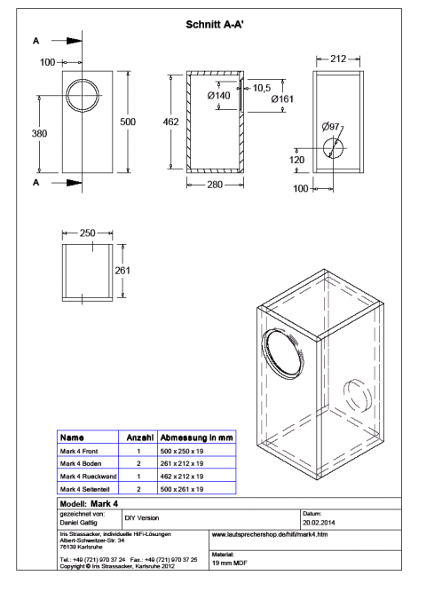

I'm building an alpair fullrange to an existing design wich can be found here:Strassacker: Loudspeakerkits (DIY kits)
i heared the speaker from a friend who builded it as 5:1 setup, and he uses a sub + the Mark 4 design you can find on that site. The plans are visible without buying your stuff there if you look wel and understand some german, but i can give you the plan also (i suppose i can as it's free downloadable). it's a small bookshelf speaker wich sounds very good, and easy to build. i will amp it with a marantz amp for my stereo setup.
