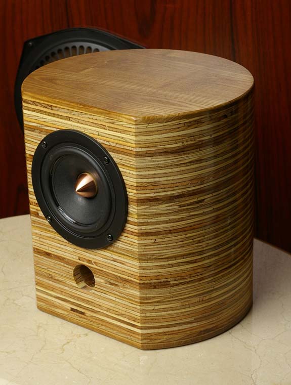

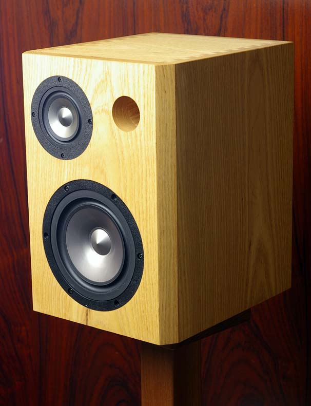

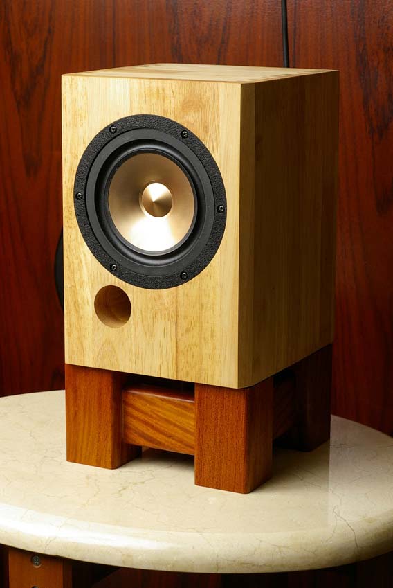

i agree, there's a tendency for diy to make the cabinets from solid wood
Do u think this is the best combination, dave?

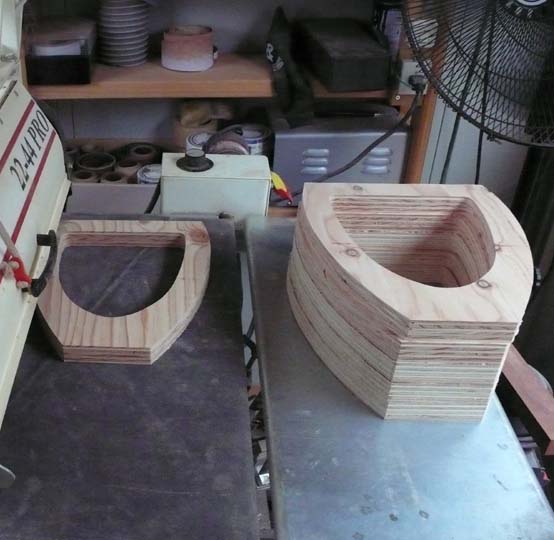

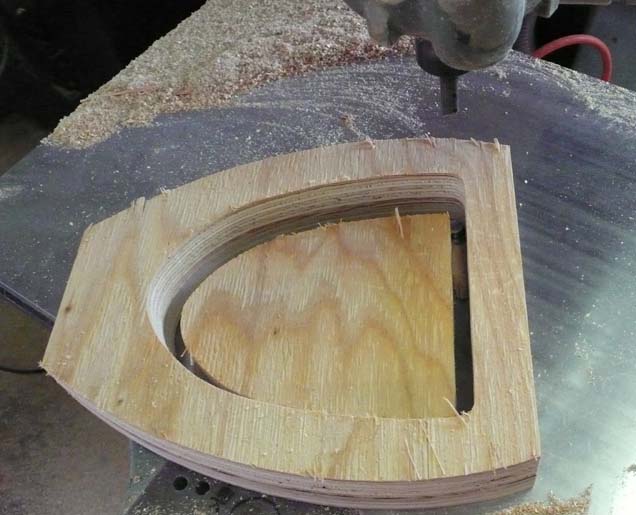

even the curve ones, the stacked planks and cut to curve and routed curve inside 😀 , that's alots of material waste.

I guess better way to do it, is bend the wood or plywood and make a frame for the front and rear baffle.
what do u think dave?

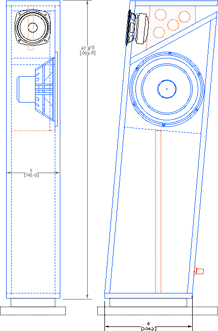

The sketch below is for our as-built Tysen with FF85 and sealed SDX7. The 1st concept had Jordan J6T/Alpair 5 ... i'm using the sketch to illustrate a possible approah to the double TL.
The aperiodic TL on the top is a straight-forward high ratio aperiodic TL -- if needed it could be rotated so that the botton was parallel to the ground and the top was sloped down towards the back.
What is a holey brace in the sealed box could easily be a TL partition. With Alpair 10, putting the driver on the front is probably a good idea. Further, to take advantage of optimum driver offset, i'd add an additional partition so that the back part of the line can be extended to have the terminus on the front/bottom. This should rotate the line sufficiently that the A10 will be near the bottom of the A5 TL.
dave
