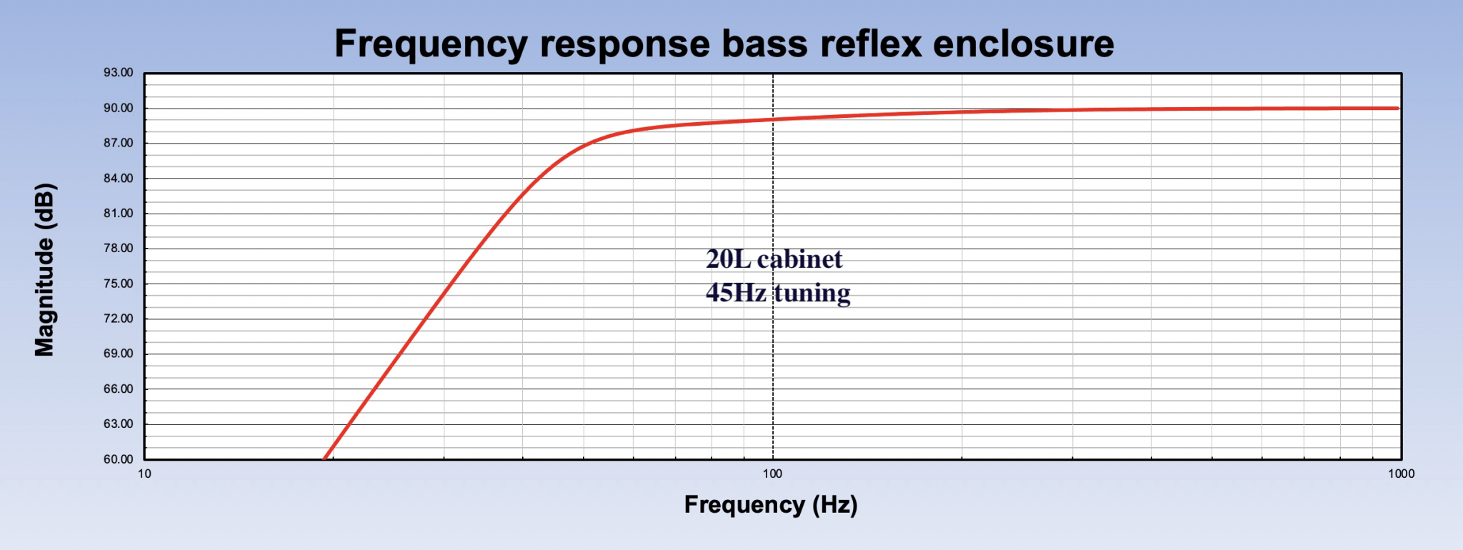

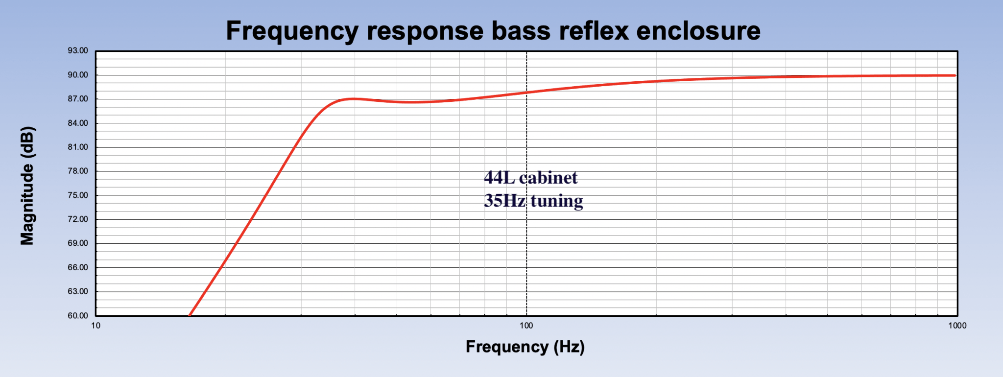

My thinking with the cabinet is to support the range of something like 35-80Hz (which covers approximately the first octave including the drop D tuning of a bass.) Here is a calculation for a 44L (which is what I just measured my cabinet to be) tuned to 35 Hz using the Alpair 10P specs (Fs, Qts, & Vas):
For a 20L cab with a 45 Hz tuning:
Seems you get a nice benefit in terms of F6 and F10 (both ~10Hz lower) with just a 1-2dB loss in around 60Hz with the larger cabinet. Is there something I'm not considering? Thanks!!

getting the cabinet to "behave"?
Making sure the cabinet does not produce audiable resonances.
The second sim definitly looks better.
The first breaks one of my prime rukes of reflex: The first derivative of the frrequency response should not cross zero more than once.
That droop will cause the resonse to not be as audiably elegant, controlled, well behaved.
The shape of the curve is important.
