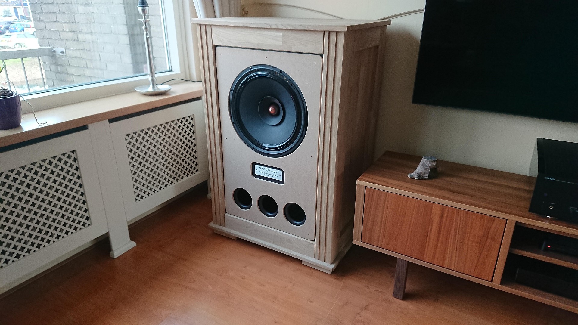

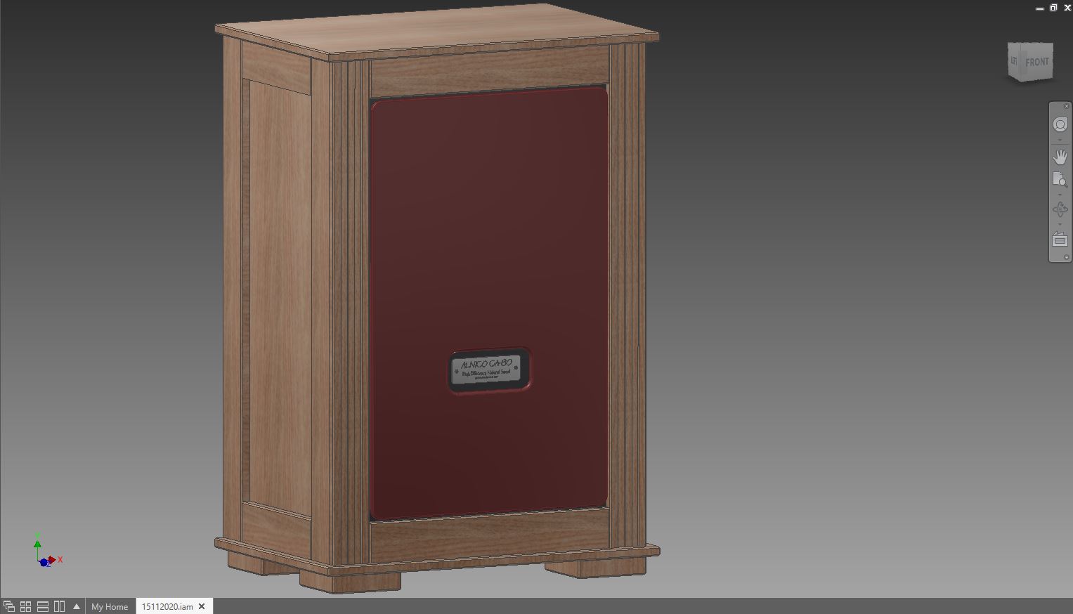

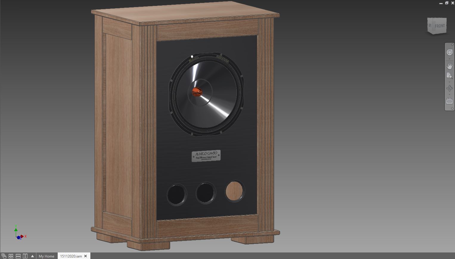

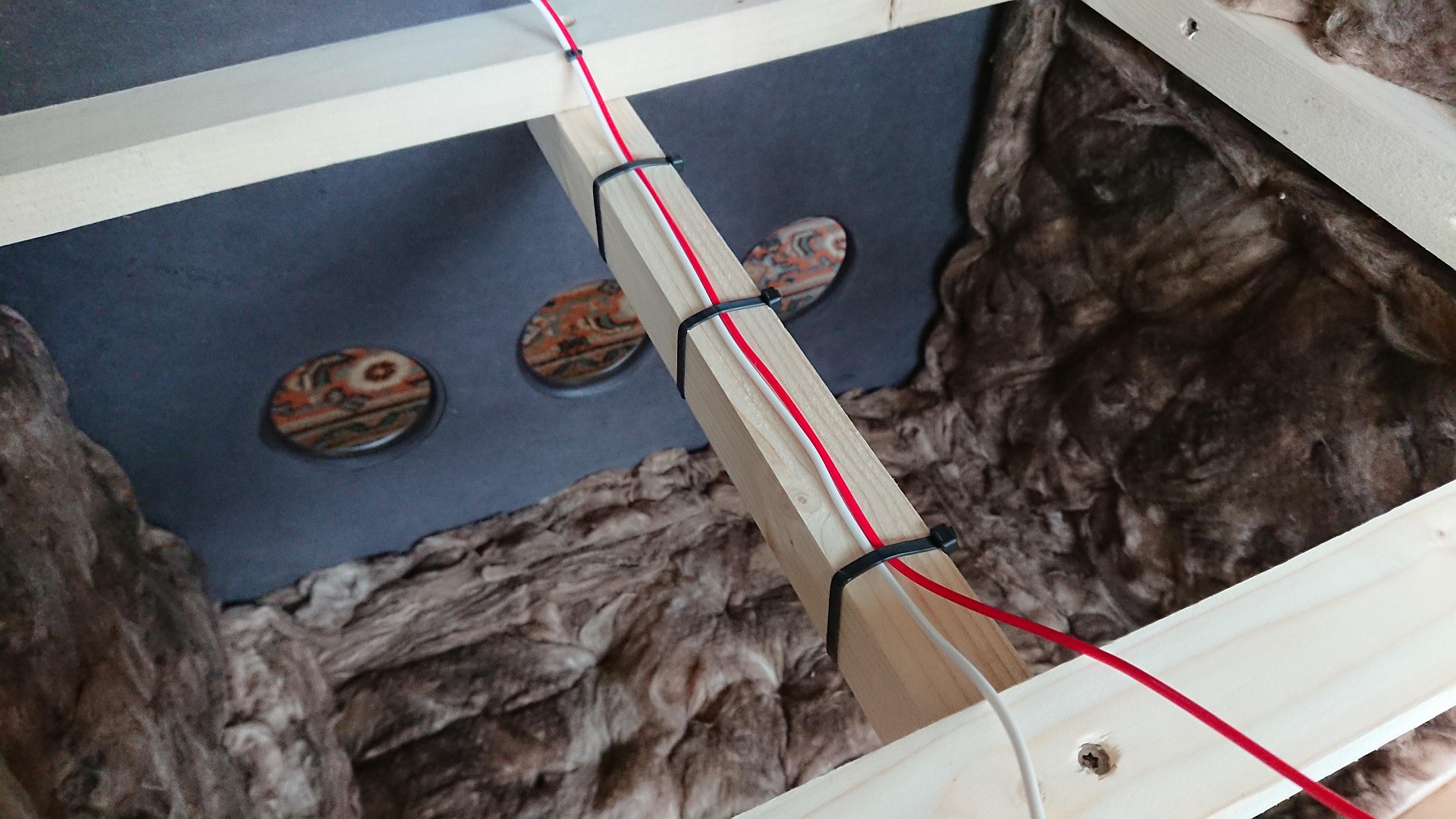

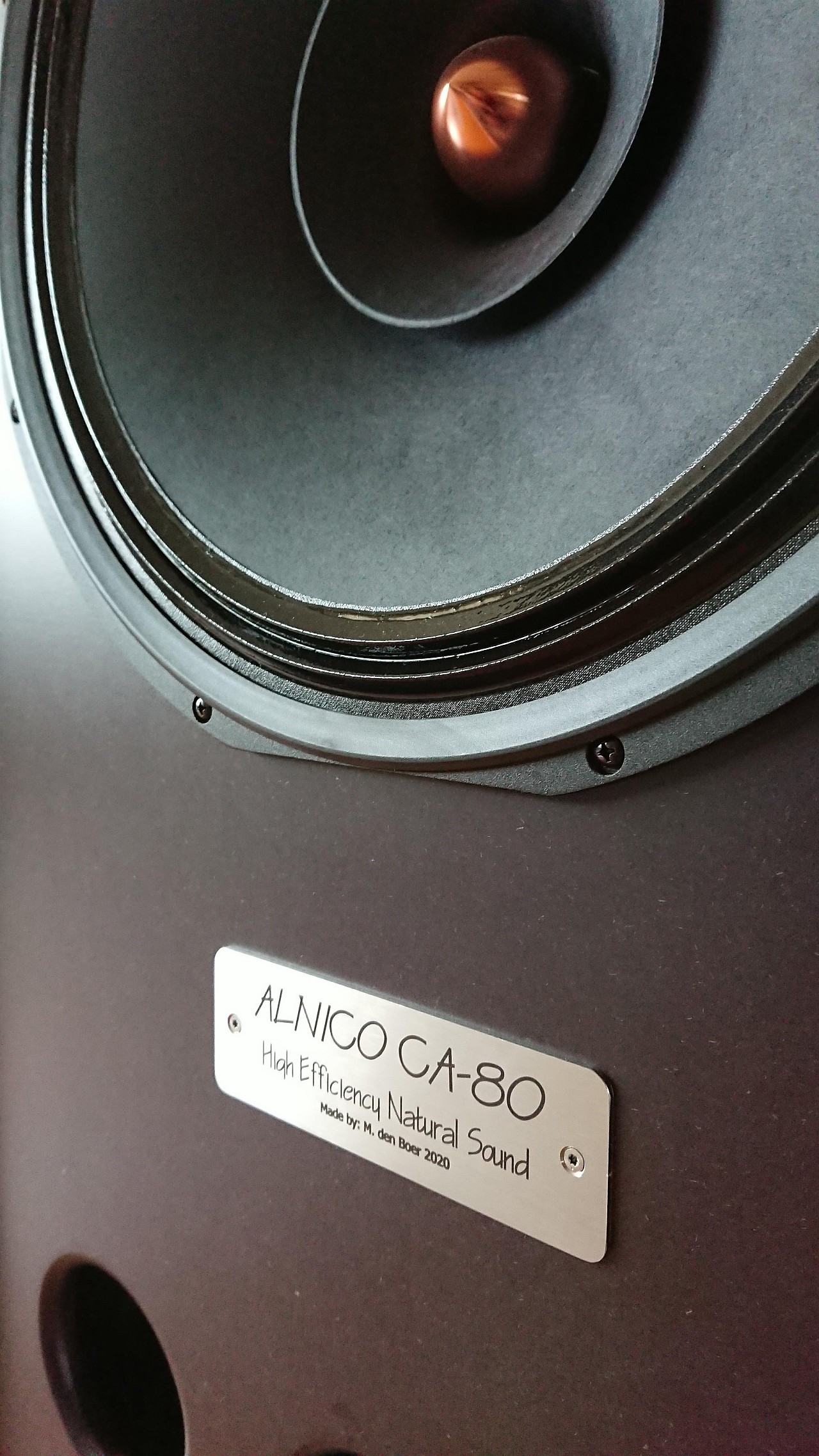

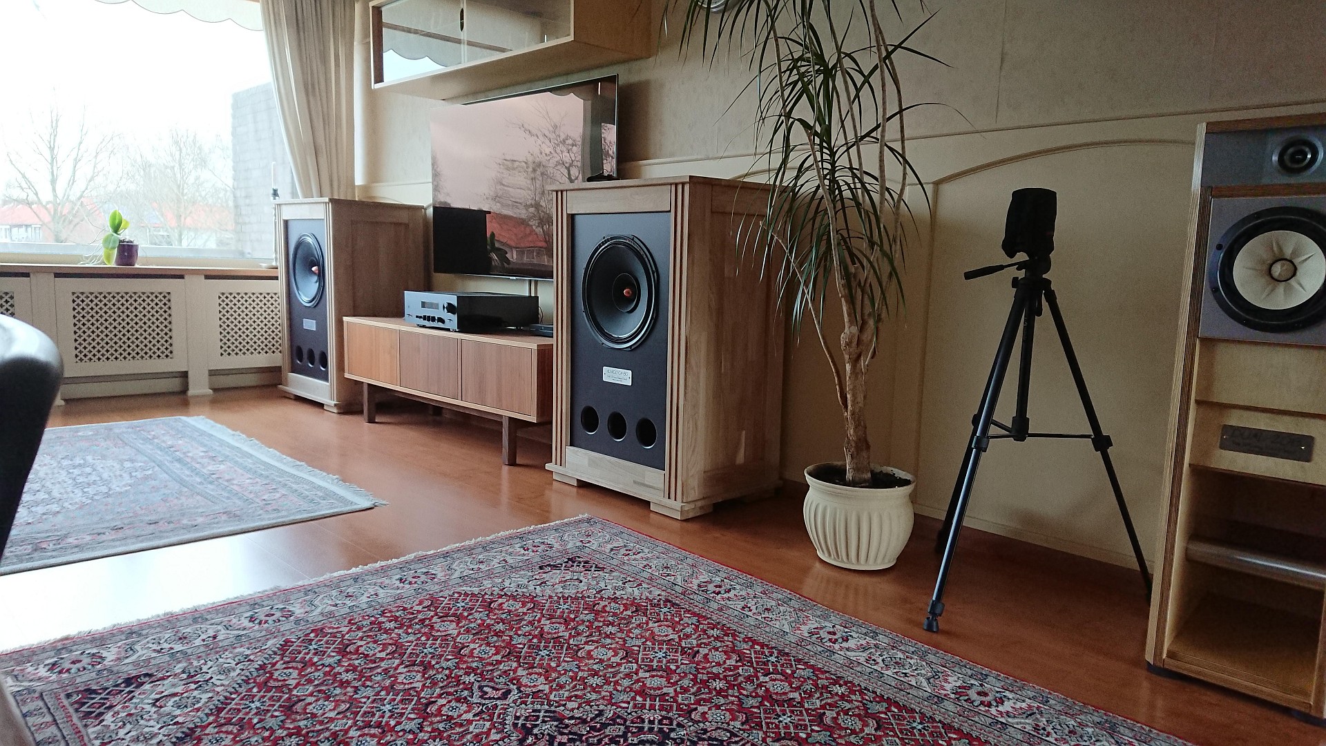

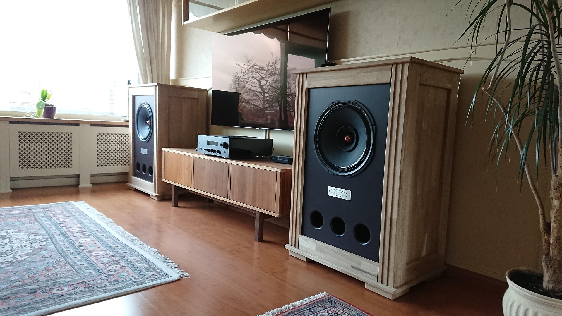

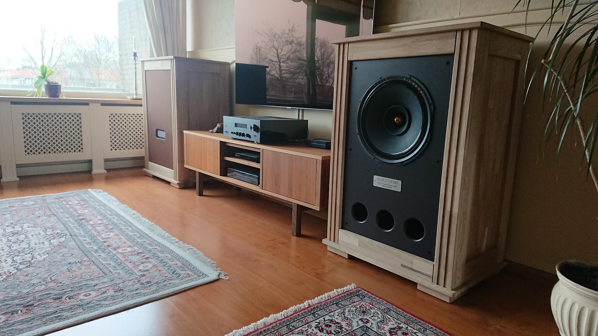

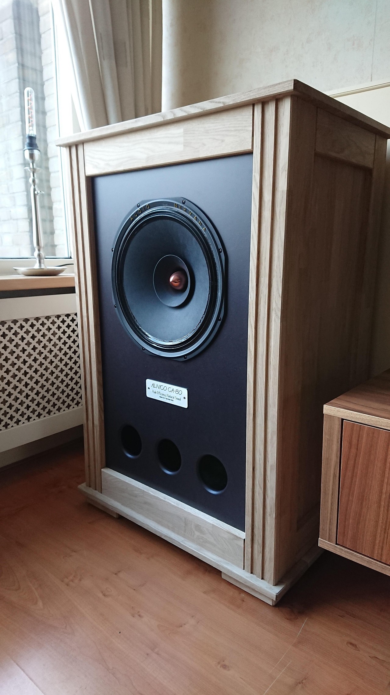

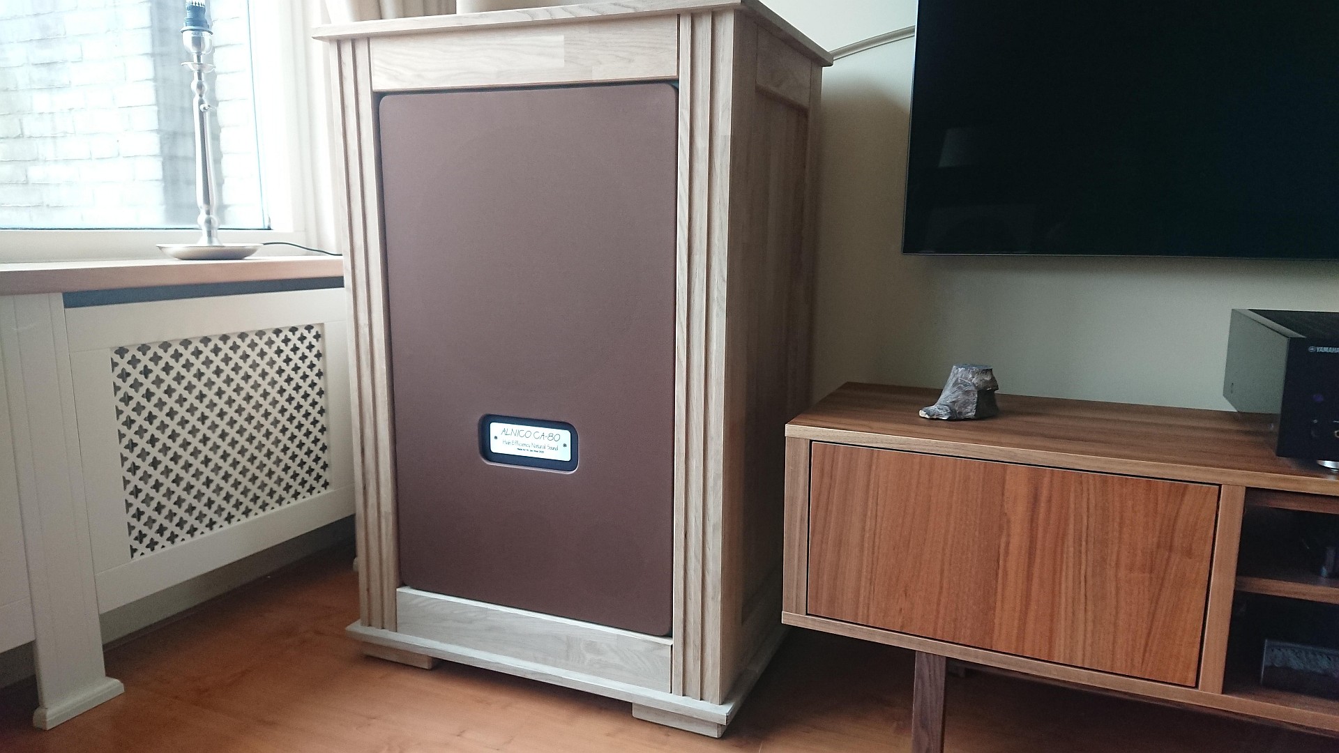

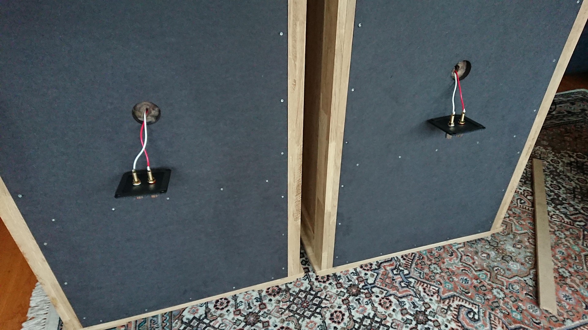

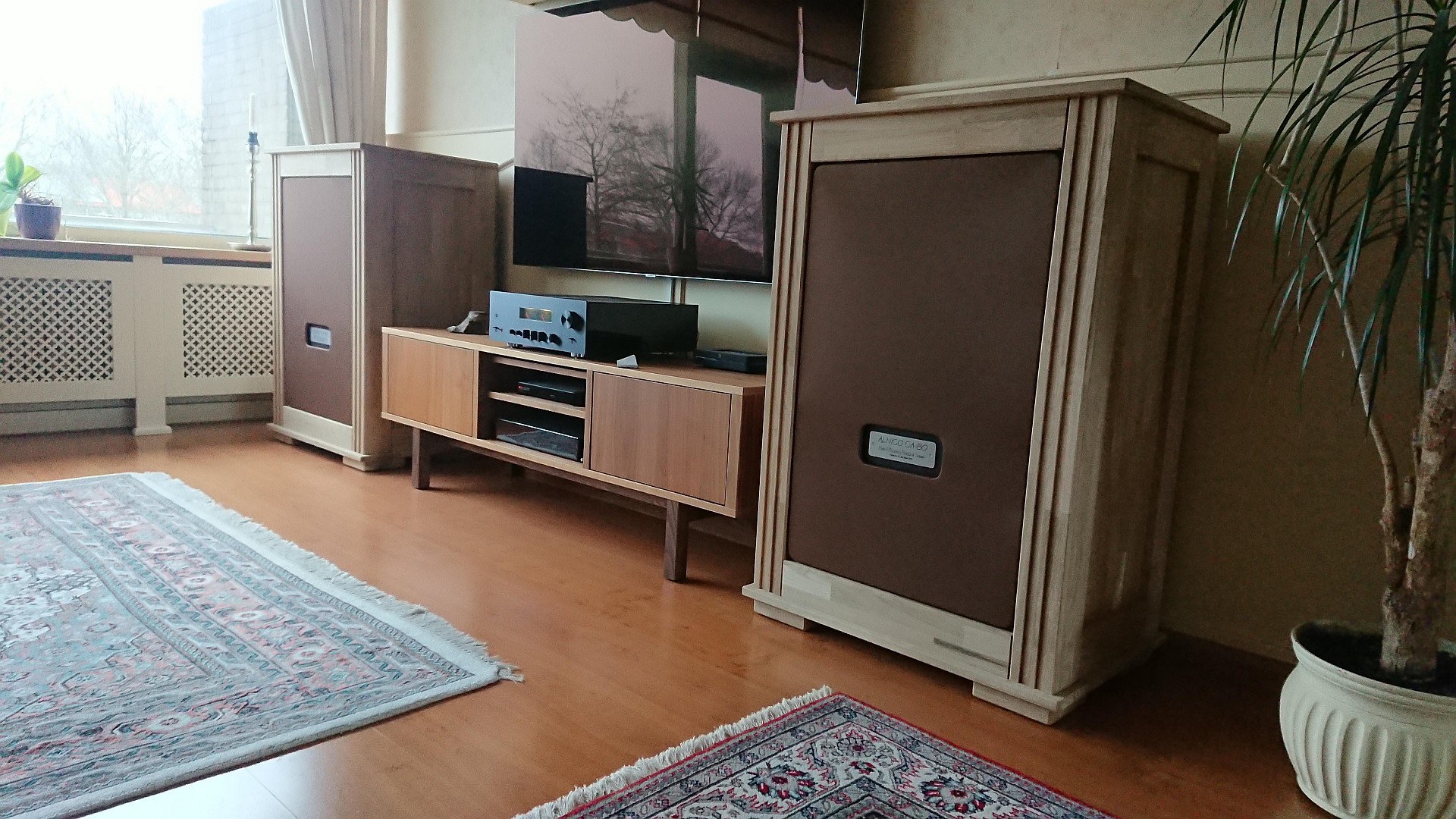

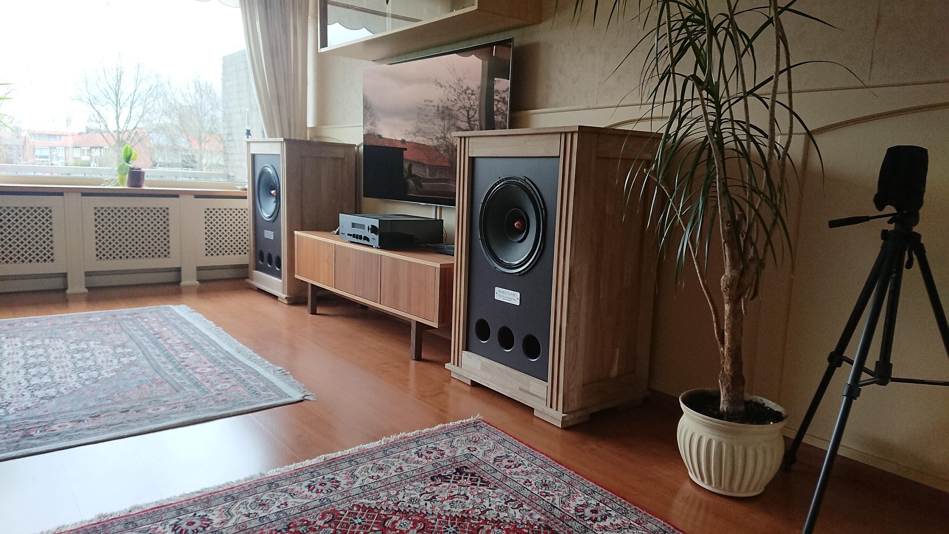

Alnico-CA80 15 inch fullrange speaker
Never built a full-range speaker before. But I have to say that this sounds really good. Deep bass and particularly detailed highs for this speaker size. Very satisfied with the result!
Greetzzz Hondasnl

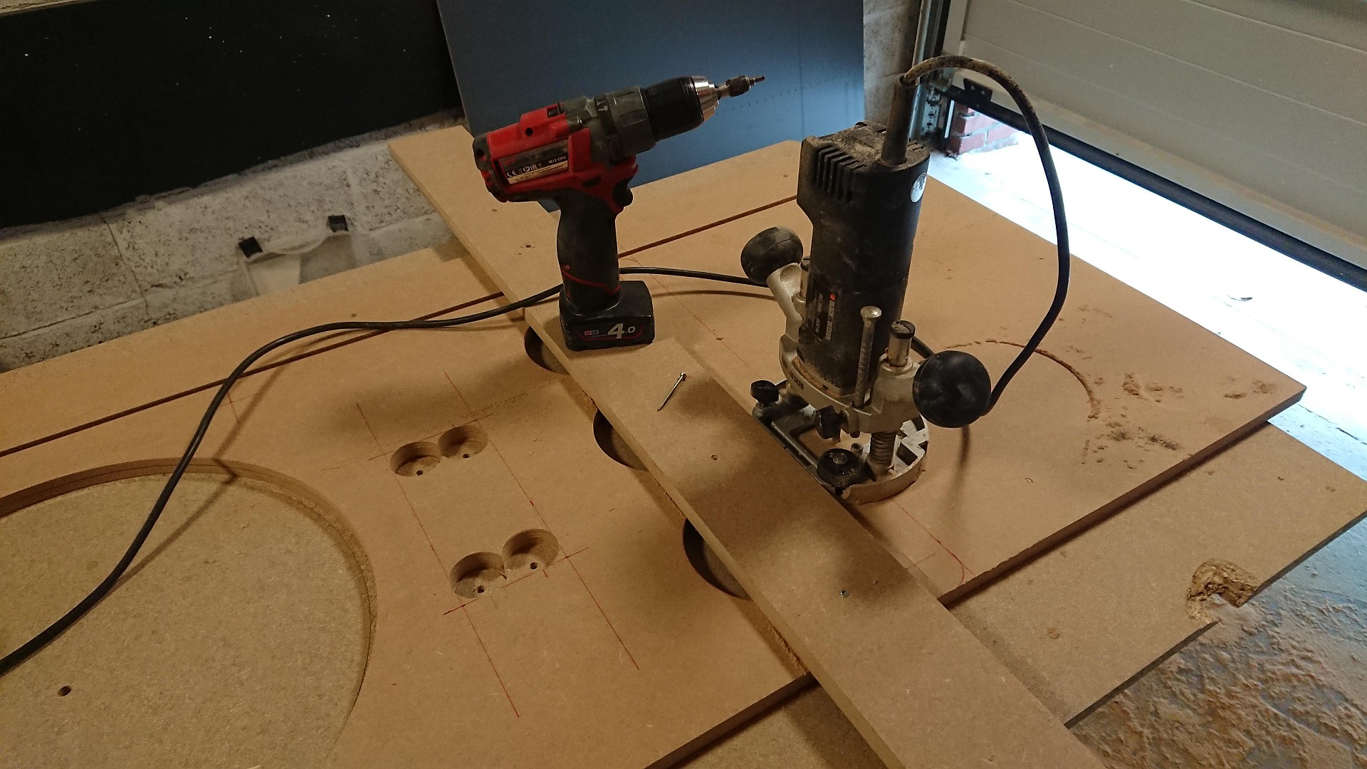

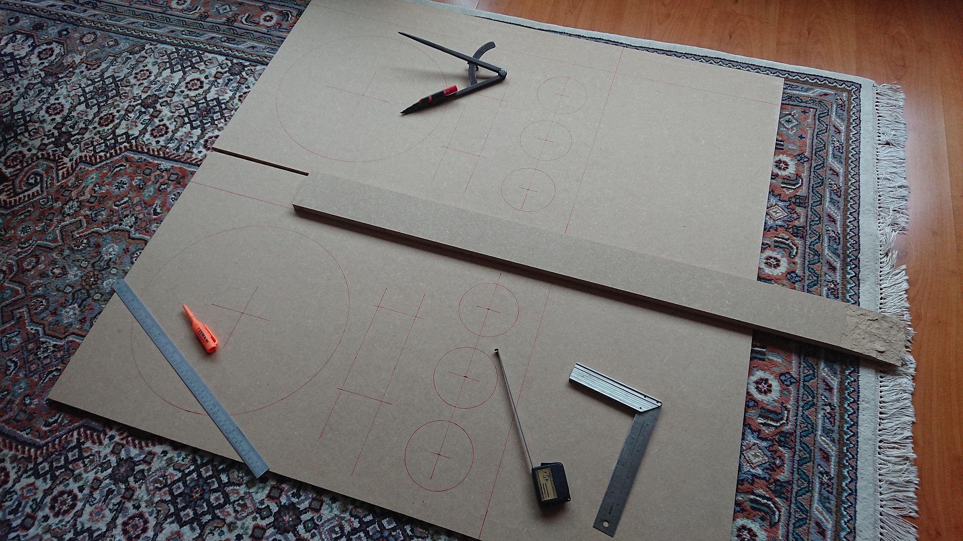

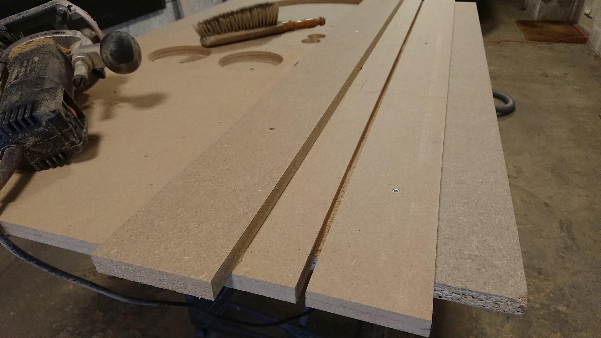

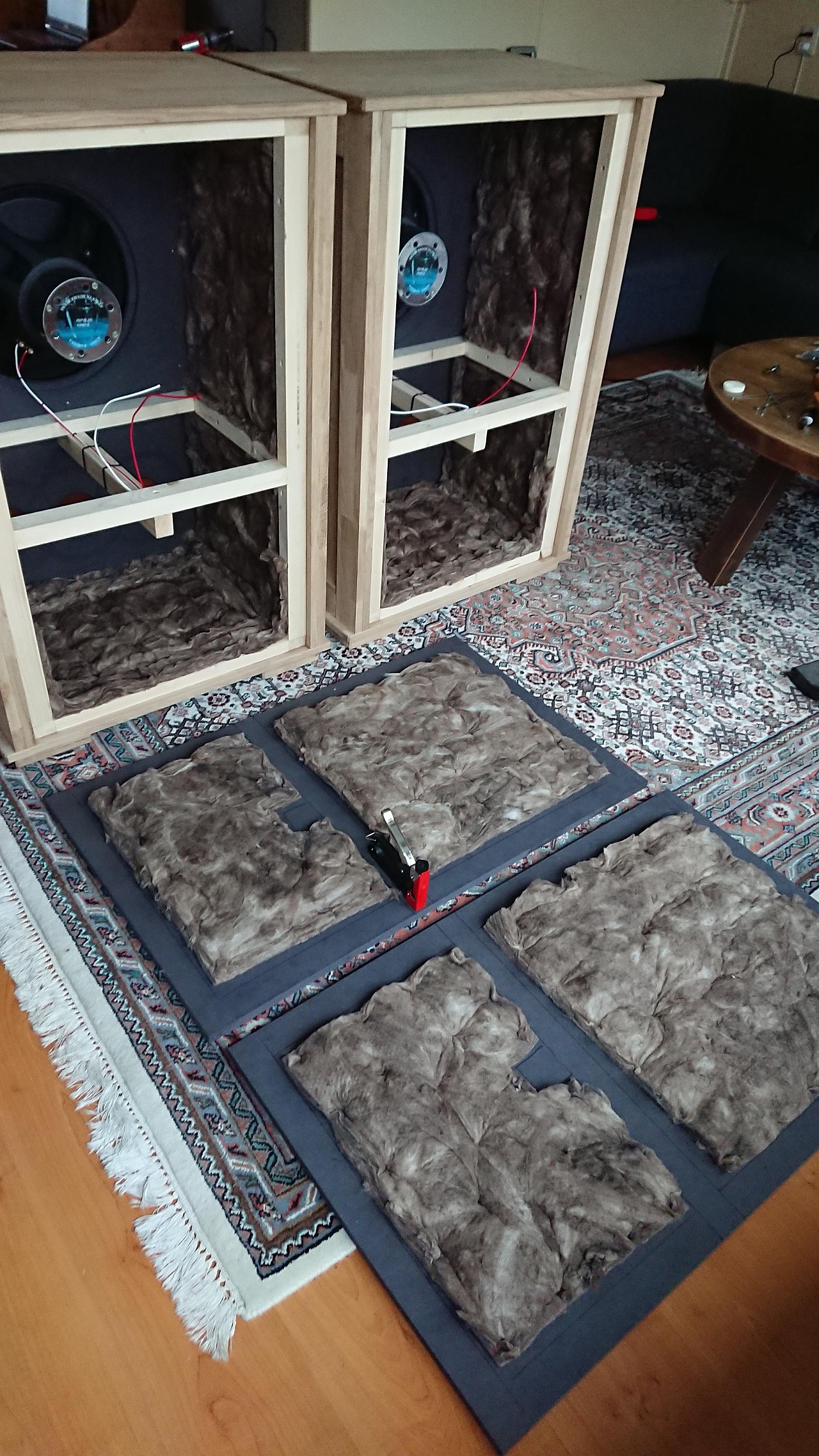

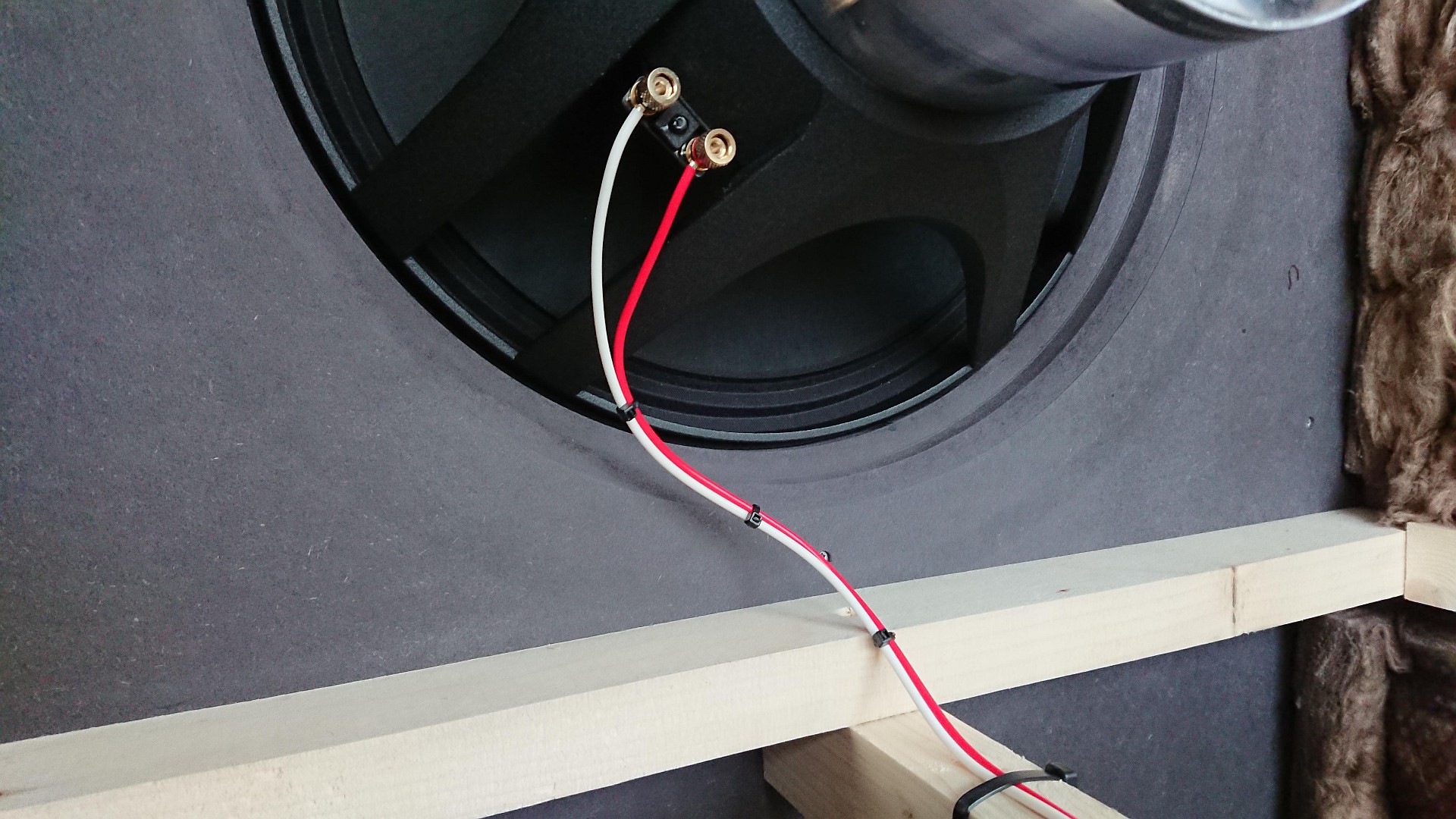

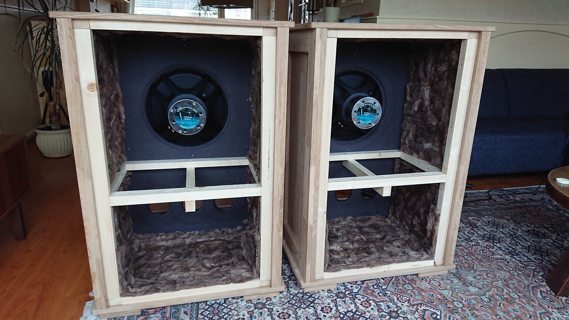

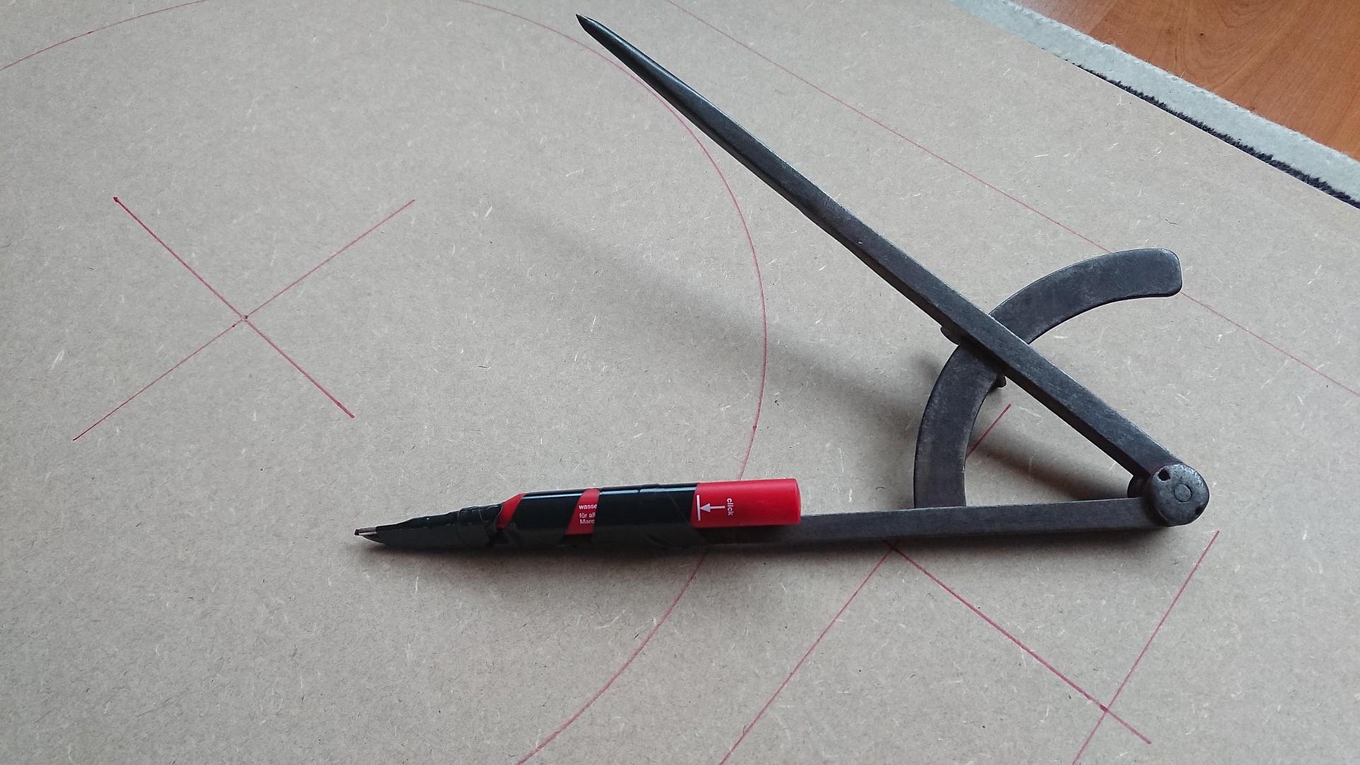

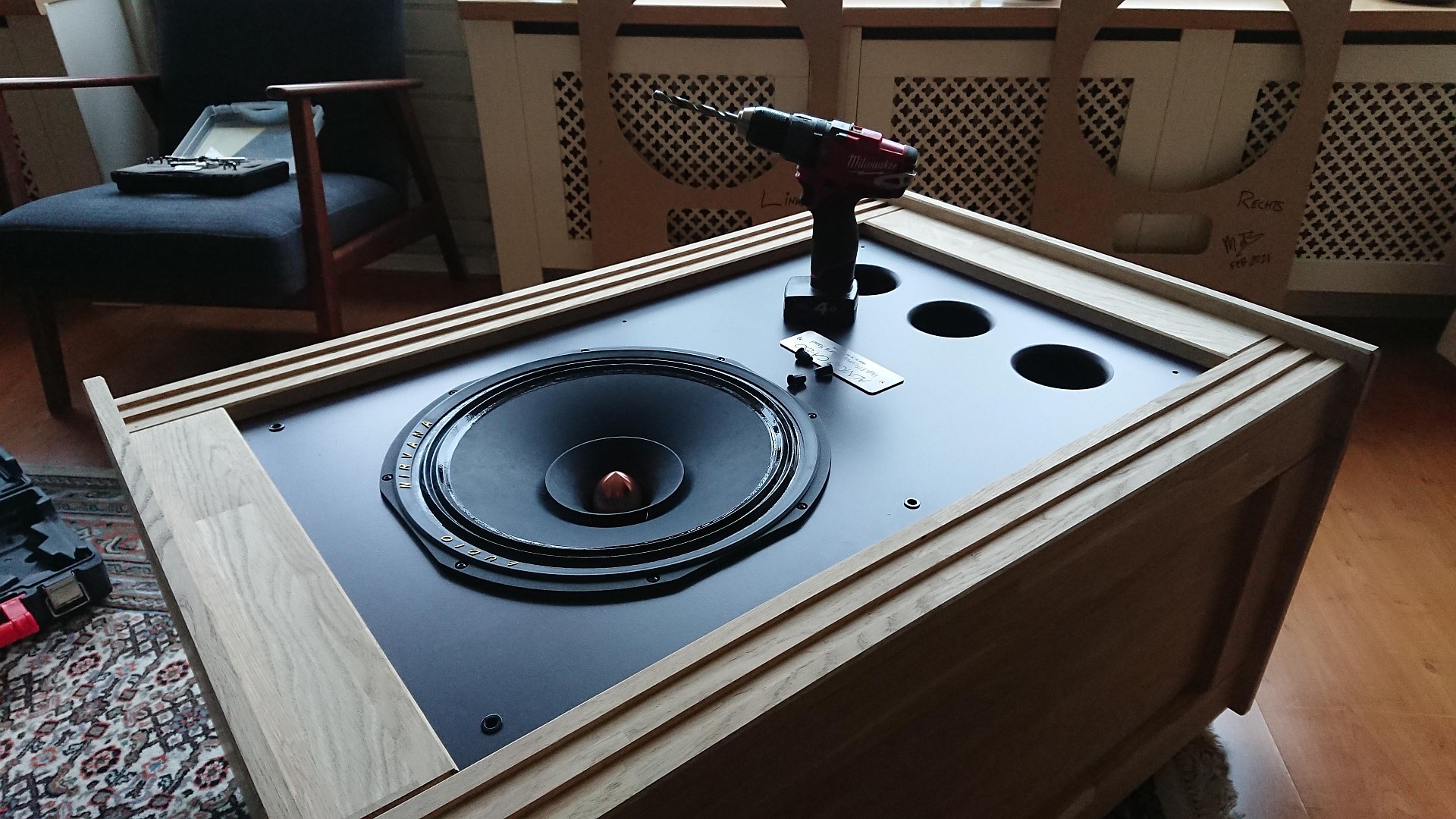

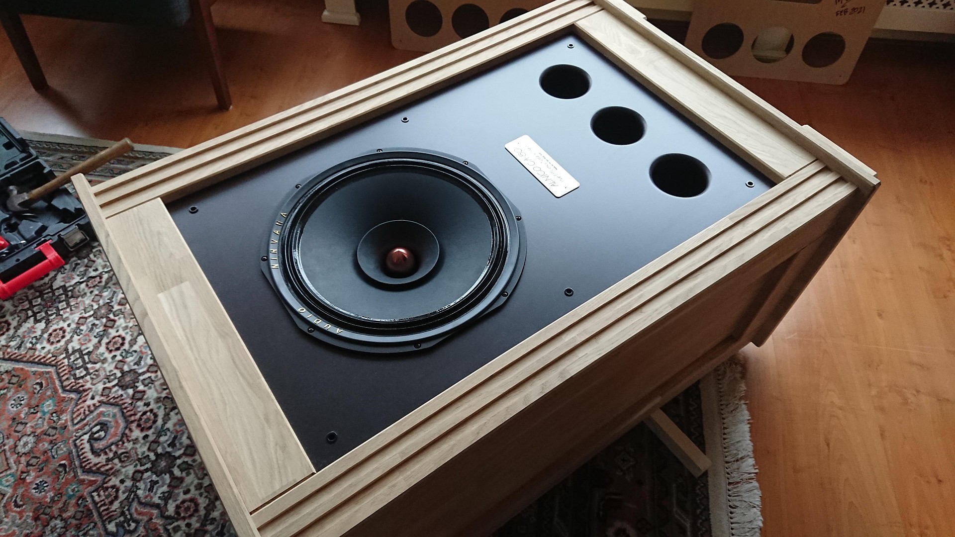

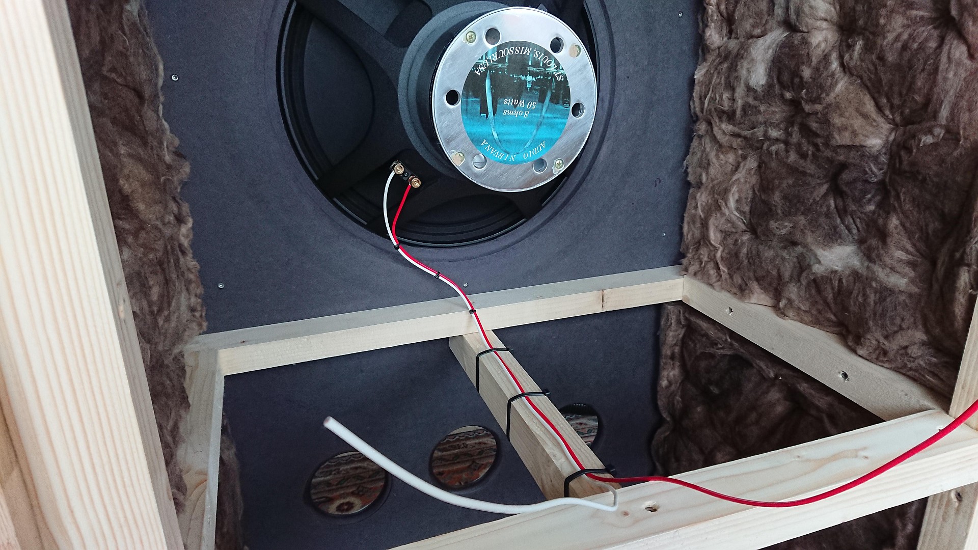

Some pictures
Some pictures during fabrication.

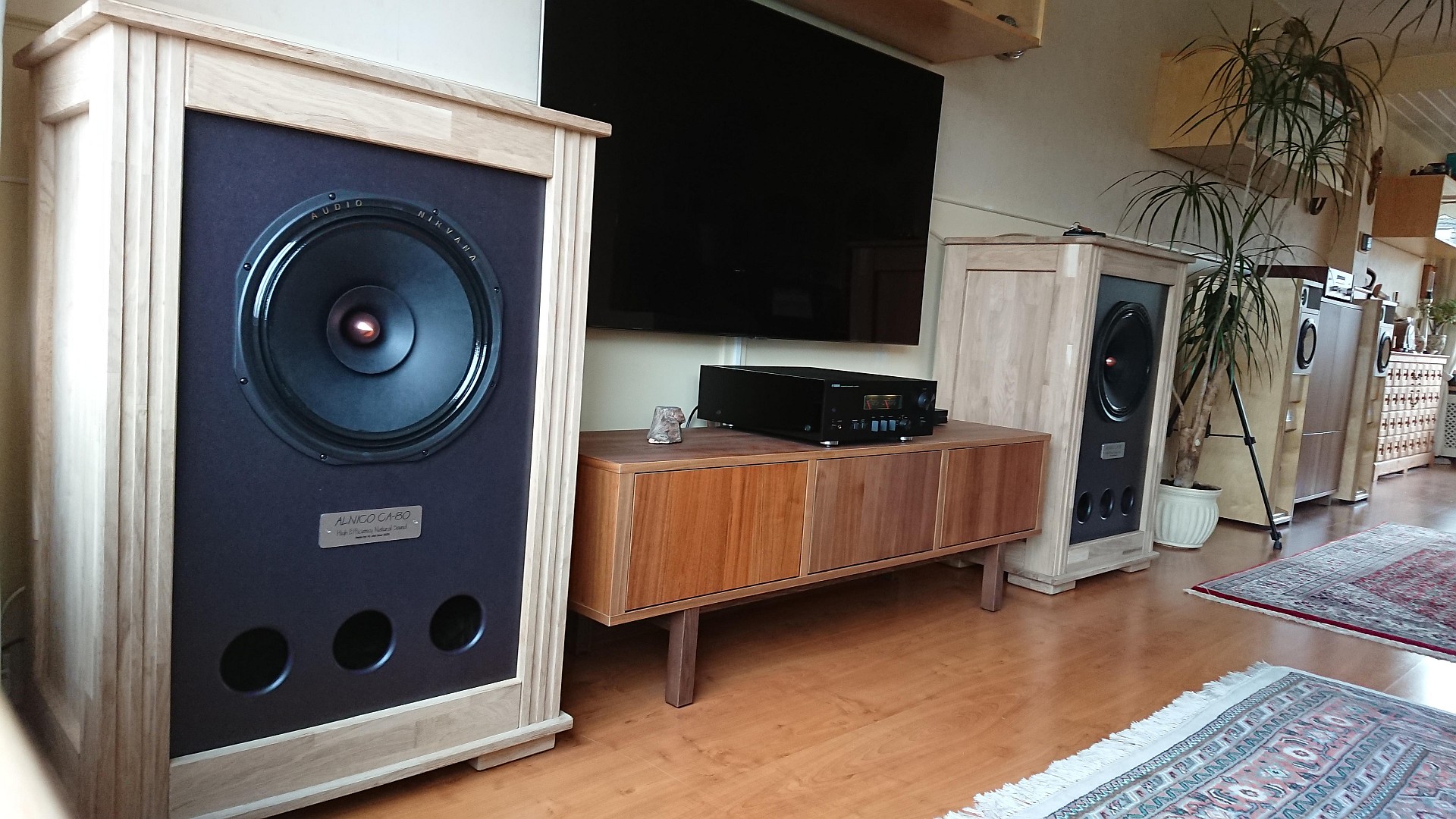

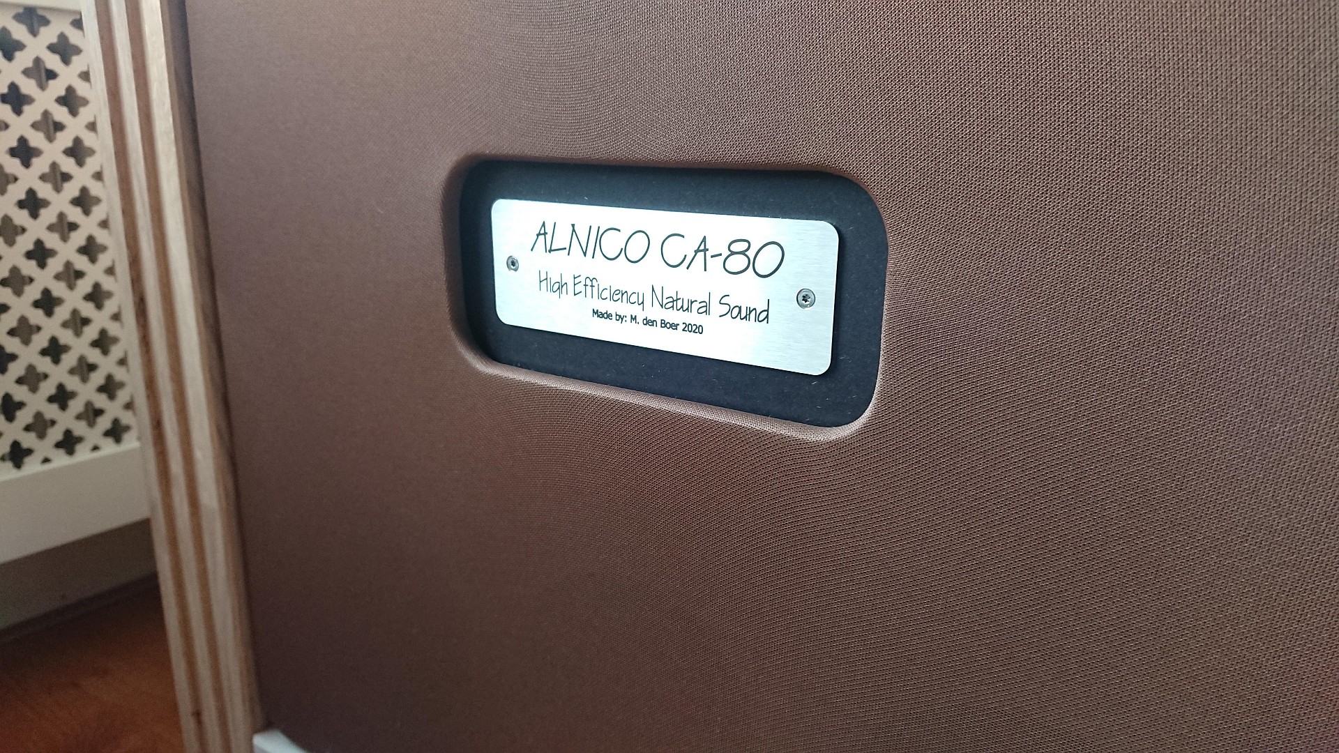

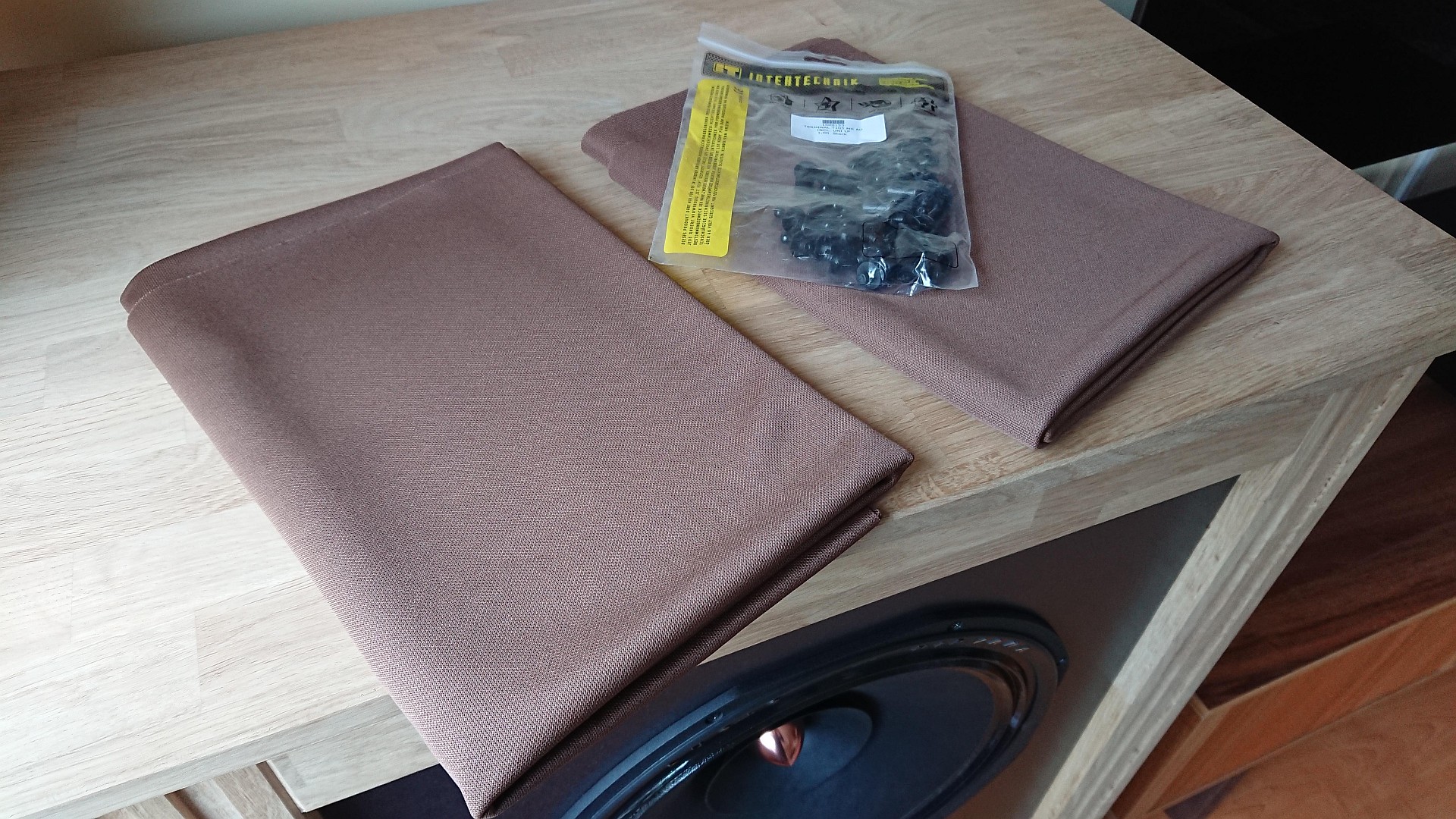

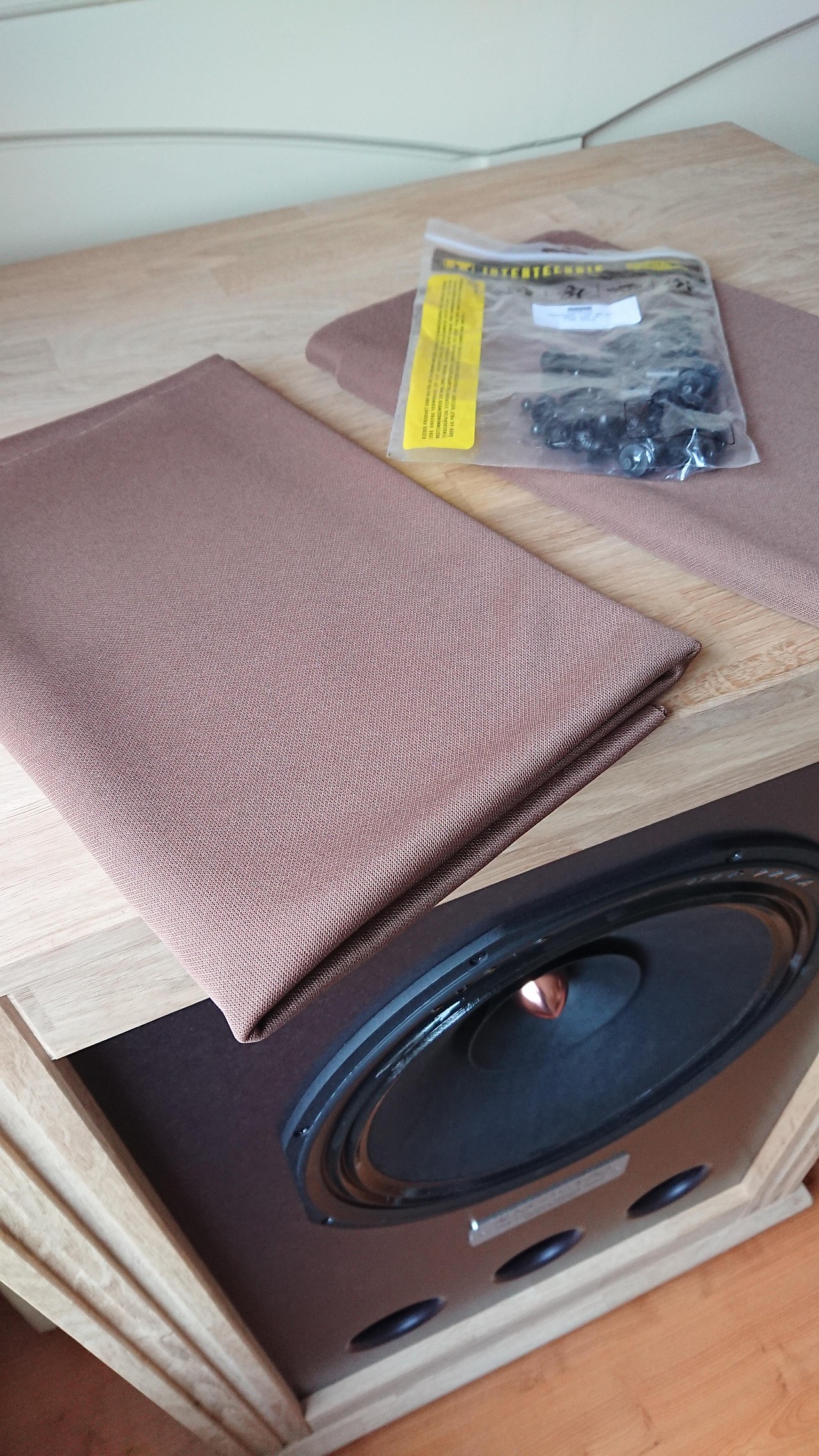

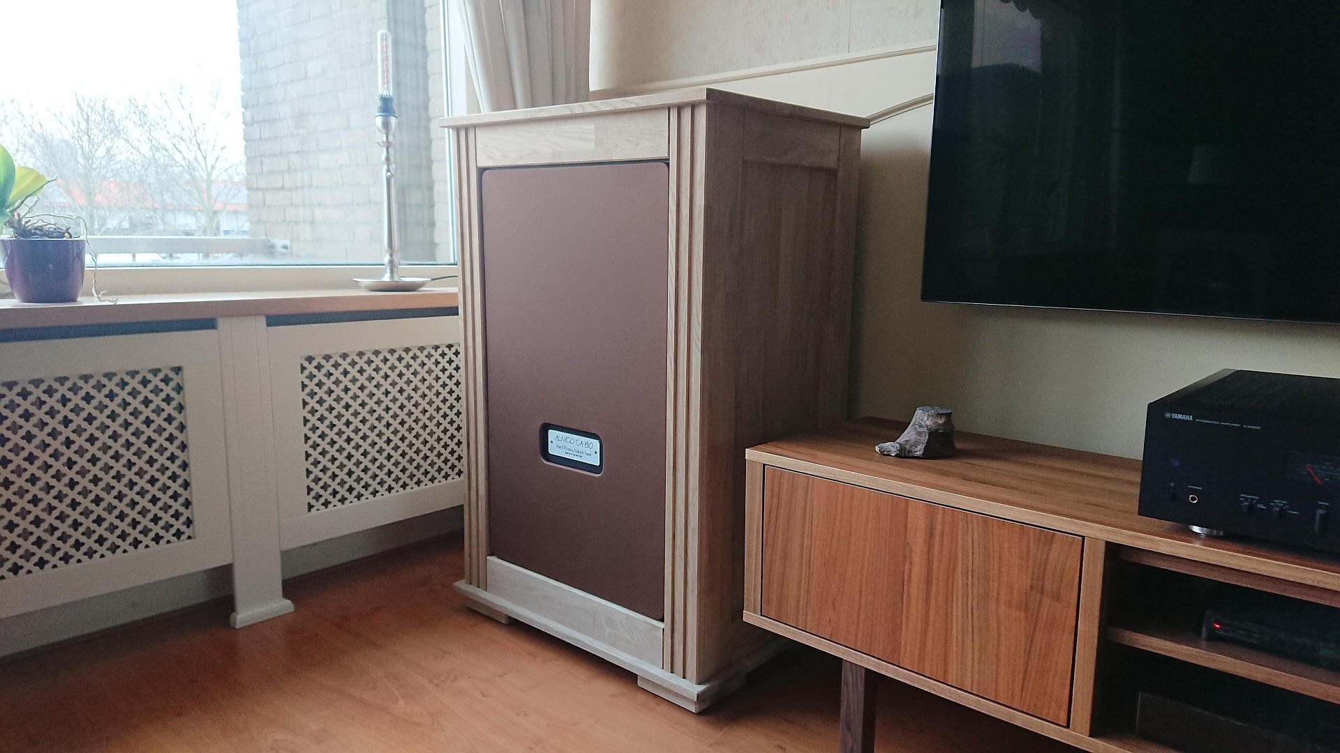

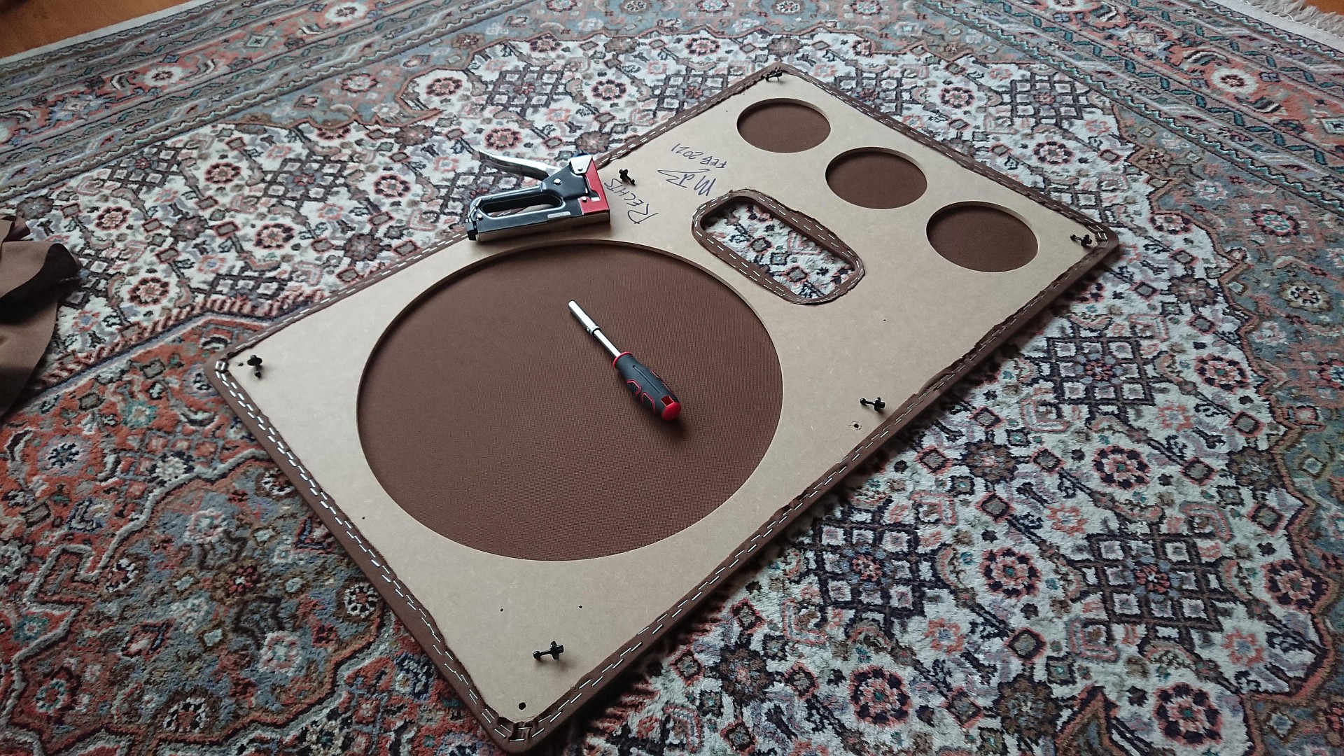

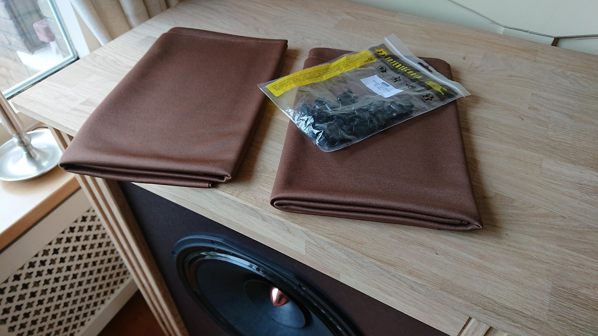

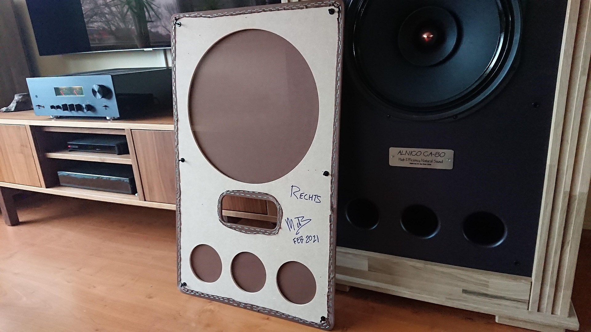

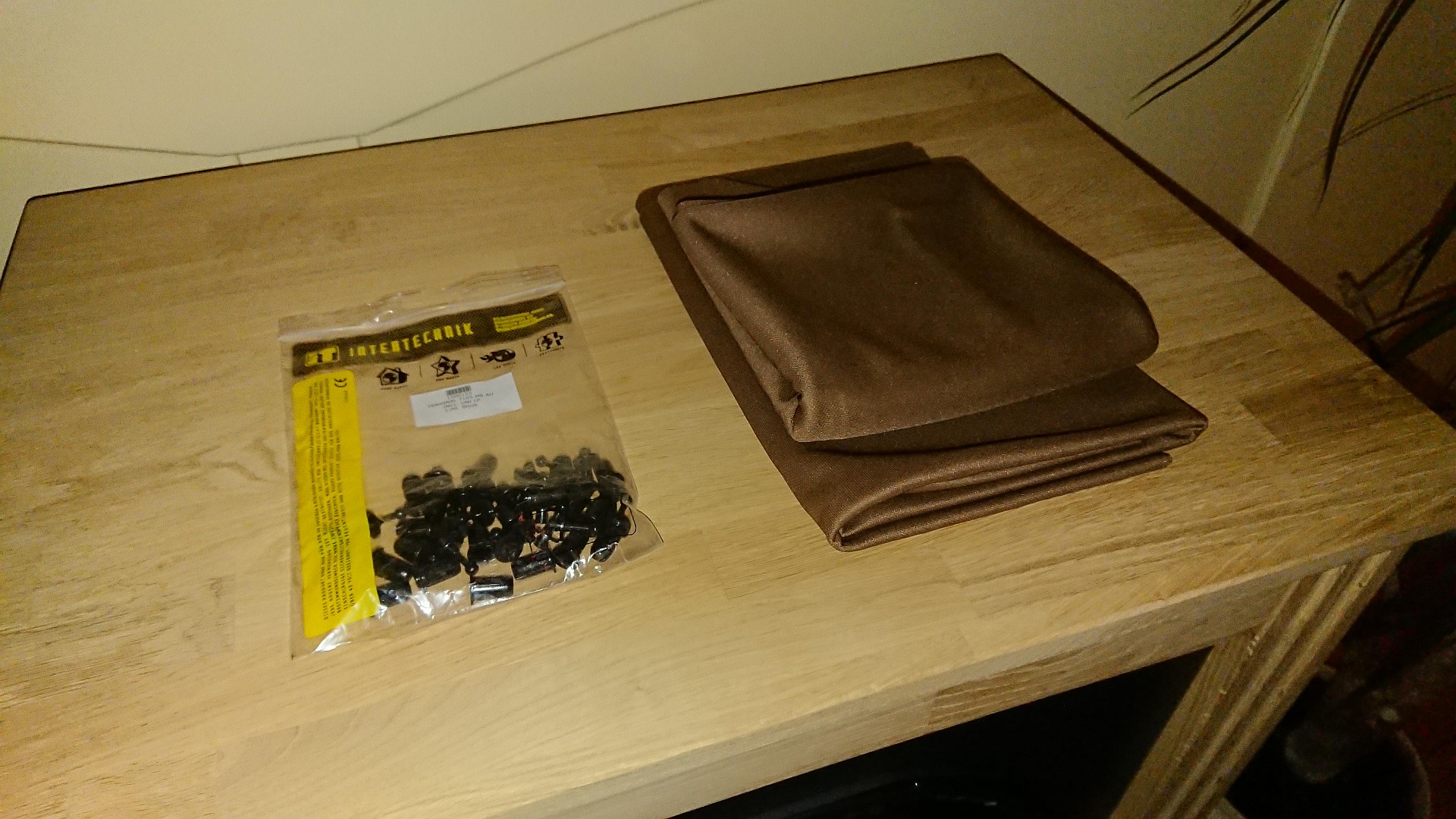

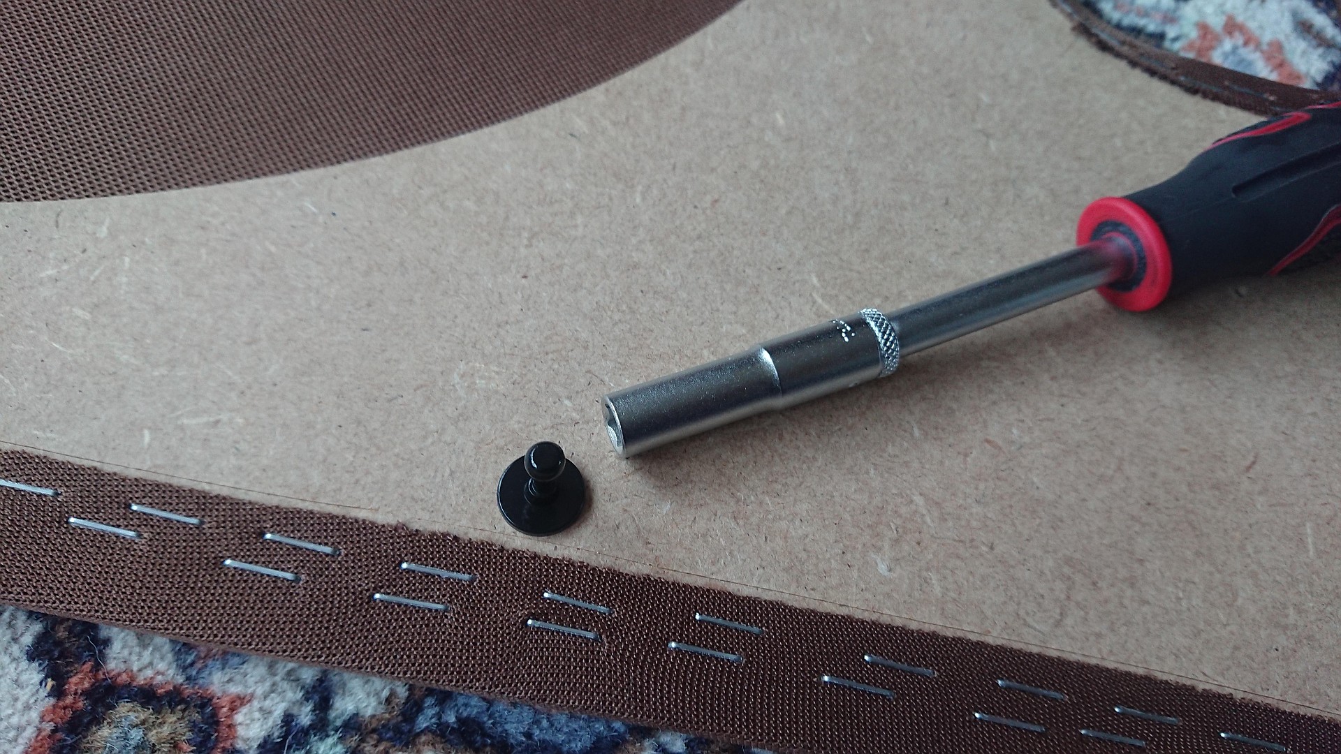

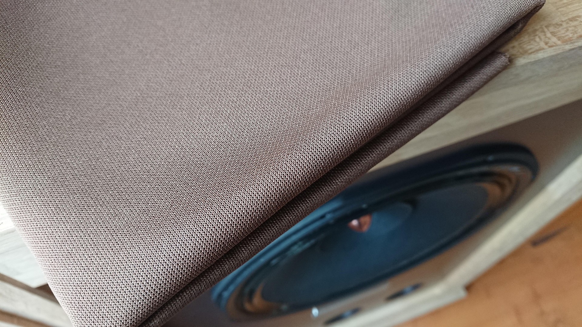

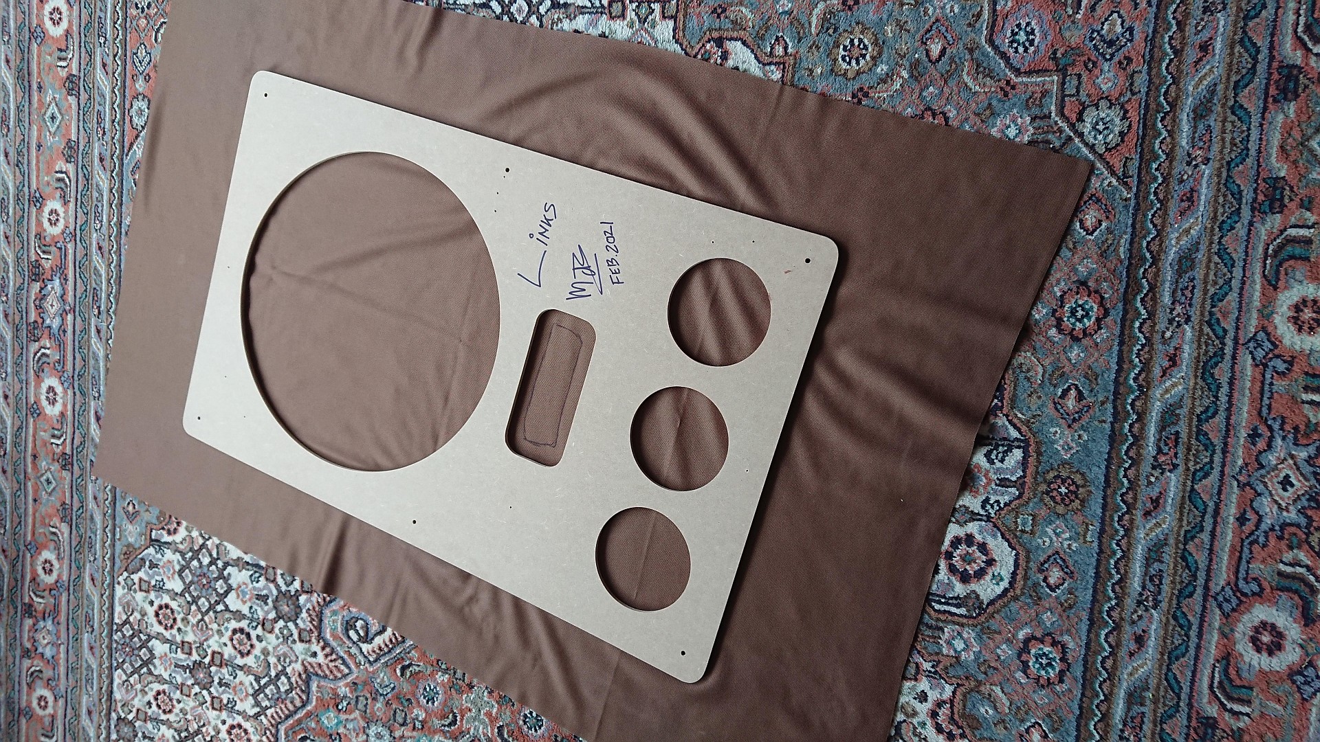

Fronts

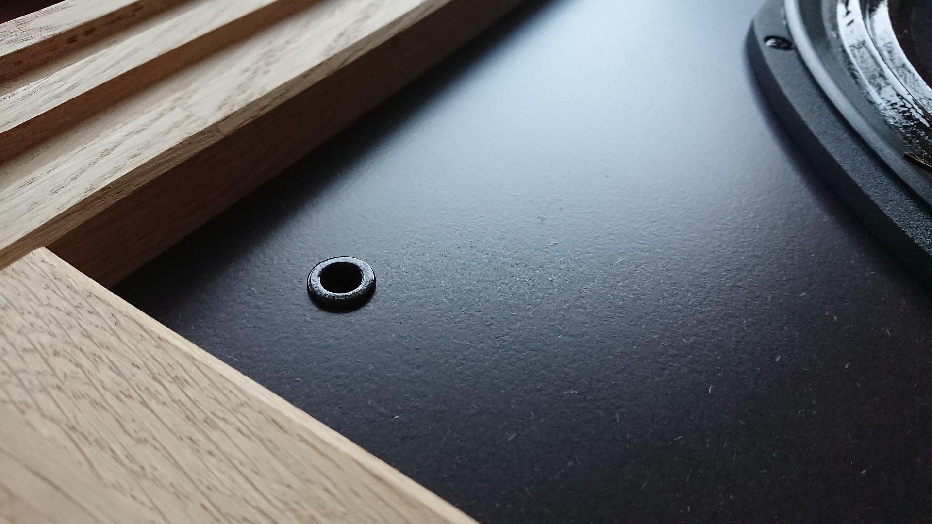

When I'm not listening to the speakers or just playing background music or for protection etc. I like to make some fronts for the beasts.
The color of the fabric matches the interior well.

The fronts
My Cat can't go inside anymore 😀.

Last weekend I sold these nice sounding big beauties 😍.
The Super 15 Alnico drivers are unique and unfortunately not for sale anymore.
Only the Ferrite version is still for sale.
I also have the Super 10 Alnico drivers here for a nice future project 😍.

Yes, they're very pretty indeed. 🙂 Well, as far as a box can be anyway. 😉

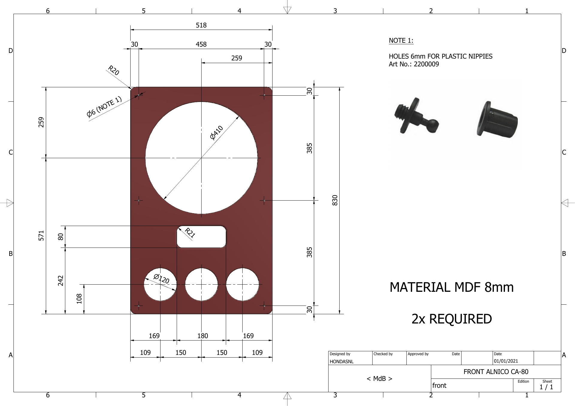

According to those specs., & assuming a voltage source amplifier & 0.5ohm series R for typical wire, connection losses, you should be bobbing with 265 litres; tuning more or less your choice, but with a single 4in duct anywhere from Fs - 30Hz should give reasonable results with a modestly well-damped rolloff that should blend into many room's gain products (deliberately generic use of term for brevity). Duct length roughly 1.875in - 3.375in & adjust to taste.
Thank you so much!
(We are still talking about 3 vents of aprox 80mm?)

Thank you so much!
Pleasure.
No, single duct 4in diameter (roughly 100mm -actually just under 102mm). You can use mutiples if you like; the duct length will start to increase significantly however to maintain the same tuning. Basic rule of vented boxes: for a given volume and tuning frequency, the larger the (total) vent area, the longer the vent / vents need to be.
Reactions: Zoef
Sort of. David at Commonsense, as I recall, basically keys off a couple of the traditional bass reflex formulas that take little account of the actual driver characteristics -that's why a wide variety of AN units with totally different specs. / load requirements ended up getting dropped into boxes that were originally desgined (using that approach) for Lowthers. I haven't been on their site for some time but for years it had so many factual innacuracies and misleading statements it was difficult to take seriously. I should stress, I'm not making any reflection on the drivers nor yet traditional vented box design (which I sometimes use myself). And in certain instances CSA's worked out nicely when it happened to suit the driver -I remember checking a few a long time ago & ran across a couple that ended up with a nice alignment balance. But their results could be a trifle hit & miss because that wasn't always the case, so I wouldn't necessarily place too much reliance on their specific approach to 'theory', taking it in a broad sense.
If you're interested in some of the background to traditional BR design, in one popular approach the cabinets volume would key off the physical driver size. For maximum acoustic efficiency (which was the name of the game at the time) the total vent area Av = Sd. You then adjusted Fb by altering the box volume by ratio to the original: increase by 4x you drop Fb by 1 octave for example; reduce by 4x and you raise Fb by 1 octave. If you needed to adapt the box volume to some other size, you could also do it by ratio to these dimensions, adjusting the vent area in proportion to maintain tuning. You can also alter tuning by changing the vent area, with the maximum permissible always being set by Sd. Like the box, if you reduce vent area 4x, you lower Fb by roughly 1 octave, and so on. It can work well -providing the driver characteristics (including the driving amplifier) suit this approach.
