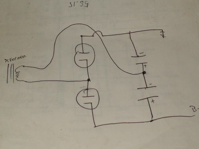

Question - how would you go about making a voltage doubler using tube diodes ? I want to have tube rectification on my next amp project, but it would require about 900v B+ for the power tube, and about 350v B+ for the driver tube (6SN7 into 813). I guess what I am looking for here is a basic primer on voltage multiplier networks so that I can calculate what sort of draw I can pull, etc.

A voltage doubler would be no problem. I have a couple of Mac MC60's that use Heathkit w-6 power transformers in the voltage doubler configuration. I am using 6CM3 damper diodes, which are probably the beefiest of all the old American damper diodes. They are good for at least 400ma each; they do take a lot of filament current though, 2.5 amps each.
Basically you wire them up " in totem pole" fashion, the cathode of one tube connected to the plate of the other; this is where one of your AC HV leads goes to, the other one goes to the capacitors. Look at photo. B+ is at the bottom of picture.
As for the doubling caps, I use 150uf units with no problems of arcing, stripping, etc. NOS damper diodes are built like tanks. I will probably get flak for using such high capacitance, oh well...
Make sure you don't exceed ratings of the tubes.
If you were planning to use a tripler or quadrupler circuit, all I can say is that I have had no luck with such circuits when drawing any kind of current out of them. I have never had a problem with getting current out of doubler circuits though.
Hope this helps, Daniel

With tube rectifiers in a doubler, you may need separate heater windings for each one (even indirectly heated ones), as there will be considerable heater-cathode voltage.
Using a doubler or full-wave bridge on a transformer not designed for it creates extra voltage stress - it would be best to find a hipot tester and make sure the transformer can take the extra voltage... a test at 2-2.5 times the expected peak voltage would make me feel a LOT more confident.

I have a transformer that will give me 313VDC with a SS rectifier. With a SS voltage doubler I get about 615VDC. What I would like to do is make a tube doubler circuit.
I have a 5volt winding that will easily accomodate several 3A rectifiers and planned on using 5R4's since a have a bunch of them.

TV damper tubes are ideal for this purpose, but require 6,3V heater voltage. If you use regular 5V rectifiers like the 5R4 you need two separate filament windings.

IMO, you could not pick a type worse than the 5R4 for duty in a doubler. Its forward drop is high and its I/P capacitance limit is low.
The suggestion Thomas made to use a pair of damper diodes is as good as it will get, if vacuum rectification is employed. They too should have individual, dedicated, filament windings.

Ok, I give up. I will use SS diodes and a damper tube for my supply. Thanks for all the info guys.
I just had to comment on this😉
There were several reasons why I picked the 5R4 rectifier tube.
(1). I have a bunch of them
(2). I was counting on the forward drop being high to work in my favor since
I don't need around 600VDC to start my power supply.
(3). I was under the assumption that I could filter out the nasties/noise from
the power supply after the input capacitor.
(4). Just trying to use what I have on hand instead of purchasing a $100 +
power transformer.
I may not rule out the use of the 5R4 or other rectifiers in a voltage doubler circuit. As pointed out I need (2) 5 volt supplies. I have (1) hefty 5 volt supply and (3) hefty 6.3 volt supplies available. Why can't I take a 6.3 volt supply and lower it with a resistor and use it for my second 5 volt supply?
why not? a 0.5ohm 5 watt resistor in series with your 5volt filament should do it......
