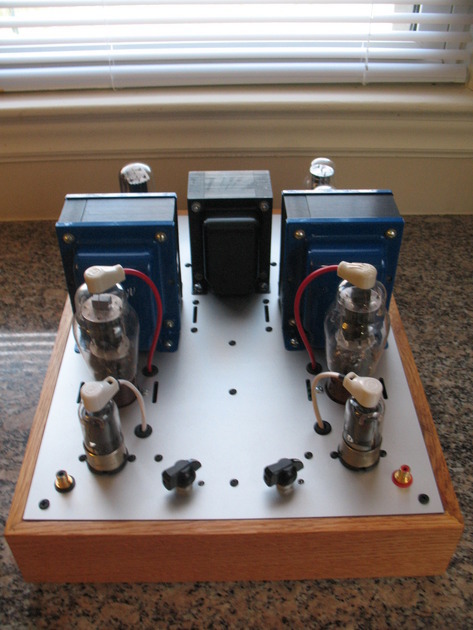

I made a single-ended amplifier using 1625s (12V filament version of the 807) and 12J7s. All plate cap tubes. 5Z3 was the rectifier - not a plate cap tube, but that is easily rectified (ha! A joke!), along with screen regulators OD3 & OC3 - also provided the B+ for the driver tubes.
Regarding plate caps, the vintage stuff works better than the new Chinese units. They grip the cap better. I also used 1000VDC+ wire - double insulation - for the 1625 plate connection.
Just for your possible enjoyment.

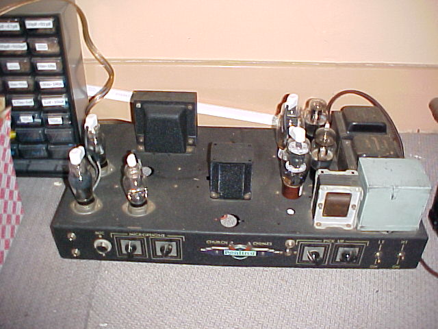

Current resurrection job. An old Church PA Amplifer, built by Healing in Adelaide South Australia with a little badge on the front with reads "Church Chimes".
6J7 and PP 807, 5R4 rectifiers, stacked power supply, 680V to 807 anodes 340V to 807 screens.
ian
