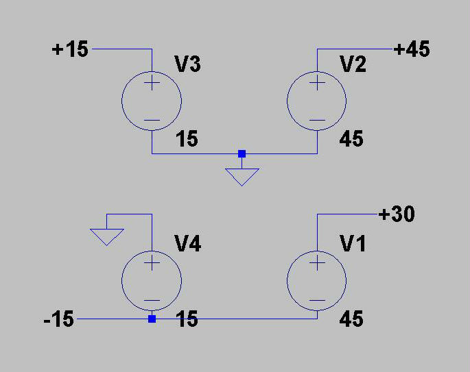

Let’s say for an example that you have an amplifier with output rails of +-45 V and you want to regulate a +-15V supply from these rails. On the positive side you would have +45, +15 and ground, On the negative side you would have -15, ground, and +30V only letting you use -15V for the output rail.
It’s not a problem if you are using a single negative supply and you do not want to use the unregulated supply. But with center tapped transformers and dual unregulated supplies the unregulated +- voltages are referenced to ground so you cannot float the unregulated negative ground.
