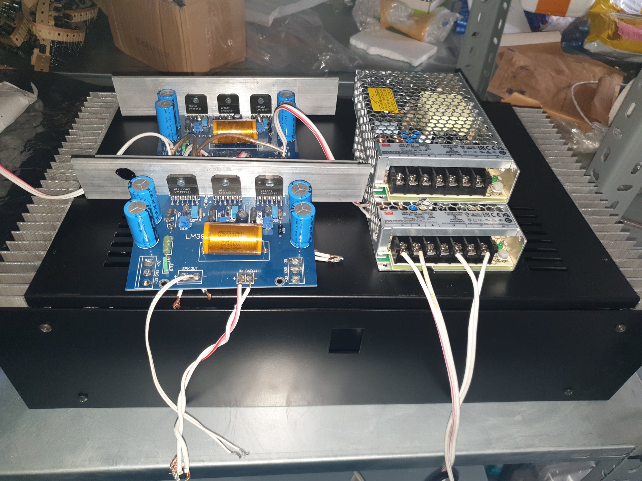

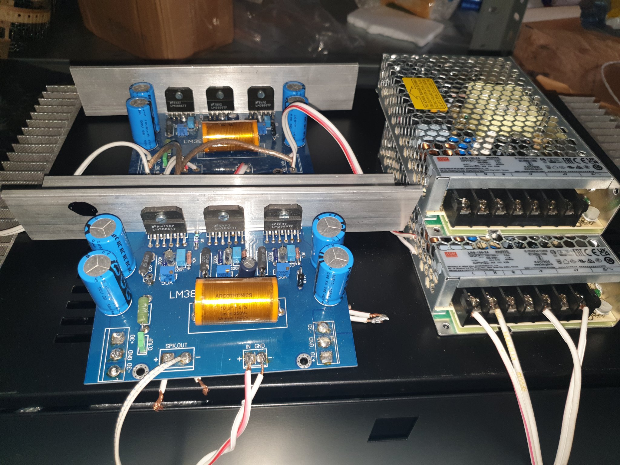

I have these parallel lm3886 amps which I built many years ago. Maybe I can use them for 4 ohm fullranges and maybe 2pcs tda7294 for 13 inch woofers 6ohm Sb34nrx75-6. The amplifier should be small as possible. I will not use this case because it is too big. Amp should be small as possible.
I have 2pcs lrs150-24 but I am not sure I can use them in series to get symmetrical supply( some says possible some not advises) But I need to use them.
Sorry topic was about class A amplifiers but it is transforming to class ab/d because of limited space.I will use class ab/or D for bass.But i want to use class A if we can use silent fan coolers too but it should not interference with sound.

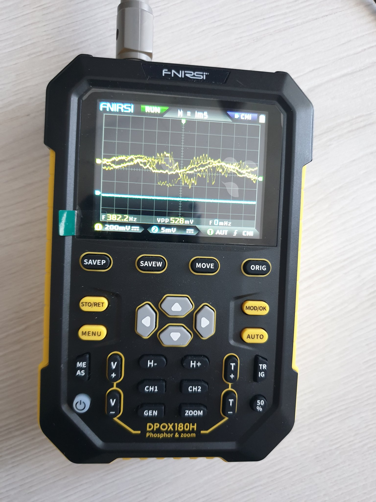

Today I tried 3x lm3886s in stereo mode. First channel has 10mv and other one about 19mv offset. Amplifiers sound excellent! Very sensitive and very well high frequency response. Very detailed and drives 4 ohm fullranges easily. I measured output voltage of amplifier while listening and it rarely exceedes 1.5v p-p output. Sound is high enough even at 500mV p-p output.

The only problem is some smps hiss and sometimes there is a high frequency ringing sound on speakers. Otherwise sound is superb
