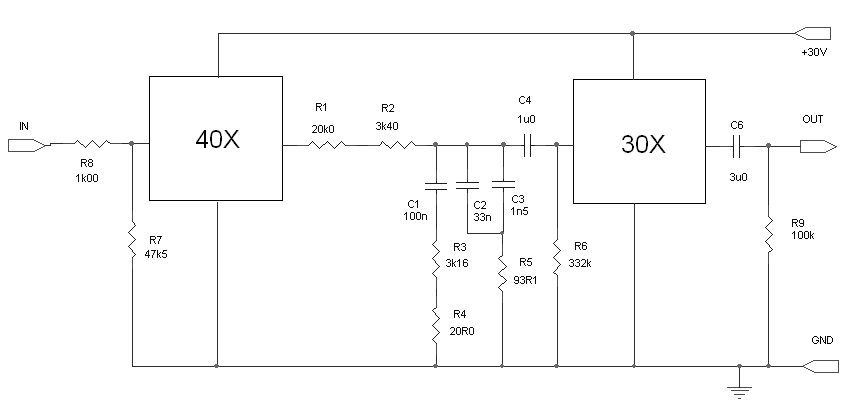

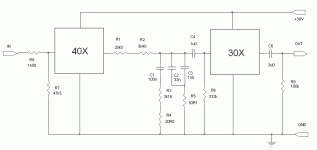

To start off with, the circuit is stripped down to a basic block diagram, reducing it to two gain blocks with a passive RIAA network in between. The first gain block is set at 40, the second at 30. This results in a gain of 40 dB at 1kHz, which suits the rest of my system pretty well. The next posts will talk about the approaches chosen for the first gain block, starting real simple and working up.

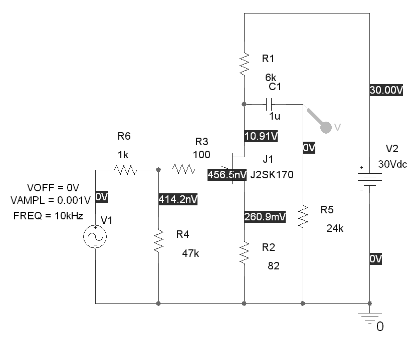

The obvious gain block to start with for the first section of the preamp would be a simple common source amplifier. Since it's the first stage with a small input signal, it should use a low noise device.
A couple of other constraints apply as well. The quiescent drain voltage of the amplifier should be place somewhere near 1/2 the supply voltage, in order to ge the maximum symmetrical output voltage swing. This will help the amplifier to handle input overloads gracefully. Since this is the input section and the output voltage swing is still relatively small, you don't have to be a real fanatic about it. For example, 2V on the drain would be too low. Somewhere around 10-20V would be acceptable (15V or 1/2 the supply voltage would be perfect).
Next, you want to have a reasonable amount of bias current flowing in the JFET. This reduces noise somewhat, and also reduces distortion, as the signal current will be a small percentage of the bias current. In other words, the device characteristic won't vary too much as you're driving it. Again, this requirement is somewhat flexible - 50uA would be to low, while a few milliamps would be ok.
The device I'm using for starters is the Toshiba 2SK170, a low noise, high (relatively) transconductance N-Channel JFET. This is actually the device I started with when I first began this investigation. We'll keep with this device for the first three evolutionary steps, then look for ways to replace it.
The circuits shown in these steps will all be taken from Orcad simulations, and use the default device models availalable there. Actual devices generally be different from the simulator values in terms of Vgs, IDSS, and other parameters. The simulator allows one to quickly grasp the general features of a design. For those who follow such things, reltol was set to 0.0001, and step size was set to 20ns.
A simulation of a simple common source amplifier using the 2SK170 is shown below. A 1k resistor is placed in series with the input voltage source to approximate the resistance of a typical MM cartridge, and the 24k load resistor approximates the loading from a passive RIAA filter as used in my preamp at high frequency. With the component values shown, the gain is 38, pretty close to the target value of 40. Bias current in the JFET can be calculated from the voltage across the source resistor, and is 3.18 mA - not too bad. Calculated p-p current swing at 1mV drive is 0.076V/6k, or 12.6 uA p-p. The 24k load adds another 3 uA to this current, so the total current swing is about 15.6 uA, The signal current is about 0.5% of the bias current so one might reasonably expect the distortion to be pretty low. Quiescent drain voltage is 10.9V, which should allow enough voltage swing for anything short of a gross overload condition.

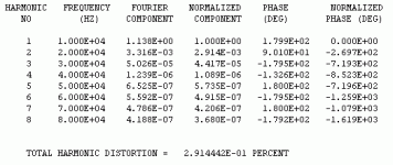

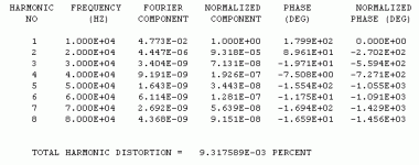

The attachment below shows the simulated distortion characteristics for the simple comon source amplifier just described. The results below shouldn't be taken as complete gospel, but can be used to look at the relative merit of a design. The THD shown is less than 0.01%, and consists almost entirely of second harmonic. This is typical of a single ended JFET amplifier at low drive levels. An actual device might exhibit somewhat higher THD, but the distribution of harmonics should be similar.
So far, so good. There are actual preamps out in the world that consist of two cascaded common source stages with a passive filter in between. The Pacific preamp is one example (a schematic is shown in the thread "Discrete Phono Preamp Designs?") . However there are other factors that must be considered in the gain block design for an RIAA preamp. I'll talk about those later....

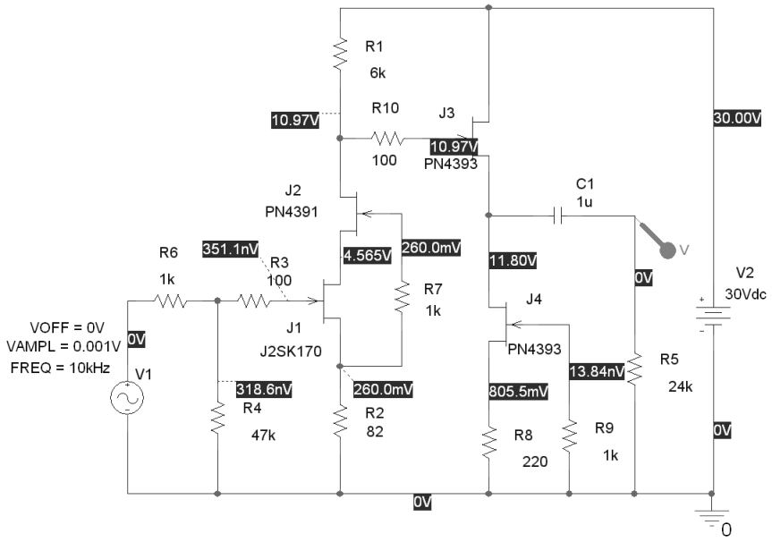

The attached schematic shows a simulation of the cascode circuit described above. Operating voltages shown are very similar to real-life operation. A gate stopper resistor is included on the cascode FET to squelch any tendancy for spurious oscillation.

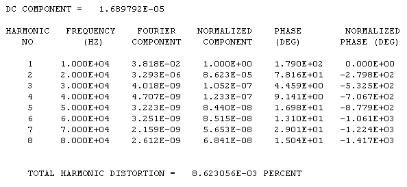

The gain of the circuit is not materially changed by addition of the cascode, and is ~38.5 (31.7 dB). Distortion is not radically changed, either, though the even order components are slighly increased in magnitude. Simulated distortion profile is shown below, and should be used for indication purposes only, though the trend shown is encouraging.

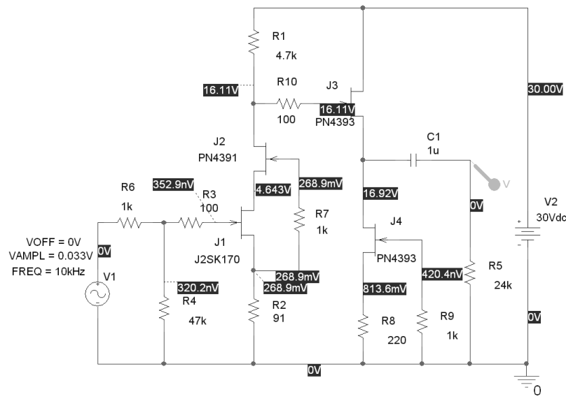

One way to get around this problem is to use a buffer between the input stage and the RIAA network. This can be accomplihed in many ways - I chose to use an all-JFET source follower with current source loading. Utilizng the inexpensive and readily available PN4393. The imulation schematic and DC operating points are shown below. The buffer increases the overall gain of the circuit from 38.5 to 49, due to the elimination of the loading effect. If desire, one could compensate for this by lowering the value of the drain resistor on the input stage. This would also raise the drain voltage of this stage a bit, increasing the available output voltage swing.

Atached is the simulated harmonic distortion of the comon source stage with cascode and buffer. The buffer does not contribute significantly to distortion, according to the simulation.

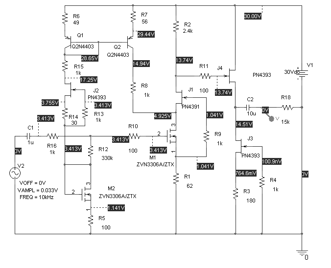

Next we look at the output stage to figure out how to get lower distortion and at the same time, ditch the 2SK170 for something available in the US without a lot of roaring and screaming. Hacking around with simulations in PSpice, I found that the best solution was to use a small signal MOSFET for the X30 gain output stage, and to bias it fairly hard. There are two requirements for the output stage that are not necessarily mutually inclusive. 1) x30 Gain 2) the drain voltage should be near 1/2 the supply voltage for maximum symmetric output swing. I found that if a separate current source was added to bias the gain FET indepent of the current going through the load resistor, one had a fair amount of impunity to juggle values to get the desired gain and drain voltge. In addition, the extra current pushes down the THD of the output MOSFET.
The circuit shown below used a ZVN3306A small-signal MOSFET. Two current sources (J2 ans Q2) were used. J2 passes current through M2 and R5, which are used to bias M1, as it is an enhancement mode device and needs some positive bias to run.Q2 provides extra bias to M1 that does not pass through load resistor R2, allowing one to set bioth gain and quiescent drain voltage of M1 to the desired values. The extra current is injected into the junction of J1 and the M1 drain, which is pinned to a relatively constant low voltage. Since M1 is pinned to a low VDS by J1, the power dissipation is well within the limits of the ZVN3306A. Quiescent current is 17m/A and VDS is 3.88 V, yielding a power dissipation of 66 mW.
J4 and J3 form a buffer to the cruel outside world. In the case of this RIAA preamp, the load is a law-faked volume control with a minimum imprdance of about 15k.

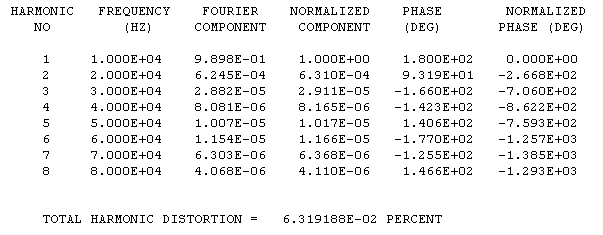

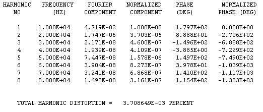

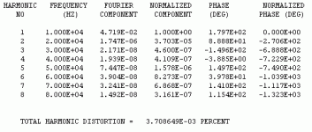

The attached file shows the distortion of this setup. THD is lower than the hard-driven JFET common source amp, though the harmonic content is not quite as squeaky clean us the JFET solution.

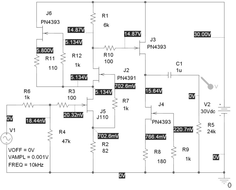

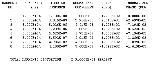

Last step - let's use the principles shown so far and ditch the 2SK170 in the input stage. The schematic shown below shows a possible circuit implmented in PSpice, using the J110. Other JFETs could be used as well. This exercise was not meant as a "buy American" bit of jingoism, but as an exploration in what could be done with parts readily available on the home front. No doubt a similar exercise could be conducted with European JFETs by some enterprising individual.
One more try to upload here, before I yell to admin. Attached is a simulation for an input gain cell using all the bows and ribbons/bells and whistles discussed so far. The FET of the day is the J110, normally a switch/chopper FET, but one that works quite nicely in the linear region, too. I also did a simulation using the J310 RF FET (not shown here). Results were similar, though the bias point was different. Bias current for the J110 in this simulaton was 8.6 mA. The J110 model available in PSpice has a transconduction about 2X that of the devices I've used so far. I've been using a bag of Vishay FETs purchased from Mouser. I may try using some Fairchild J110s I also have on hand, or try selecting devices with higher IDSS to work with, as I am getting about 10 mS transconductance with the FETs currently in my preamp. If I can get the 22 mS shown in the simulation model, that would be a pretty good match for the 2SK170 I'm trying to replace.

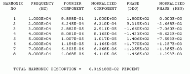

Here's the simulated distortion profile for the circuit just posted. THD is less than half that of the 2SK170 circuit with cascode and buffer at identical excitation levels. Harmonic distribution looks nice, too.
That pretty much covers the rationale behind the circuit I initially posted, which is on duty in my living room as I write this . Any questions or comments at this stage? The thread has been pretty quiet....
