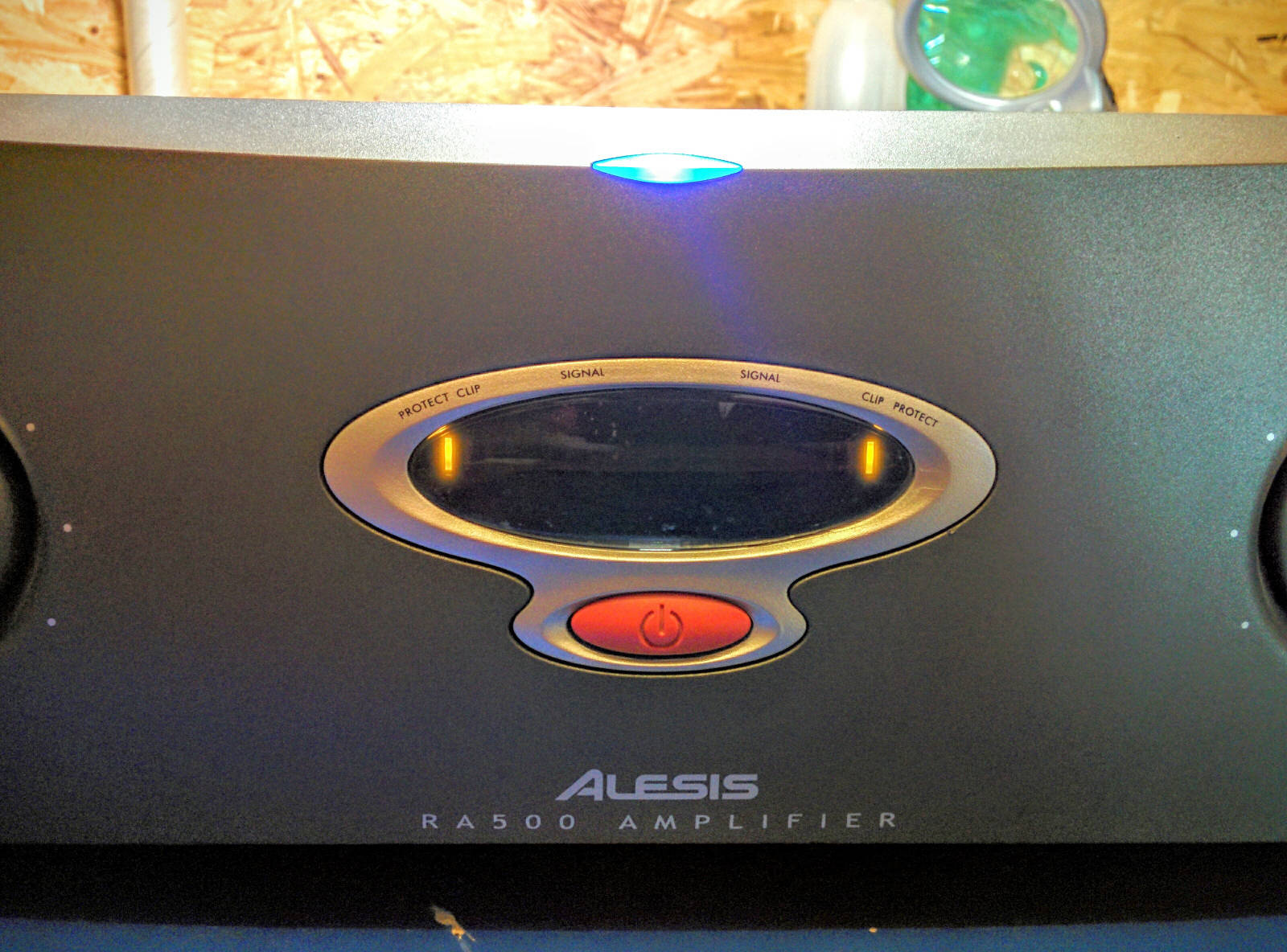

I'm writing cause I have a malfunction on an Alesis RA-500 amp, when I turn it on the proptection leds stay on, and so no output seems to happen.
It happens with both with and without load connected.
Any idea how can I proceed?
User manual says nothing helpful about it
I have some basic knowledge about electronic, but I have no idea on how I can detect the fault.

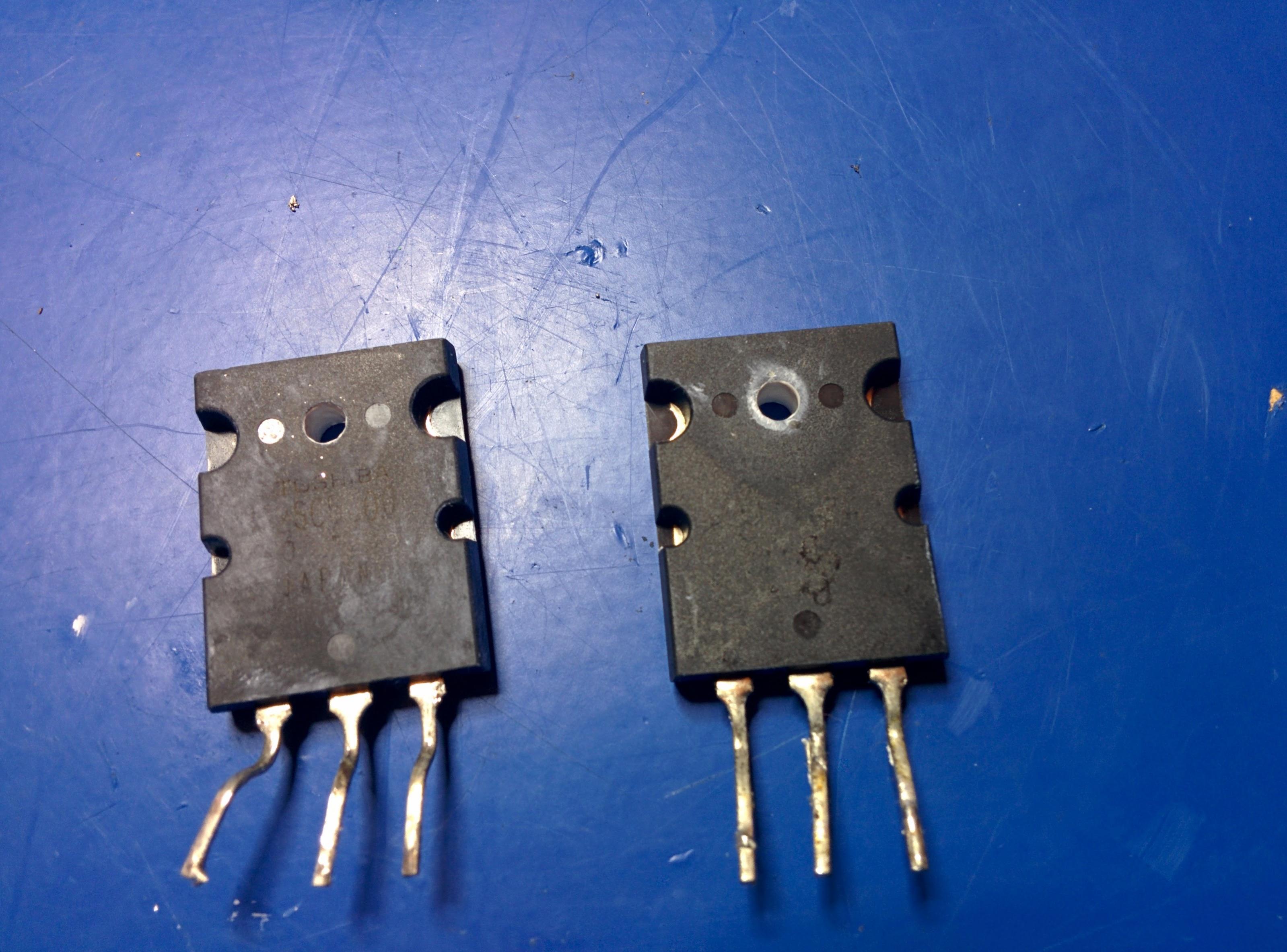

I found the problem, which are 2 defective cascaded transistor on the left output stage of the amp:
-TOSHIBA 2SC5200
-TOSHIBA 2SA1943
First I found the amp didn't enter in protection mode if I disconnected left channel output stage.
So I analyzed the circuit board and found the Emitter of a transistor was desoldered.
So I soldered it, but when I turned on the amp after 1 minute the fuse blewed out.
Then analyzing the circuit board of the left channel everything seems to be connected (shorted)
So I desoldered the transistors and checked one by one (just checked if BCE were shorted) and 1 of 3 pair were shorted.
So I ordered the transistor and new mica (which wasn't in good shape)...
Now I'm waiting for the spare parts, but it seems I found the problem (I hope)
