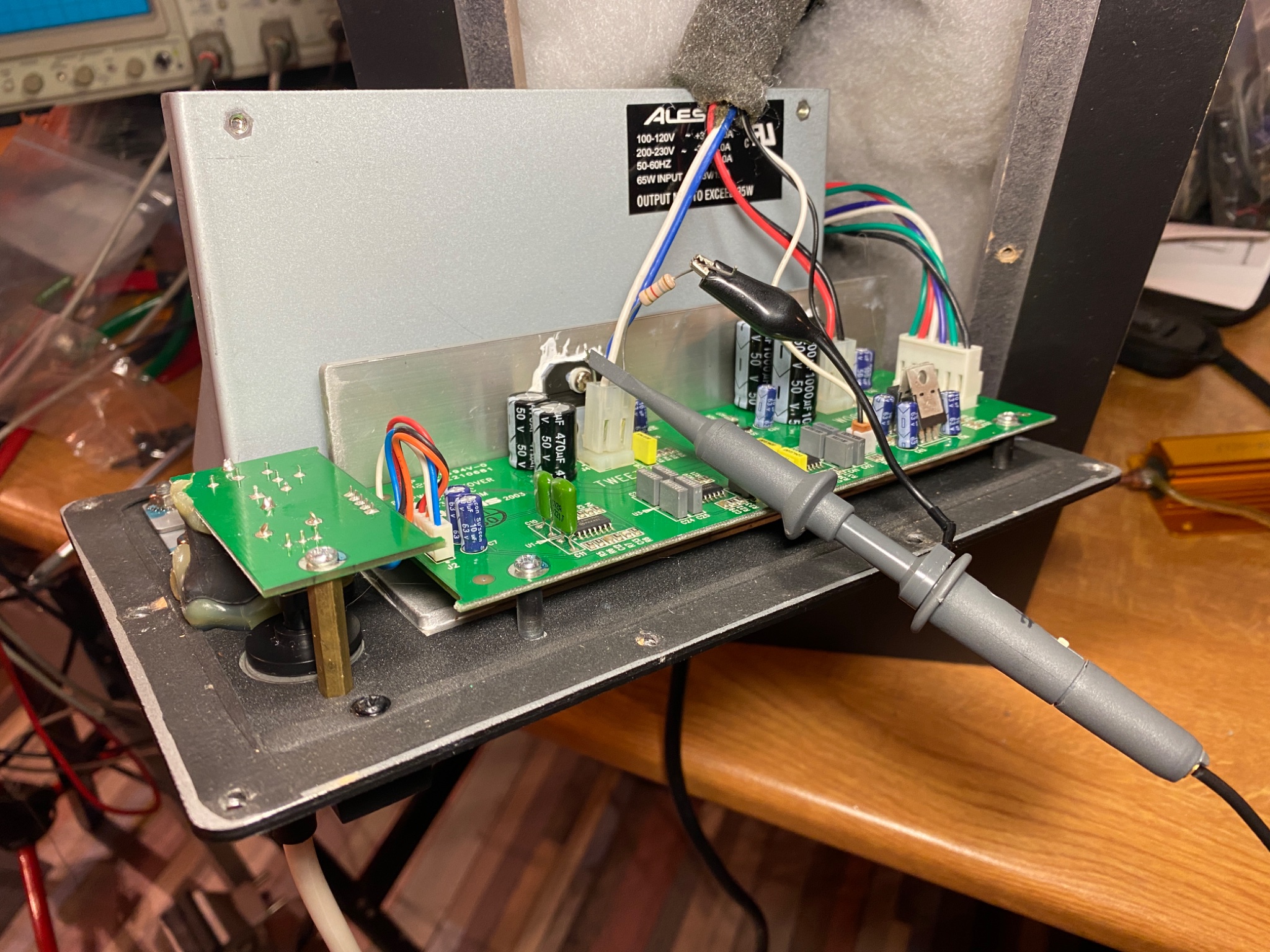

Before I reassembled those powered speakers after repairing one of them, I tried some so simple mod
to improve THD of each amp section.
This can be applied to a lot of amps, when they cheap out a bit on capacitors in the power section…
To prove my point, I ‘ll run a similar mod and video on a Rotel 840 BX II, which doesn’t have the capacitors mentioned on
the schematic ! Increasing many times the original capacitance feeding the power section, is needed to obtain a meaningful
THD improvement 😊, here between -8 dB and almost -20dB on the best of the two power sections…
I cheaped out myself putting only 470uF on some of the two channels, depending on which one it was…the better one or the regular one, to give them a name 😉.
I certainly could have pushed somewhat further than the -80 dB THD figure , I obtained overall, but felt that was ok for these amps 😉!

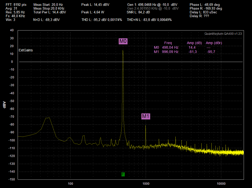

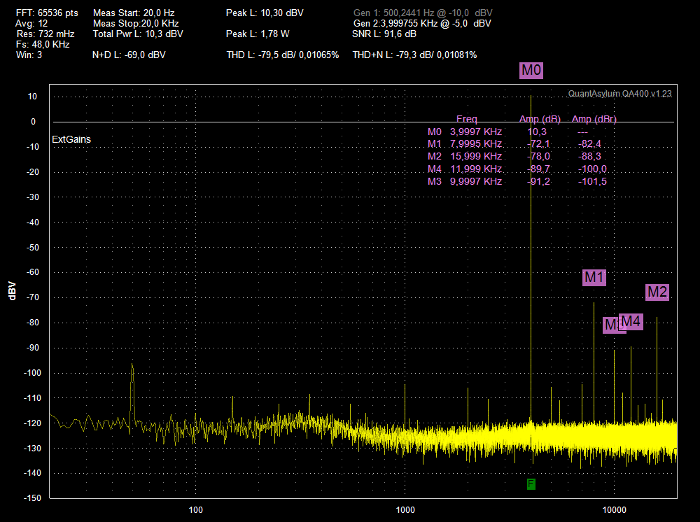

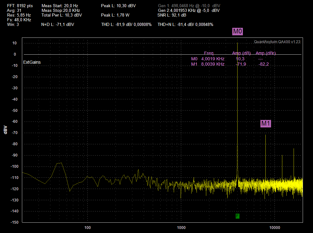

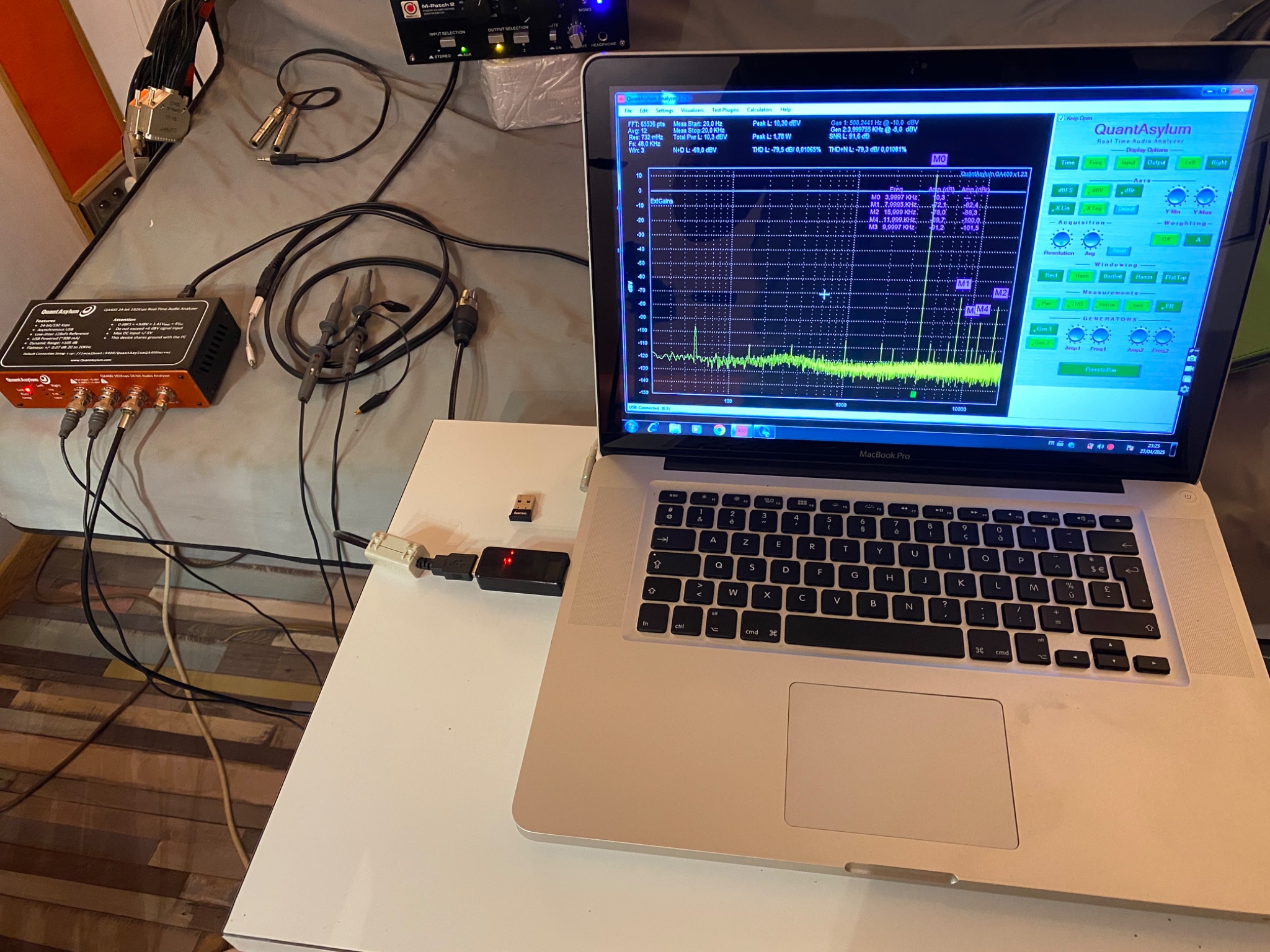

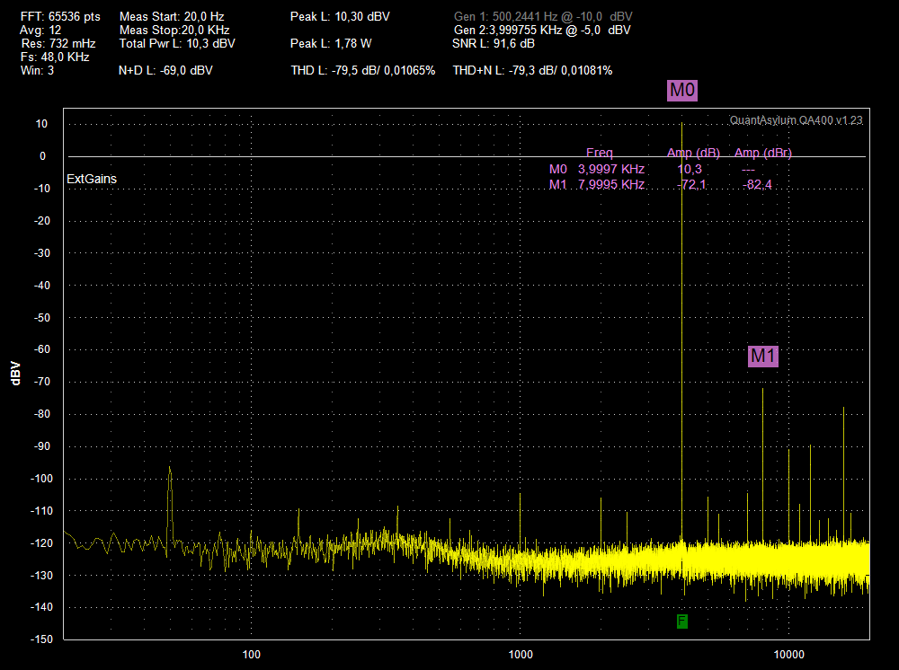

So here is the conclusion 😊!
I devised a simple way without new dummy load resistors 😂 see photo , I piggy backed the speakers…
Results are for the best of the two units (that is the one I re-opened)
With 4,64 watts on the low channel (this is what I was running all along but now with proper ohm input in software , still -10 db in, full volume pot 😉), you can read -95,7 dB THD +N !
On the high channel I was running less than a watt with -10db in , so I raised to 1,78 watts and no impact on THD…you can still read -82,2 THD+N
To make everybody happy I ran a slow 64k ….you can read yourself still -82,4 THD+ N ,
( and I assume that the 6 db lower next closest spur before the rest being -20 dB down don’t really affect the proper calculation… by -3 dB like the -79,3 dB screen figures wants you to believe 🙃)
We started around -72 db THD+N, Conclusion : the recipe works ! 😎
Eric
