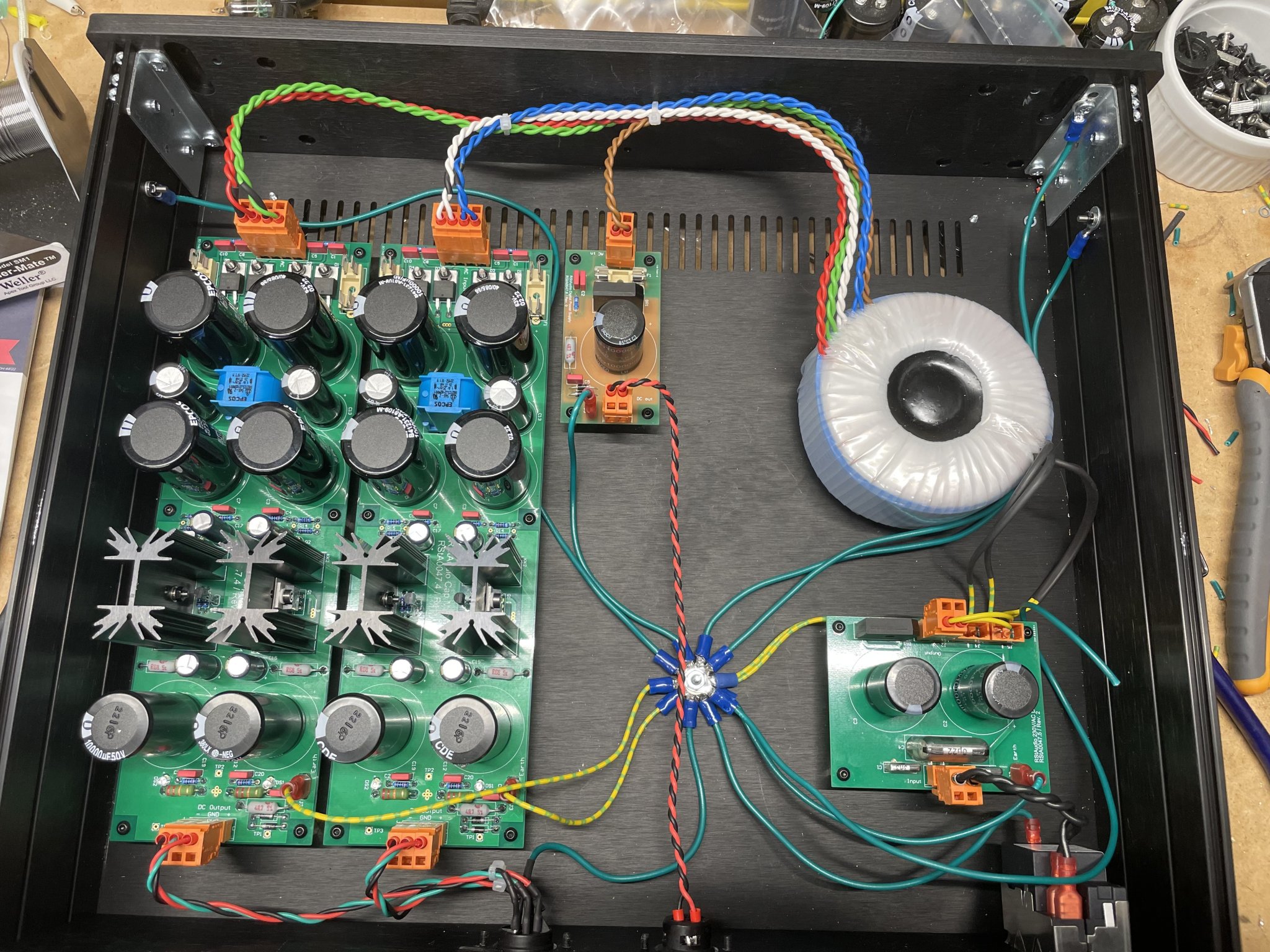

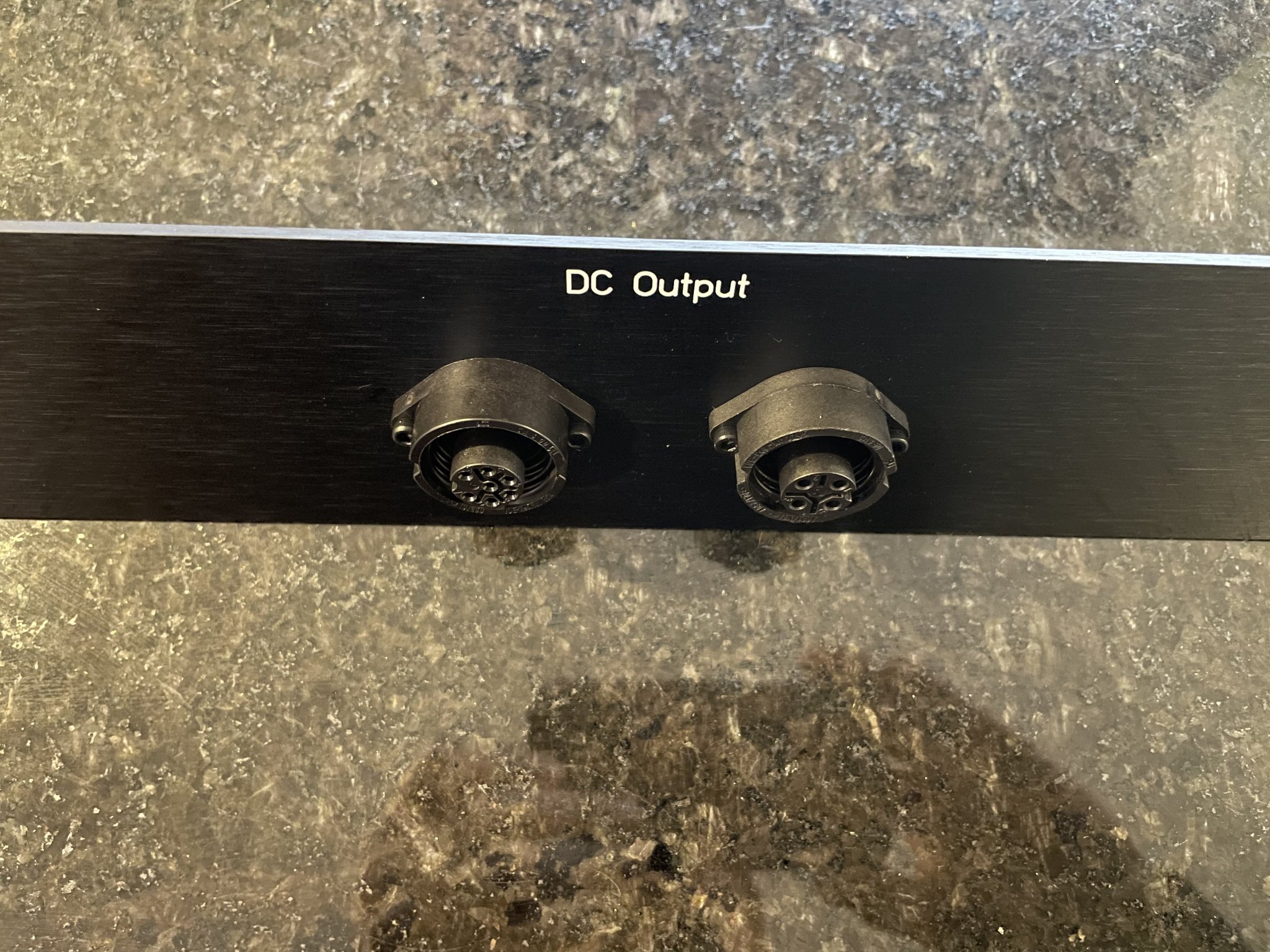

I finally got started on this project. I have to add an LED to the front panel and buy a fuse drawer then test this power supply box. I’ll wait to order parts until I confirm I have everything for the phono stage box. This kit from Ralph is absolutely incredible with amazing documentation. The power supply design is over the top: dual mono, snubbers, fast diodes, CLC with CapMX. Then a similarly robust power supply on each of the phono boards.
