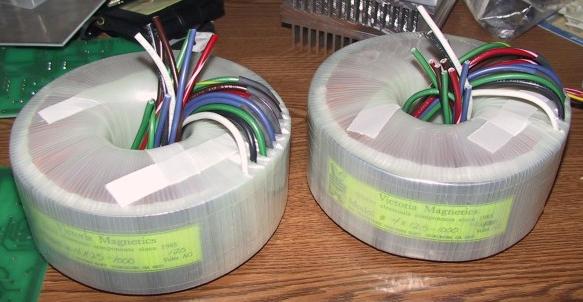

I went down there today and talked to John. For 10 or more transformers, the cost for a 500VA dual 12v secondaries will run $62. This includes a shield on the outside of the transformer. For $65, he can make it 600VA instead, making the wiring a larger gauge on the same core.
For shipping, go to theUPS website and enter shipping from zip code 30071. The weight of 2 transformers is 15lbs.
Here is a picture of what it would look like, except a little smaller (this is a 1kva) and will have dual secondaries, instead of centertapped.

I picked up some transformers for my stereo Aleph5 and stereo Aleph-X. The Aleph5 is 25vac secondaries, and the Aleph-X is 12.5vac secondaries. They are both 1kVA, and have 4 pairs of secondaries for 2 channels. They also both have a faraday shield between the primary and secondary windings. I am going to use these to build both a stereo aleph5 and a stereo aleph-x.
I will also pick up a pair of 600va dual 12vac transformers for a pair of aleph-x monoblocks.
Brian
