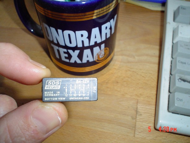

Key factor, in my view, is the relay.
Use a closed gas filled relay with low resistance, fast response, and ample current/wattage rating.
If you want the best, use NAIS(former SDS).
The SDS S4 is not cheap, but is tiny, able to take 20 amps continuous, 80 amps max, responds in 0.005 Seconds, and has a constant flow resistance of 0.008 Ohms if all 4 contacts are used in parallel.
400 VA continuous, 4000 VA Peak, you've got no room for what ?

If you want to be absolutely sure about the relay, find a mercury wetted one in electronics surplus stores in the US. Plenty of choices for very reasonable prices.

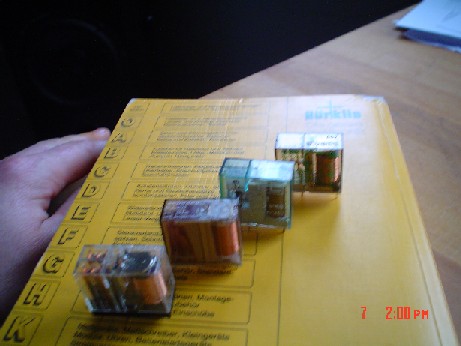

Re: What about this one?
Nice pic, Bro !
It even comes with a spare relay, nice touch.
However, the relays used are regular, of the shelf, types.
Nothing fancy, such as gas filled or mercury types as EUVL mentioned.
Problem with open style loudspeaker relays is that the contacts deteriorate in time, the relay resistance hightens.
A resistance between the amplifier's output and the loudspeaker raises the damping factor, with balanced amps as the Aleph X you have two resistors on the audio signal highway.
Thel's little gadget only has a couple of components that steer the relays.
An electrolytic cap, a diode and a transitor for delayed relay switch-on, a threesome of transistors for fast switch-off.
This kind of circuit has been published a thousand times in mags as Elektor, Electronic world, and the like.
Those guys came up with protection circuits much more sophisticated.
Electronic shops undoubtebly still offer protection circuit PCB's for those without HomeFab. Inc.
Air gap relays sell for 1 Dolares a piece.
(Destroyer has such lovely words, Um Homem Muito Sympatico)
I have zillions of them.
