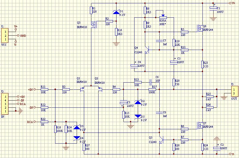

I completed pcbs I bought on ebay, matched all components, everything controlled twice, but when I turn it on, output resistors 0,47ohm begin to smoke after few seconds. Till then it sounds really nice🙂
Both modules behave equally, is there some common problem I overlooked?

I found out what I did wrong - I have installed bc550c wrong way, do you think it did some fatal changes to amplifier module?
..... do you think it did some fatal changes to amplifier module?
if nothing else , at least those smoking resistors are for change
btw. you evidently didn't follow any usual amp setting procedure ....... so it would be nice if you search a little , how to put (any) Aleph amp in work .....

Hey, some people smoke, like me, just um, make sure you use it in the "smoking section" or outdoors Lol, glad you found the problem, sounds like a mismacth or too much current.
