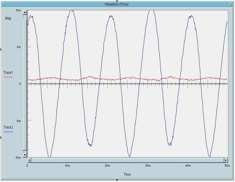

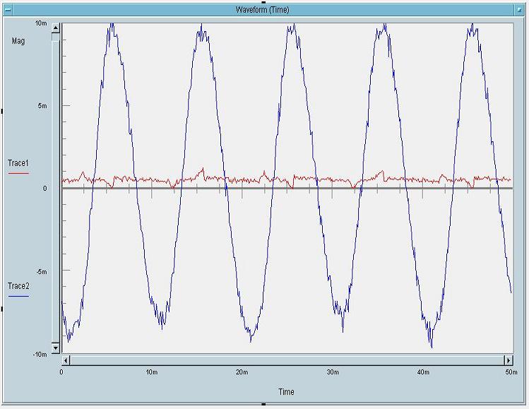

HI,
Here are a few measurements of the ripple I took right now. the funny thing is that the left and right channel behave different.
What in the aleph circuit is responsible for the PSRR?
How does the bias current of the first stage affect PSRR?
Any ideas??
I'm sitting in the lab right now, so I can try things out and give feedback.
Christian
Any ideas??
Christian
... I forgot to say that I'm using a LC Filter now. That's the reason why the ripple is much lower, but the ratio of supply ripple vs output ripple didn't change much.
Christian
Christian
I wouldn't say that there's a good channel, because the ripple of the output is 1/10 of the supply ripple.
The traces are averaged, to only see the 100Hz ripple.
noise is about 15mVPP
noise
