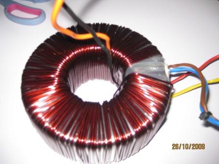

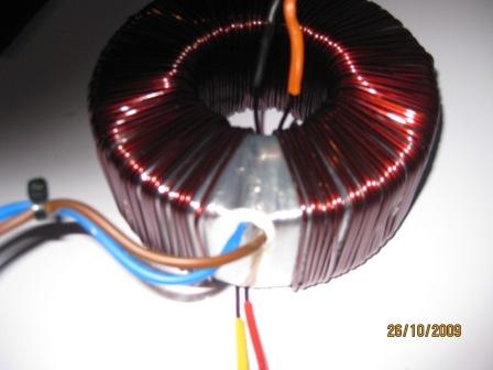

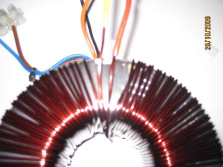

hi guys
heres some pics of one of the toroids with its wrapping removed
i presume to lower the voltage from 40/0/40 to 30/0/30 i just have to unwind each secondary wire the same amount of turns untill i get the required voltage correct?
regards sheafer
oops forgot
the secondarys are single wire looks to be 2mm or more each
regards sheafer
oops forgot
2mm diameter wire is unusually thick for toroid windings.
It is just 3.1sq mm. That has a current density of ~4A/sq mm.
This density is a bit high.
What is the regulation of this 1kVA? 4% or 4.5%.
At a current density of ~3A/sq mm you would expect ~3.5% regulation for 1kVA.
If you remove turns from this transformer you will reduce the VA rating, making the regulation even worse.
hi andrew
the secondarys are made up of 2x 500va each
regulation is 5%
12.5 amp
wire dia is at least 2mm but that is going by eye the data sheet does not specify
brand is nuvotem talema 1kva 40/0/40 from rs components
regards sheafer
regulation is 5%
12.5 amp
regards sheafer
