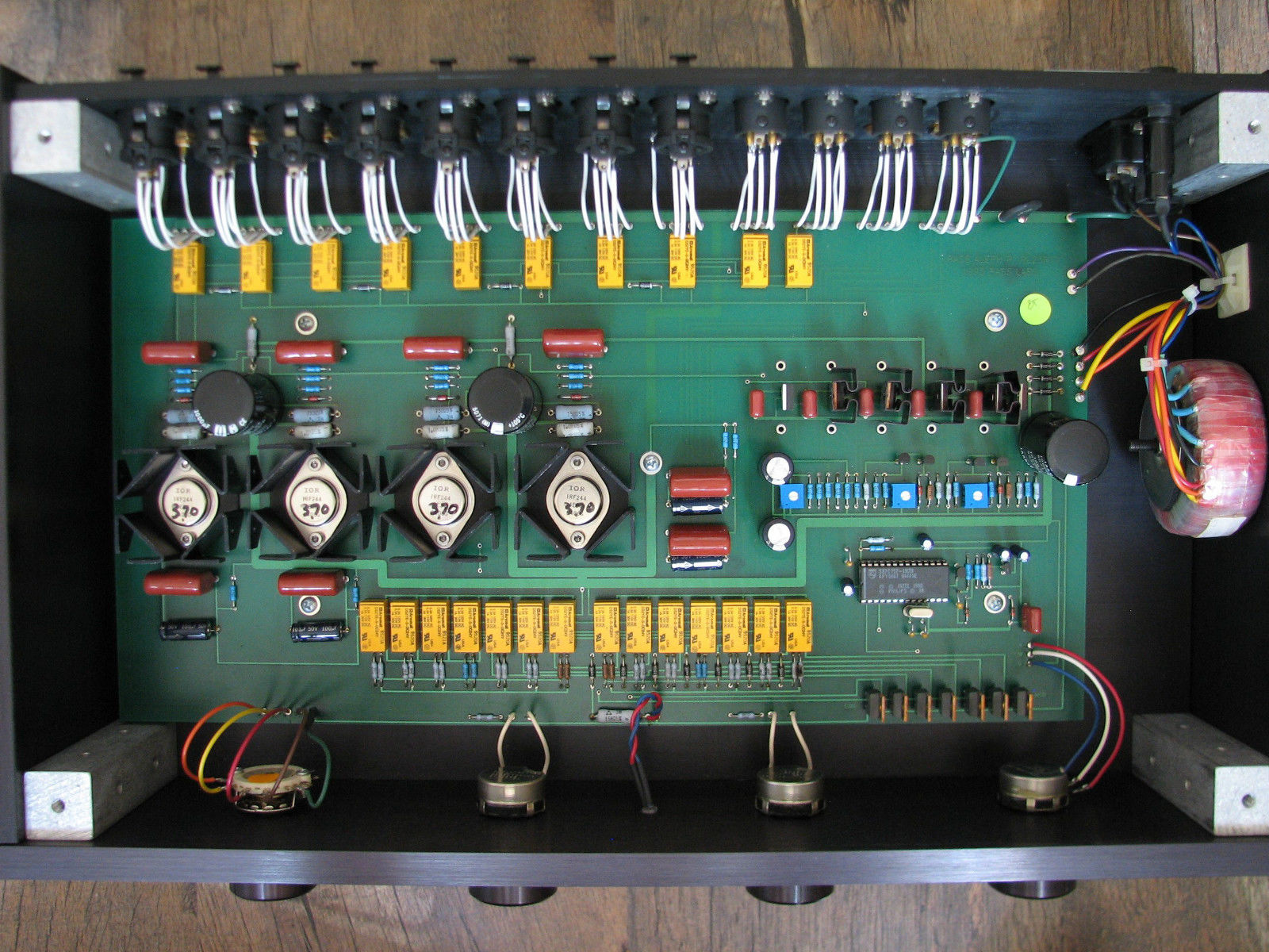

I used to own one (wish I still did). My understanding is the original version used TO-3 cased IRF output devices (1 N, 1 P) per channel. The 2nd version went to TO-220 devices (double the quantity) and added the remote.
I think it is nothing to be worry about.
It is a Rev1.7.
Rev 1.0 look more like in the attached Picture.
In the Service Manual are 2 Mainboards shown. Maybe MK1 & MK2
They differ in some Resistors, diodes and a cap.
Probably the difference is marginal.
The Preamp part of the PCB look mostly equal.

Very interesting picture. The TO3 IRF244 parts are all marked 3.70. I assume that this is a matched quad that all have exactly Vgs = 3.70 at their operating current in the preamp. They may also have the same transconductance at that Vgs.
I suspect that producing matched quads requires a large population of devices to choose from.

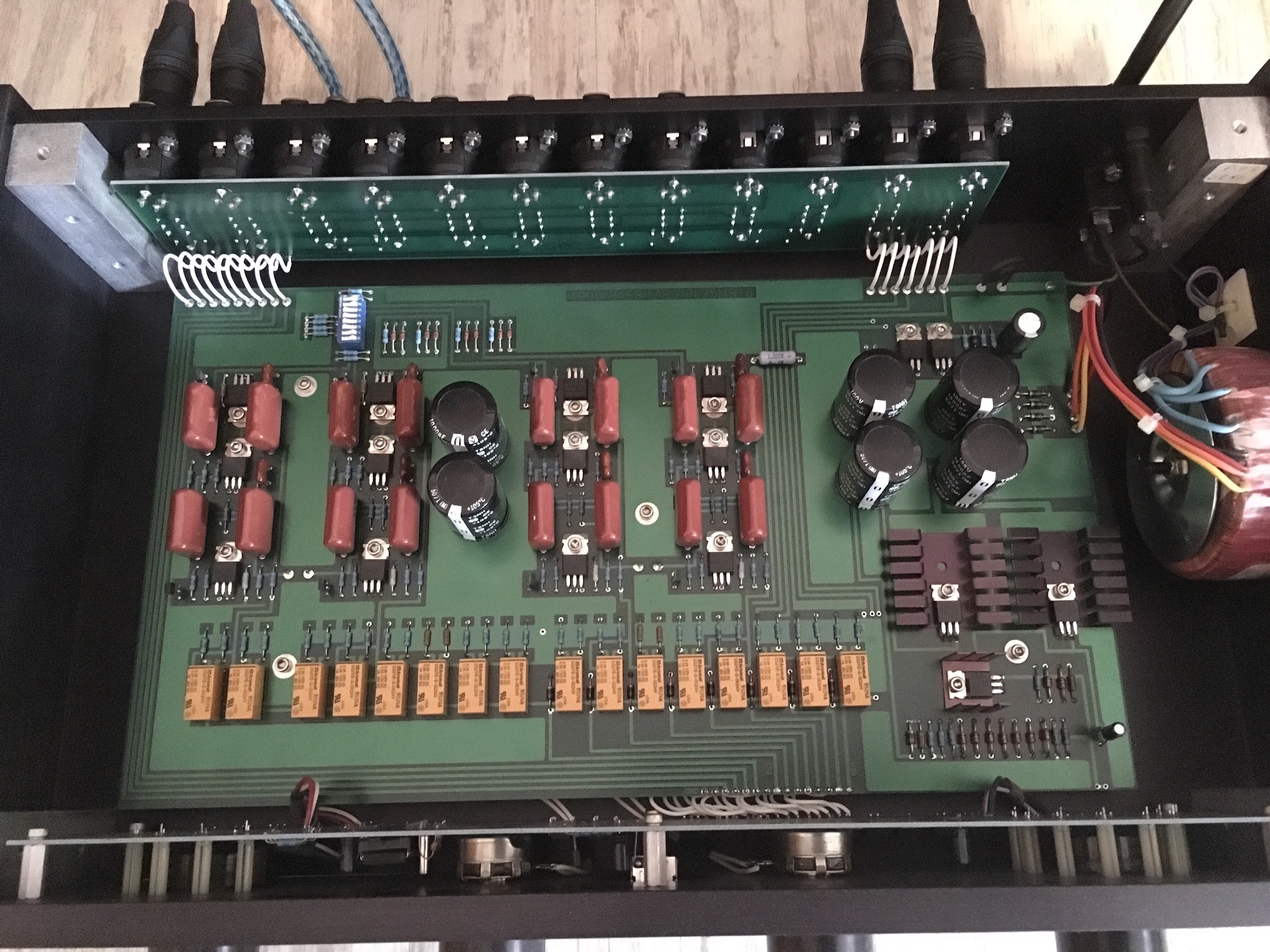

Hello
Even pass Labs (Kent English) can not help
On the circut Boart are the number PL25MB16

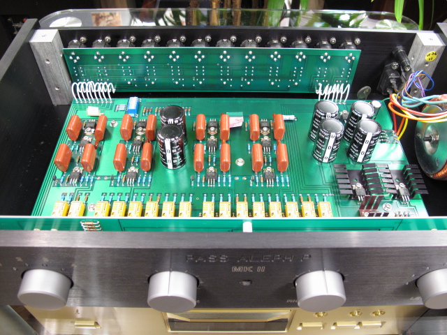

Wo ist denn das Problem? Kannst du nicht schlafen wenn du nicht weist ob es ein Rev1.7 oder Rev.1.7 MK2 ist? Bist du unzufrieden mit dem Pre?
Wenn das angehängte Bild deiner ist, dann ist es auf jeden Fall das neuere Modell welches von vielen bevorzugt wird.

The front panel was never marked Mark ll from us. The mb 16 was next to last revision. The differences are minor.
