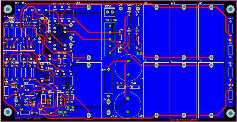

here is the image of the board. please state your interest here. Thanks.
p.s. (I will also consider comments on the board, but you already know that every layout is about compromizes).

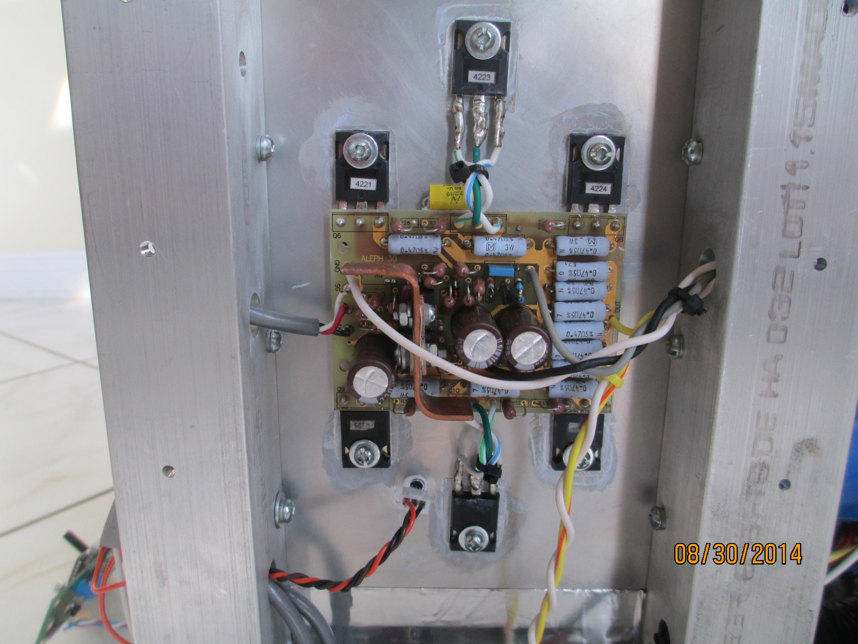

four irf610s are back-to-back at 1/8" inch to share a 3mm thick heatsink (I usually just bend a copper strip in an "S" kind of shape over the low components around. I can post an example pic later today). the two 9610s are also to share a 2-2.5mm thick heatsink back to back. I do not expect much need with current sources at 20 and 30 mA.

on pcb layout
btw the only thing I am not happy with is a little waisted space in the middle between large caps, so I may end up putting a smiley face logo there 🙂?.
Maybe (and that's a ??) I could make it a bit more compact by putting all caps together and moving the middle section to the end of the board and sqeezing it together with the remaining four resistors and two screwholes; the relay footprint is cumbersome to work with, and the traces across the board will become long. after all, no layout will ever be perfect so there is always a question of effort versus returns. this admittedly would be better if a regulator section followed at the end of board and only for those who would not separate it, (mind you keeping PS there would make for one long board though).
btw the pcb screw holes are for number4 or M3 screws.
p.s. no idea of price before the final count: if of any consolation to you I paid $132 for two prototype boards for a digital fan control/soft start/spk protection a friend of mine helped me develop. but the price drops quickly when ordering more. $15-20/piece should be a reasonable target? whatever it will be, I will share the cost off the vendor's site with the group and just divide by piece count.

Ok, it is already clear that it will not be possible to please everybody.
those boutique caps are huge and I cannot blow the whole pcb to that size. Sorry. (If more people are into those I may eventually consider doing something for you only, as a forum favor, but not right now). Wima is the base cap; if that one is not for you aim at something that can fit within those outlines, only pitch may be different.
I realize already that the Spartan relay may have to change for a more available one, (not good for me because I packed everything so tight on the pcb there
). otherwise, any Reed relay, (gold or not but with vacuum preventing oxidation) will garantee superb contact quality over a long time.

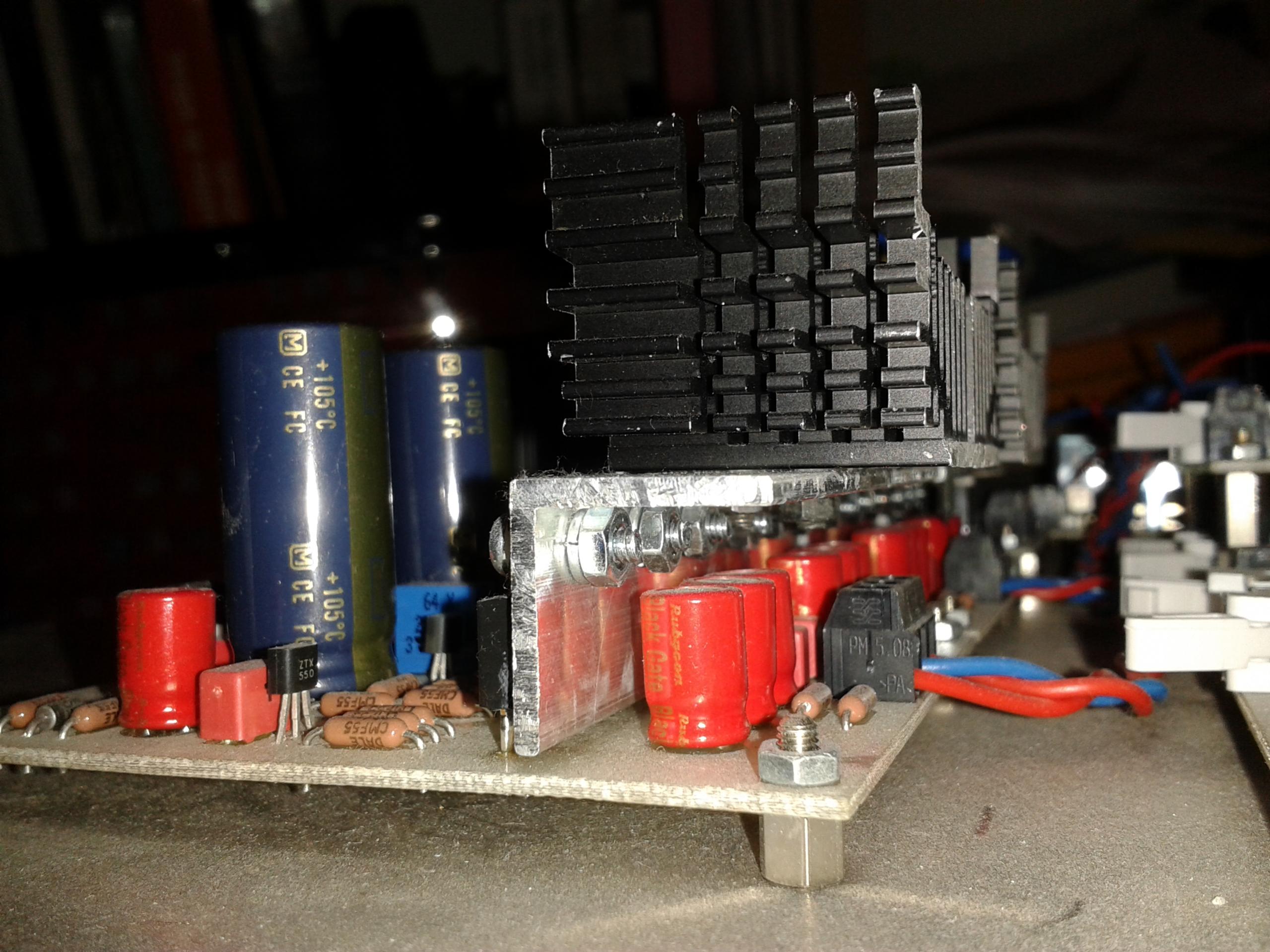

anyways, I promised Yoke to show the example of how I go about cooling the fets. here I show the pic of my aleph30 board where three 9610s share a copper strip. on AlephP board something along those lines will be possible as well. (maybe a "T" shape aluminum channel with some holes on top?) your imagination is the limit. be warned: if I like yours better I may copy you 😎.
well, this is what comes to my mind, how to solve this...but...will see 😉
with L shape...
p.s...sorry, don't know why is picture this big

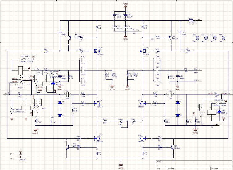

What is the resistor footprint? Can it accommodate larger resistors like Vishay Dale CFM60?
Can you post your schematic so that we can check the board layout? I realize that the changes to the original should only be the attenuator, but it would be handy to have the whole thing on one sheet.

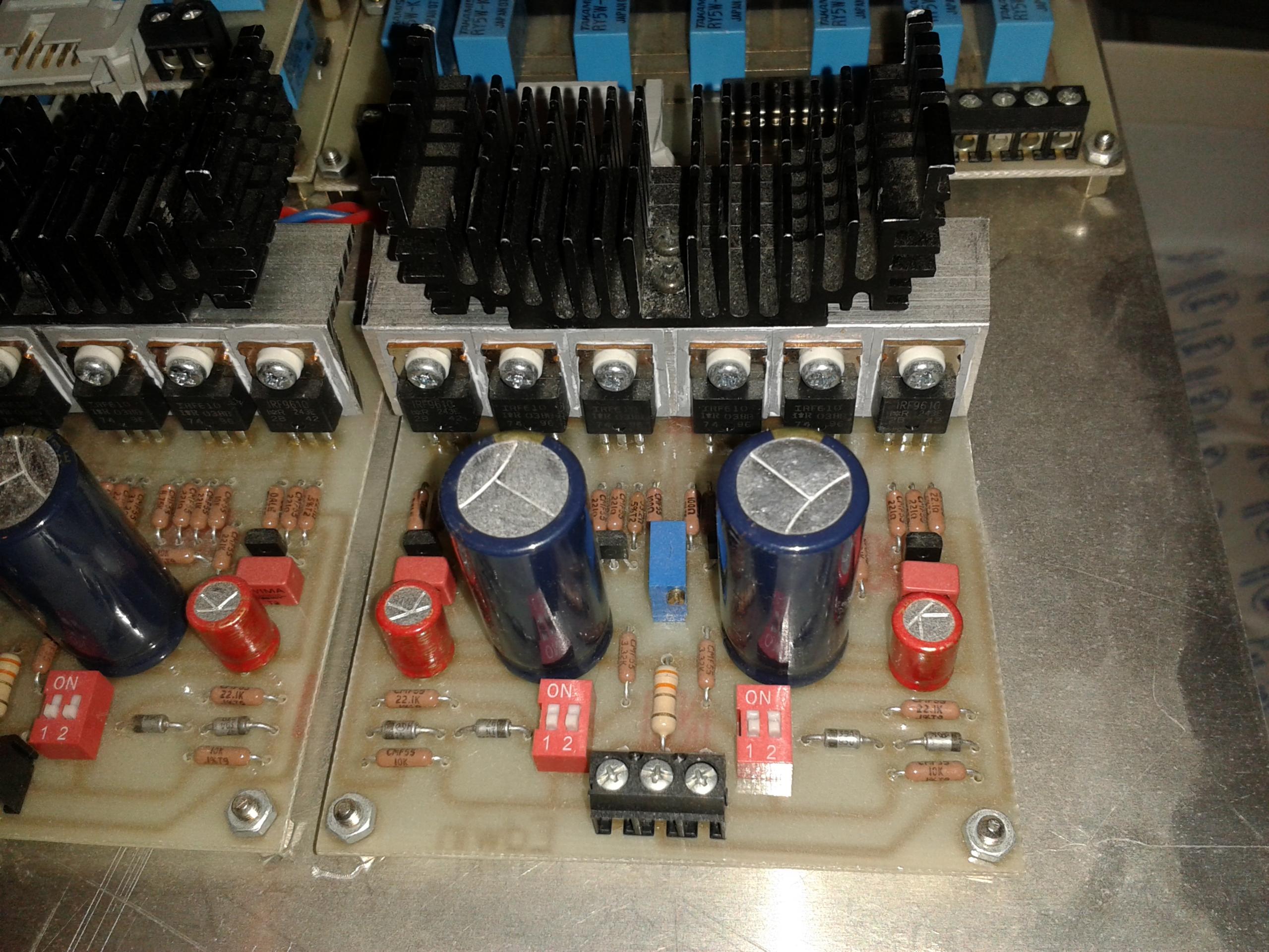

This is how I lay the FETs on my AlephP. I use aluminum L shape profile to attached them to the heatsink. All FETs have their back on a straight line.
I'm using BG-N caps (under the heatsink)... smaller than Wima MKP.
I have designed a PCB using Wima caps and I have bought the MKP... but boy they're big!

the resistors are assumed to fit P:10.35mm; body:6.8(L) x 2.8mm(Diam)
only R44 and R59 (22.1Ohm) off the rail are stood up vertically, and R73 (3.3Ohm/2W) is on a bigger footprint P:20; body: 16.5(L) x 6.5(diam).
btw: the transistors for constant current sources are marked as for ZTX450/550 (as in the original schematic), so if you decide to use BC550c/560c you will need to flip them 180deg since pinout is different.
