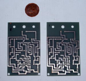

FWIW this is my interpretation of Ono. Transformers are separate. Active circuit contained on a small board. To achieve shorter signal path, I mounted resistors on the traces' side (actually I made a mistake). DC coupled, MM stage only.😉
I wanted to built it fast. The circuit was so small that I had enough space to fit PS (and it's separate for ea. channel). The caps were ROE 1000u, Sprague Extralytics and Panasonic HFQ 150u. I didn't even built an enclosure for 2 separate transformers.
If I would be doing it again I mount phono module directly on TT output, no interconnects.
Peter,
If it's not too much trouble to find the layout I'd appreciate it, although I think it's probably better to make a design where the riaa components are not off the board.

Peter,
Can you elaborate on the trimmer on the differential pair? Do you mean that you put a trimmer in between the sources of the two halves of the sk389? If so what value did you use?
Thanks, and thanks for the photo of the layout, although I don't think I can do anything with it 😉
