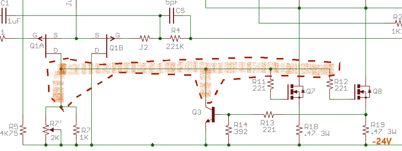

My trouble: One channel is functioning as expected, and I've been able to zero the output and set the bias, but the second channel is sending V+ (25.7V) to the output. Messing with R7 has no effect.

The drops you asked about measure as follows.
D1: 9.07V
R7: 0.0V 😕
R8: 8.27V

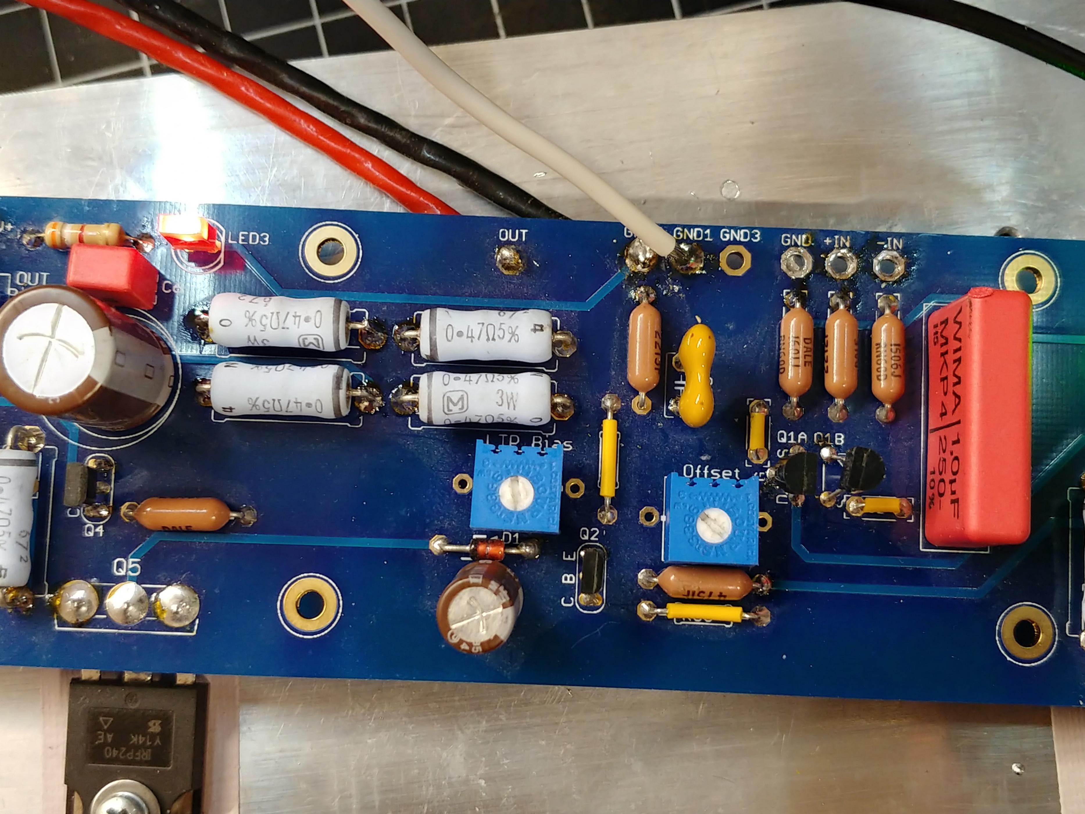

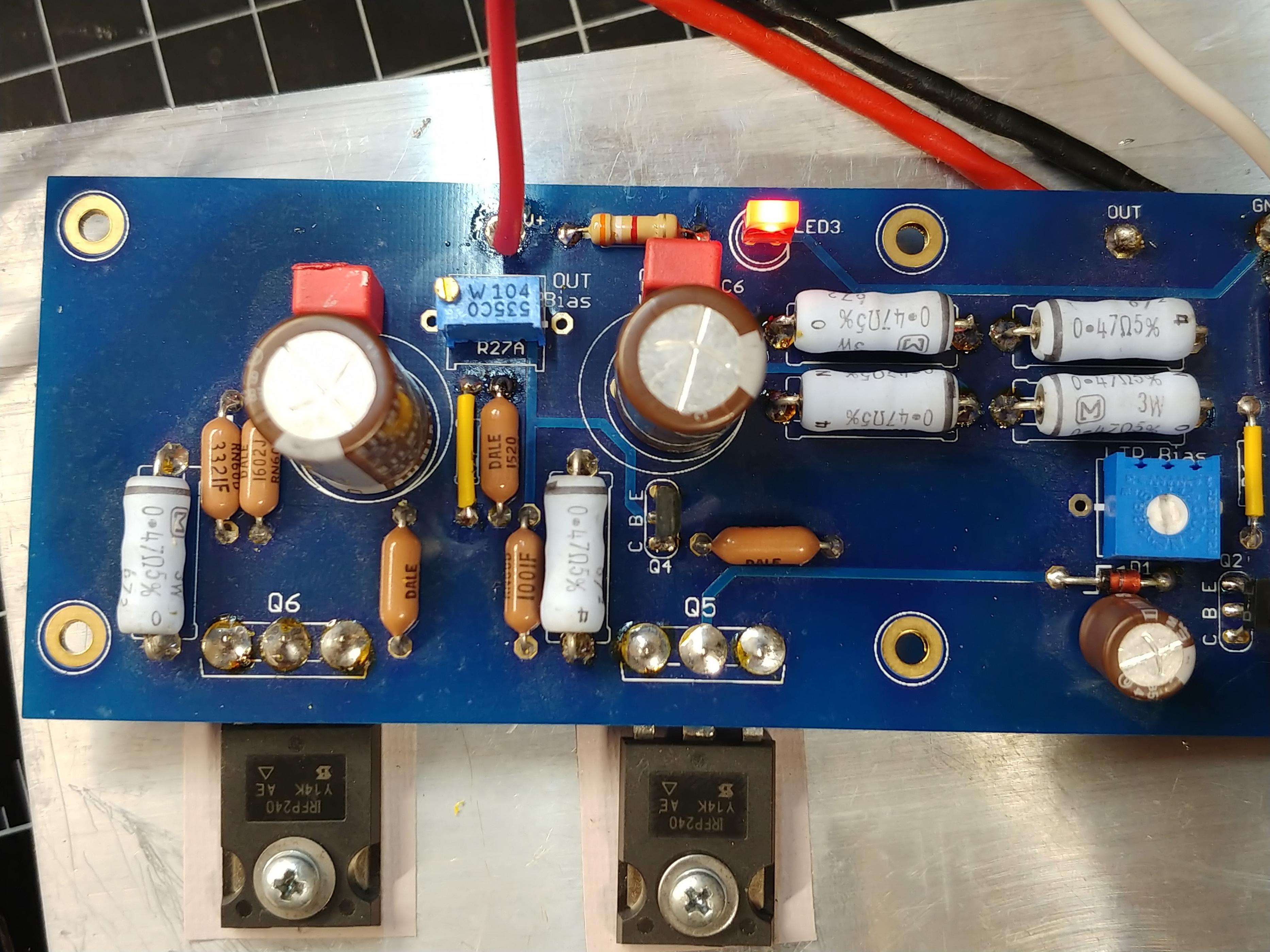

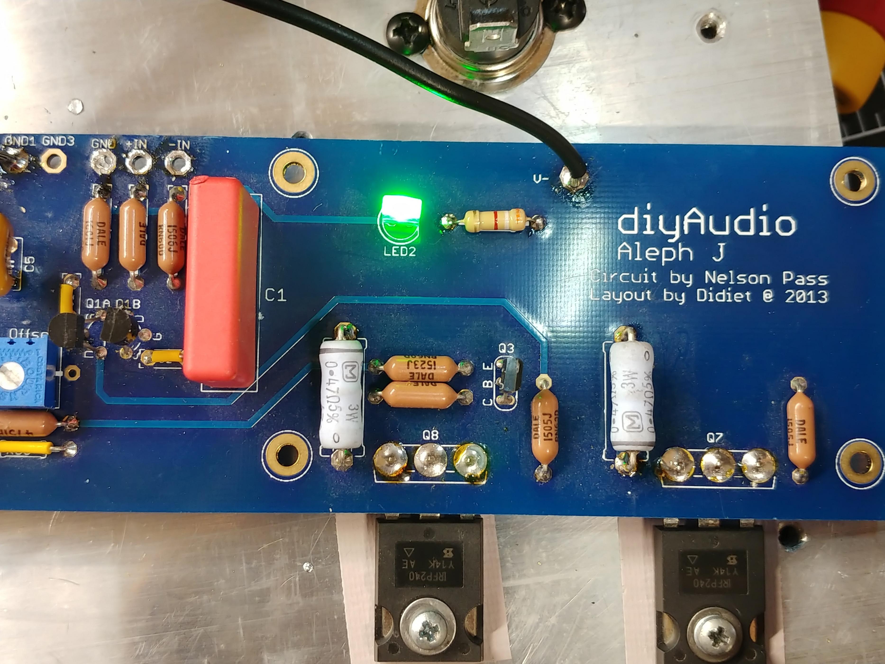

Also attached are photos. I think the clarity is decent but I can retake as warranted.
Thanks!

With the channel powered, adjusting R7 doesn't change the voltage drop across it from 0. Measuring the resistance across it (with the power off) I can read between 0.1 - 1.8k ohms.
Also of note: The LED's on the misbehaving channel take MUCH longer to dim than on the working channel. ~1min vs 10sec or so.
THIS WAS IT!!!
I swapped in another pair of LSJ74's and I've been able to dial in 0V at the output.
I hadn't thought I'd get to the bottom of this tonight. Thank you both so very much! Now to put it all back together.
