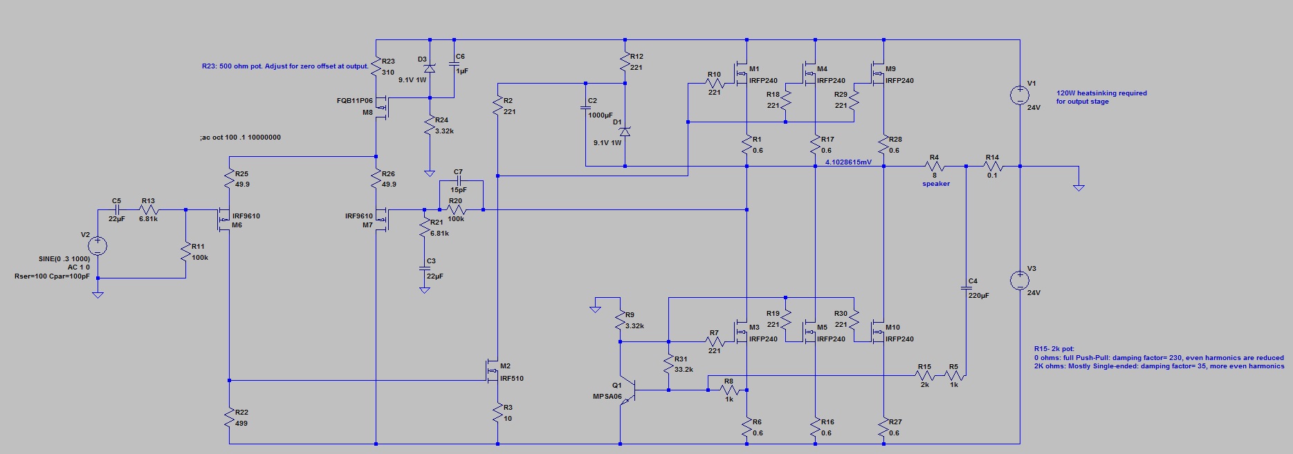

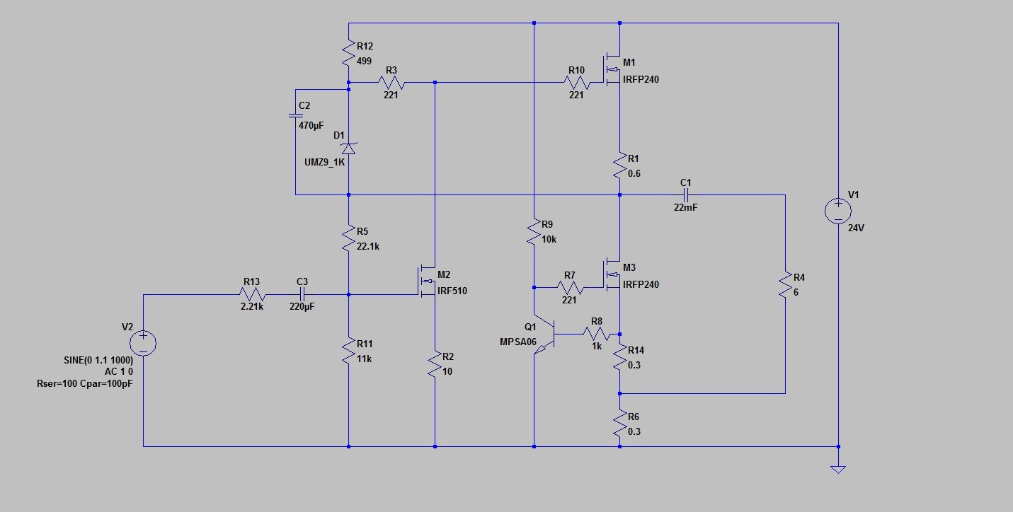

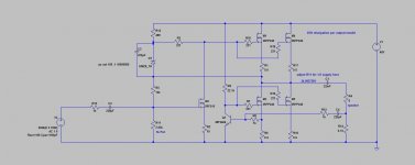

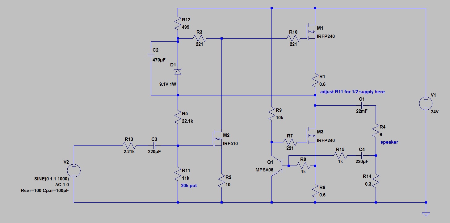

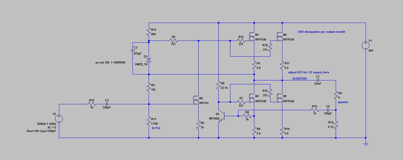

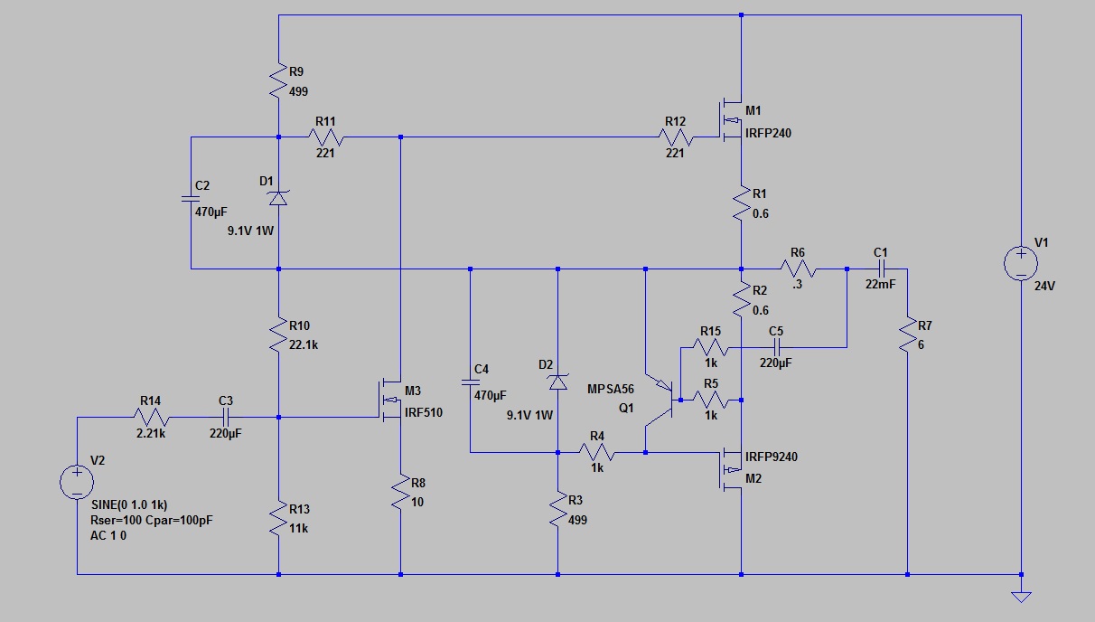

I was playing with a few circuits today:
1st: 6W single supply
2nd: 25W single supply
3rd: 25W dc output
What do you think? Anyone try this yet?

As a concept it will work fine, but this circuit can do that trick without
driving the Gate of the current source transistor. You can feed the output
of the speaker directly to the top of R6.
Usually the function of Q1 for this is as a constant voltage source (for AC
anyway), so you might want to experiment with filtering its action at audio
frequencies, maybe starting with a big cap across Q1's Collector to Emitter
and maybe increasing R8.

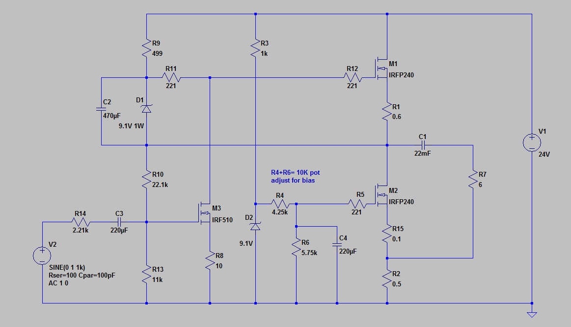

Is the idea to fix the voltage at the gate of the current sink for the DC bias using Q1, and then modulate the Vgs using the speaker current? Is this what the bootstrap is doing on your Aleph source?
Or, is it better to switch to a P-channel and just implement the standard type of Aleph sink?
Both will work, but neither needs R1.

I played with this type of circuit a couple years ago. Never quite got the THD down enough for my liking, but maybe you can with a gain stage and some negative feedback.
