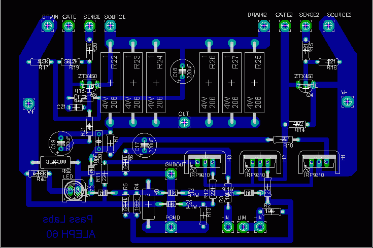

PCB looks good to me ! Did you use Eagle for this PCB ? (I'm 100% that this is Eagle product 😉 )

Few suggestions....
1) As V+ and V- tracks are thick, probably >200 mils, why not output tracks? They carry the same current.....
2 )The diff pair (9610) should be mounted back to back (with insulator and plastic screw!) in order to share the same temperature.
Nice job, anyway
Nice job, anyway

Yes, it's Eagle and I think that is the best software for begginers(like me ).

Grazie Massimo,aprezzo molto le sugestioni e li prendero in considerazione

This is absolutely true. I don't find any other software that is that easy to use as Eagle is. I'm currently learning to use P-CAD 2000/2001, but is much more compicated than Eagle. All my PCB DIY audio project was done with this "refined" software 🙂

I have around 40 (forty) pieces of IRFZ40 in TO-220 package. Does any one think that they would be suitable for this project (Aleph 60) or even ZenV4 (maybe two in parallel in each position).

Because I have more than 40 pieces of IRFZ40 Mosfets do you think I can use them in the output stage instead of the specified IRFP240. They are TO-220 package with slightly more capacitance (about 300pF extra), but higher current capabilities.
